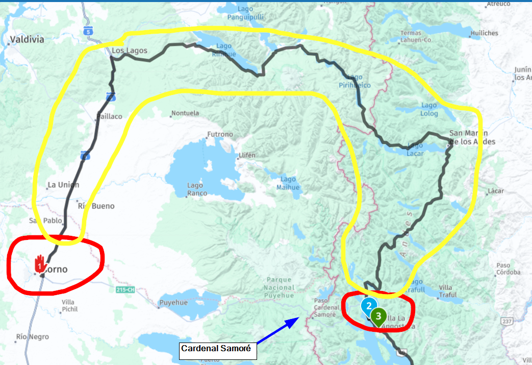

    Hello!
    I'm having trouble creating a direct route between two major cities. The route goes through a border crossing that is open, but the planner keeps sending me on a huge detour.
    It’s between the cities of Osorno (Chile) and Bariloche (Argentina), crossing at the Cardenal Samoré border. I used to be able to plan this route without any issues, but for some time now, it’s been impossible.
    Can anyone help?
    Thank you very much!

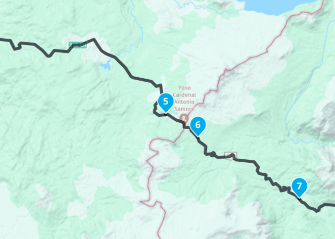

      @DAVID-PUEYO-TORRES
      Hi David,
      Can you place a link to that route here zso we can check it also?
      At first glance, it sounds like that you have selected the wrong transport modus and have the route optimization set to Fastest instead of shortest. But this can only be done when the map is set to HERE.
      Another thing which could causing the problem is seasonal closure. Turning it off will give you also another route compared to turning it on.
      Which map are you using?

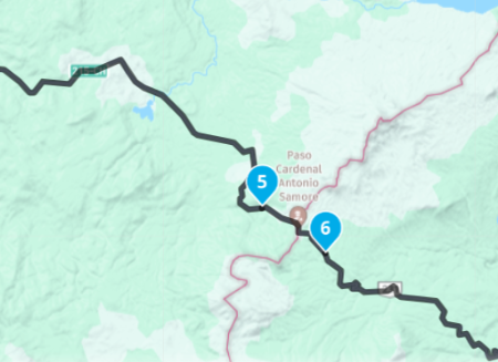

      I just made a route by myself, using HERE and set the route optimization to Shortest and the transport modus to Car.
      As you can see, waypoints 5 and 6 are passing the border without any issues (screenshot 1). Even removing some waypoints does have no effect (screenshot 2).
      So that is the reason why i asked you to place a link to that route of yours. Make sure top set it to public.
      Screenshot 1

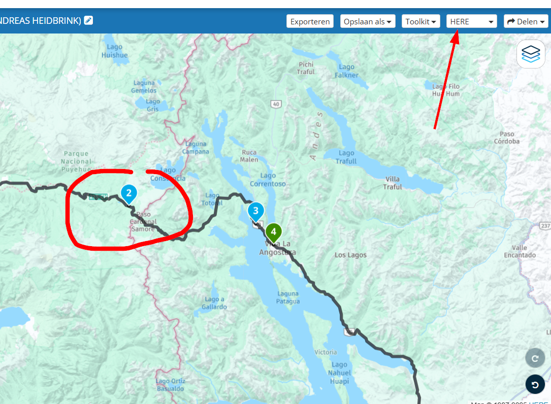

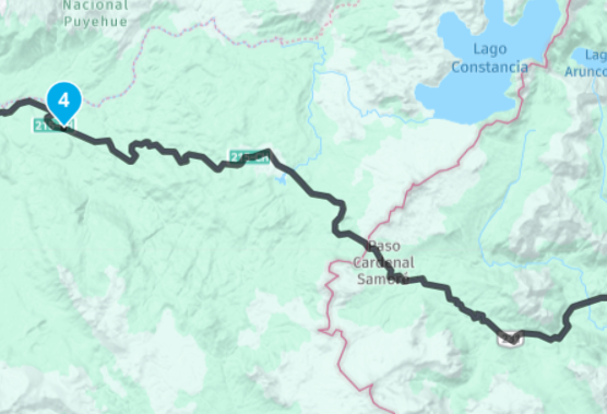

              This would be the problem.
              Between waypoints 1 and 2 there are no more waypoints. Best is to place some extra waypoints before/after the Cardenal Samoré pass so you pass the border at that point (yellow marked part of the route).
              Waypoint 2 is placed far beyond the Cardenal Samoré pass giving MRA the opportunity to come up with a route you don't like.
              As you can see in my screenshot(s) i placed a waypoint before and after the border at Cardenal Samoré. This forces MRA to pass the border at this location. You don't have to do it like this, but placing 1 waypoint before the border should do the trick. And also change the map from OpenStreetMap to HERE. That will fix this issue also.

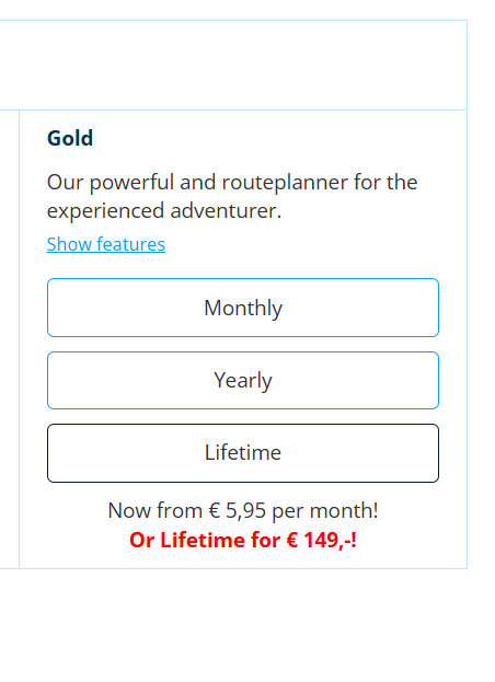

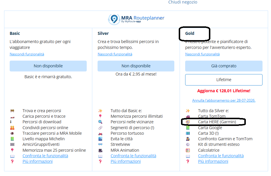

                      Do you have the Silver membership? Of so, then i understand this situation even better. With the Silver membership you don't have the HERE map. This comes with the Gold membership.
                      And why pay per month? You can also have a life-time membership. You only pay once and enjoy the rest of your life of MRA!
                      You get the Gold membership that comes with all the options and features of the Silver membership shipped with a lot of extra options and features!

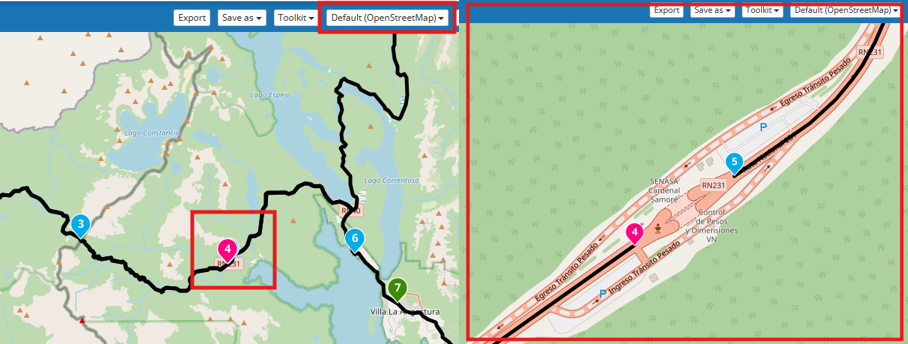

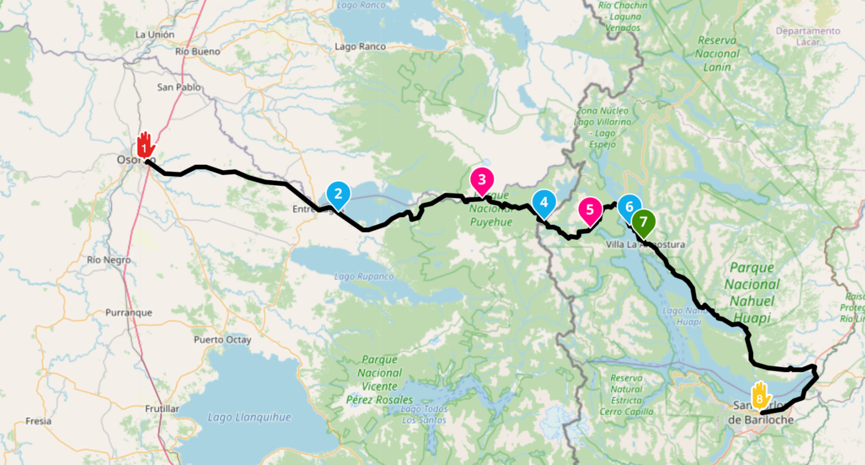

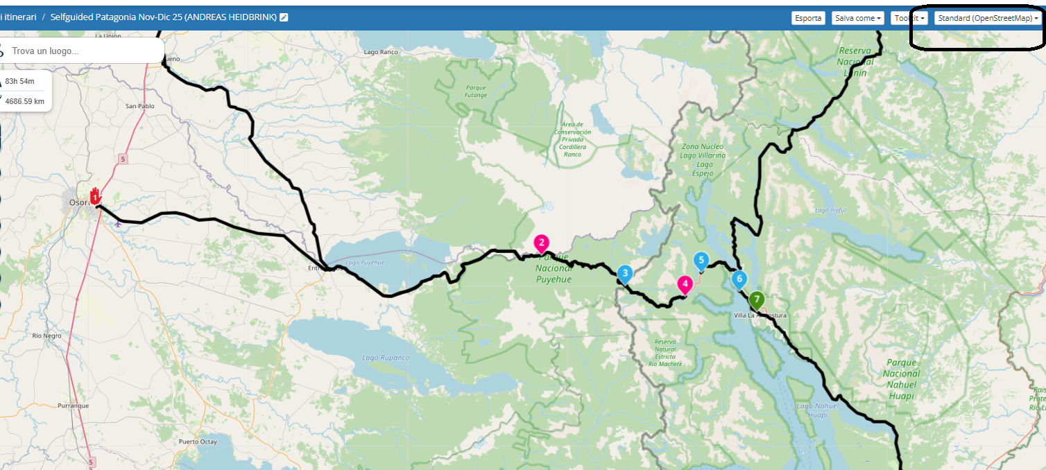

                        I actually tried it myself, just like Nomko said, and it works. With the OpenStreetMap map, even though you can see the road, it makes you take a huge detour, while with the Here map it follows the route you’d expect.
                        • Alex reds
                          Alex reds
                          Alex reds
                          wrote on last edited by Alex reds
                          map here
                          • Alex reds
                            Alex reds
                            Alex reds
                            Anyway, even if the planning shows that detour, once you reach point 4 you just continue on the road, and when you get to point 5 you’ll carry on toward point 6 without any effect on the rest of the route.

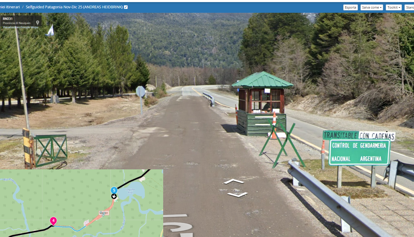

                              #14
                              Not sure about this one… can we actually pass through here?
                              • Rob Veerman
                                Rob Veerman
                                Rob Veerman
                                #15
                                Transitable con cadenas=passable with snow chains (depending on the time of the year, I suppose).

                                    I’m not sure if they’ve changed it, but as far as I can see, with the Silver plan you can’t use the Here map — only with the Gold plan or with the MRA Navigation app.

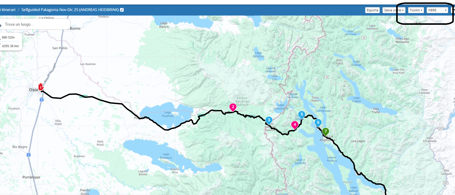

                                      @Nomko-Nomden not completely true. With a silver abo you for have the Here map but you can't compaire the route with TT and OSM
                                      Honda Goldwing GL1500,
                                      Honda Silverwing GL 650
                                      Garmin XT sold
                                        #19
                                        @Marinus-van-Deudekom said in Problem Routeplanner between 2 points:
                                        Not correct. A Silver subscription only gives you access to the planning map from OpenStreetMap.

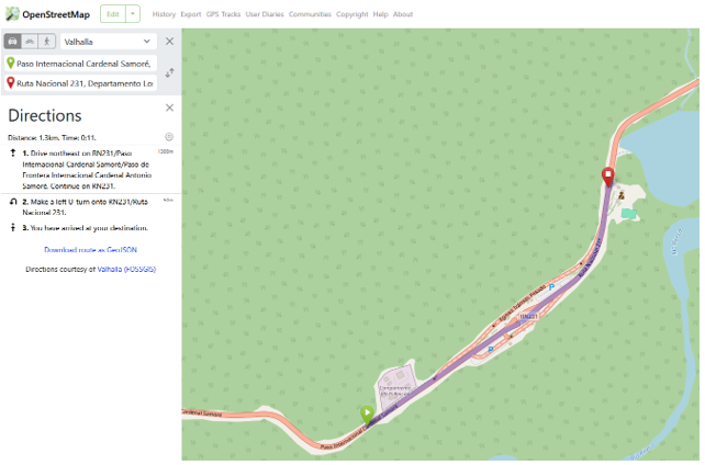

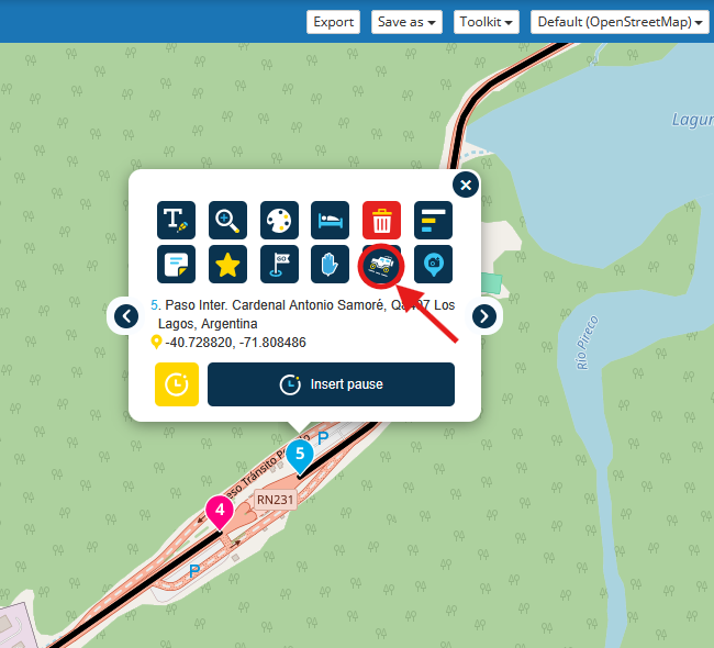

                                          Hi @DAVID-PUEYO-TORRES I don't think it is anything to do with subscriptions
                                          To me the problem appears to be with the MRA version of the OpenStreetMap map data
                                          On MRA using OpenStreetMap to calculate the route the path refuses to pass through the border post
                                          On the OpenStreetMap website the routing passes through the border post with no problem
                                          The normal way of getting around routing issues like this is to use the "offroad / skip" function,
                                          it is very often used to enable routes over rivers / ferry crossings
                                          add two points (4 & 5 ) similar to what I have shown either side of the border crossing
                                          then click point 5 & select the "offroad / skip" icon to route straight between 4&5
                                          MRA has their own version of the OpenStreetMap data & it is not always the same as that on the OSM site
                                          Its possible that the MRA version is out of date or that the snapshot that MRA took had some bad edits for the border post
