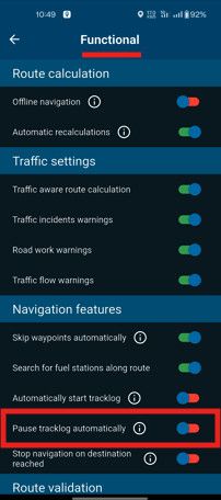

                  @Edwin_M this is just a wild guess but do you have the function "Pause tracklog automatically" enabled?
                  It can be found in "Settings > Navigation Settings > Functional"
                  the guess is that somehow the "pause" is being activated & then never re-activated or it is somehow interfering with the completion of the log
                  like I say, just a wild guess but might help if the state of this setting was known

                    The setting is on. Today the tracklog was also good πŸ€”

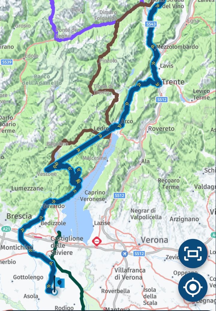

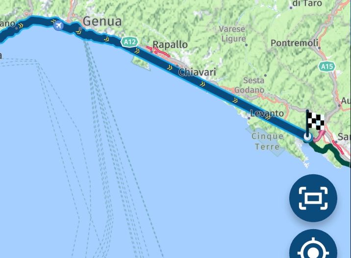

                        @Edwin_M Have you given the app permission to Always use your location? Your screenshot suggests you haven’t. If you are using AndroidAuto or CarPlay and the phone screen turns off, without Always use location the tracklogs will show straight lines.

                          @Nick-Carthew yes, yesterday was fine, today again a miss

                            @Edwin_M Something is stopping your location from being registered, this is why you see the straight line.
