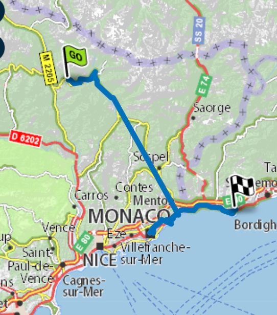

                        @Edwin_M Have you given the app permission to Always use your location? Your screenshot suggests you haven’t. If you are using AndroidAuto or CarPlay and the phone screen turns off, without Always use location the tracklogs will show straight lines.

                            @Edwin_M Something is stopping your location from being registered, this is why you see the straight line.
