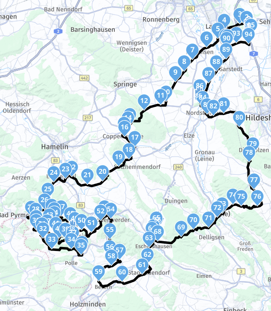

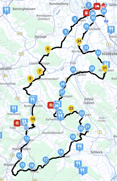

            Lets take those two routes as example.
            Route1: 272,68km, 5 Via points (including start and end), 91 shaping points.
            -> Loads about 2-3 seconds when opening in app
            Image: clickme
            Route2: 250.57km, 5 Via points (including start and end), 35 shaping points.
            -> Loads about 15 seconds when opening in app
            Image: clickme
            Both routes go into the same direction.
