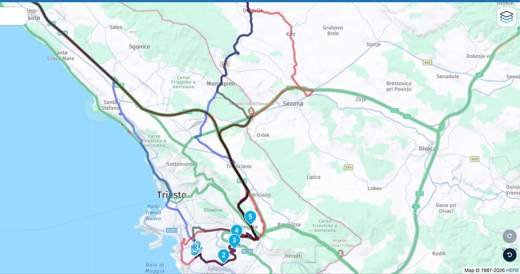

                    hi @gianluca-0
                    this looks like a very nice route, albeit very long for single route.
                    as a small example I looked at the Trieste area of your map and if you look at the screen shot you will observe the many different routes available with Here, OSM and Tom Tom,
                    when I plan a long route I always use the compare tool to see of there are any other possible ways I could be routed. I would then add more shaping points to force the route to the way I want, some will say this is excessive, but it works for me and I very rarely if at all stray from my original planned route, except for the dreaded umleitung of course.

                      • paul69 paul69
                        hi @gianluca-0

                            Well, raeading your precious indications, I have replicated the issue and understand why it happened.
                            The track was made with Tomtom map and reading it with MRA navigator gave this crazy result.
                            Many of you understood the snag.
                            Thank you all a lot, my next trip (last August week, about 2500 km in Romania) will be smooth ! I'll cut it in daily tracks of 3/400 km and use the correct map to plan !
