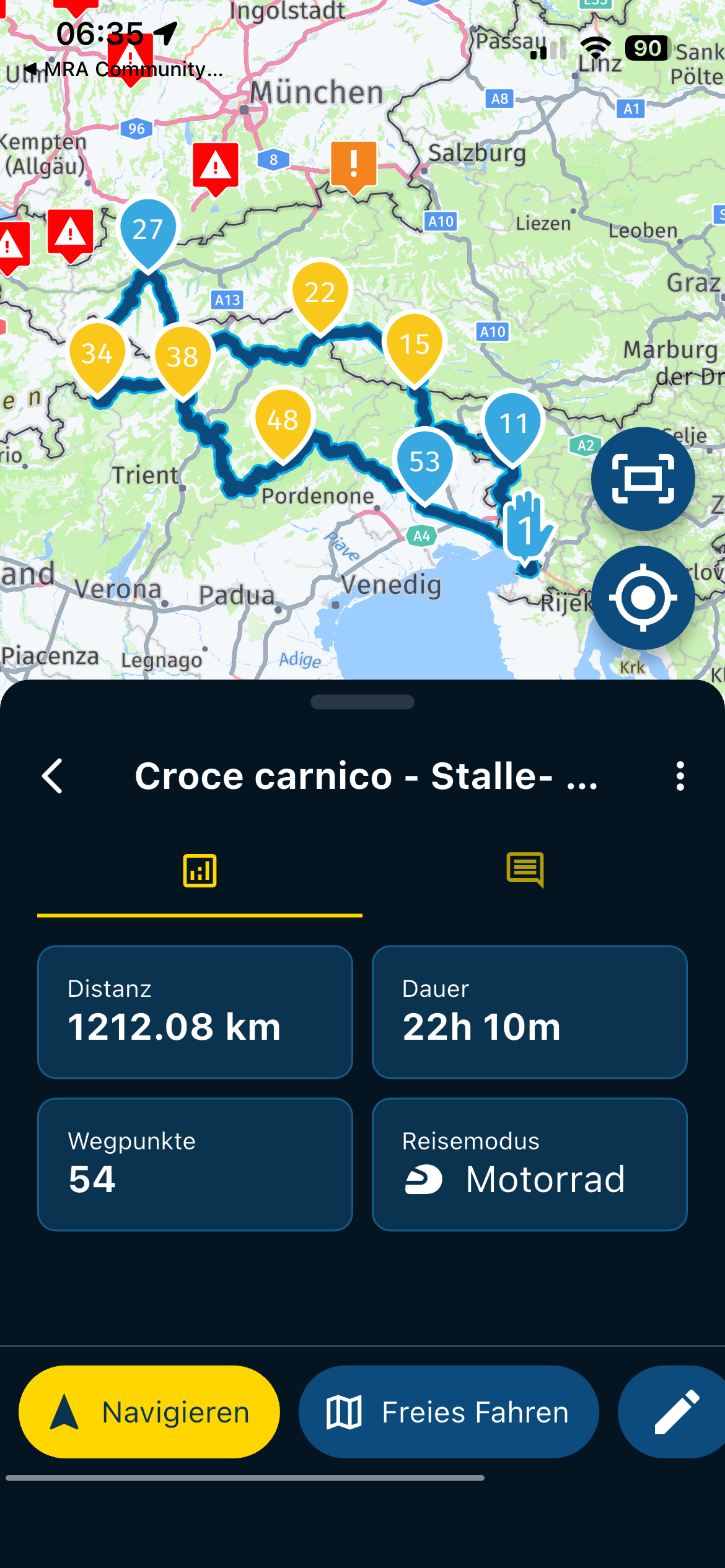

          The route is public and is this:
          https://www.myrouteapp.com/it/social/route/13852451?mode=share

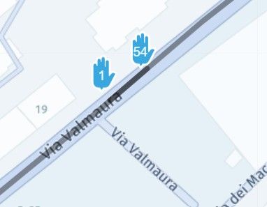

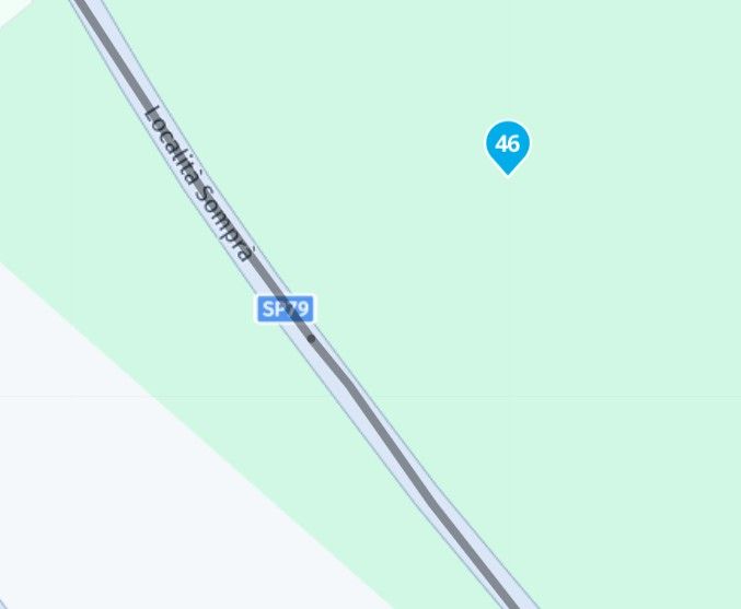

                  Do you use the free version of MRA or the gold version?? When using the free version you only have access to the OSM card. When i lock at you're route lots of waypoints are not placed on the road but next to the road or even further. When planning check you're waypoint if they are placed correct. Don't put you're start and finish point so close together. Put you're starting point further up the road so you ride to you're starting point and the gps makes no mistakes in seeing the wrong point or missing it and keeps sending you back.

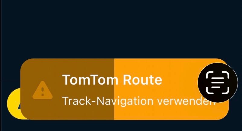

                    The route is planned in TomTom algorithms, the window s. Image comes when starting the navigation on my mobile phone, so it leads to the fact that it is actively navigated as a route track, traffic data is also missing.
                    Please switch to Here algorithm, then it will be navigated correctly.
                    And please do not let the route navigate over such a long distance, divide it into 3-4 sections.
                    From experience, I would basically divide such a long route. I think on 3-4 sections especially in the mountains 300km a day is enough.
                    • In my planning, the routes at 300km have approx. 50 -70 waypoints (WP) or Sharping Point (SP)
                    • It helps to always set a point safely in the direction of travel at certain turns
                    • Check WP on the Here map, should always be on a road !!
