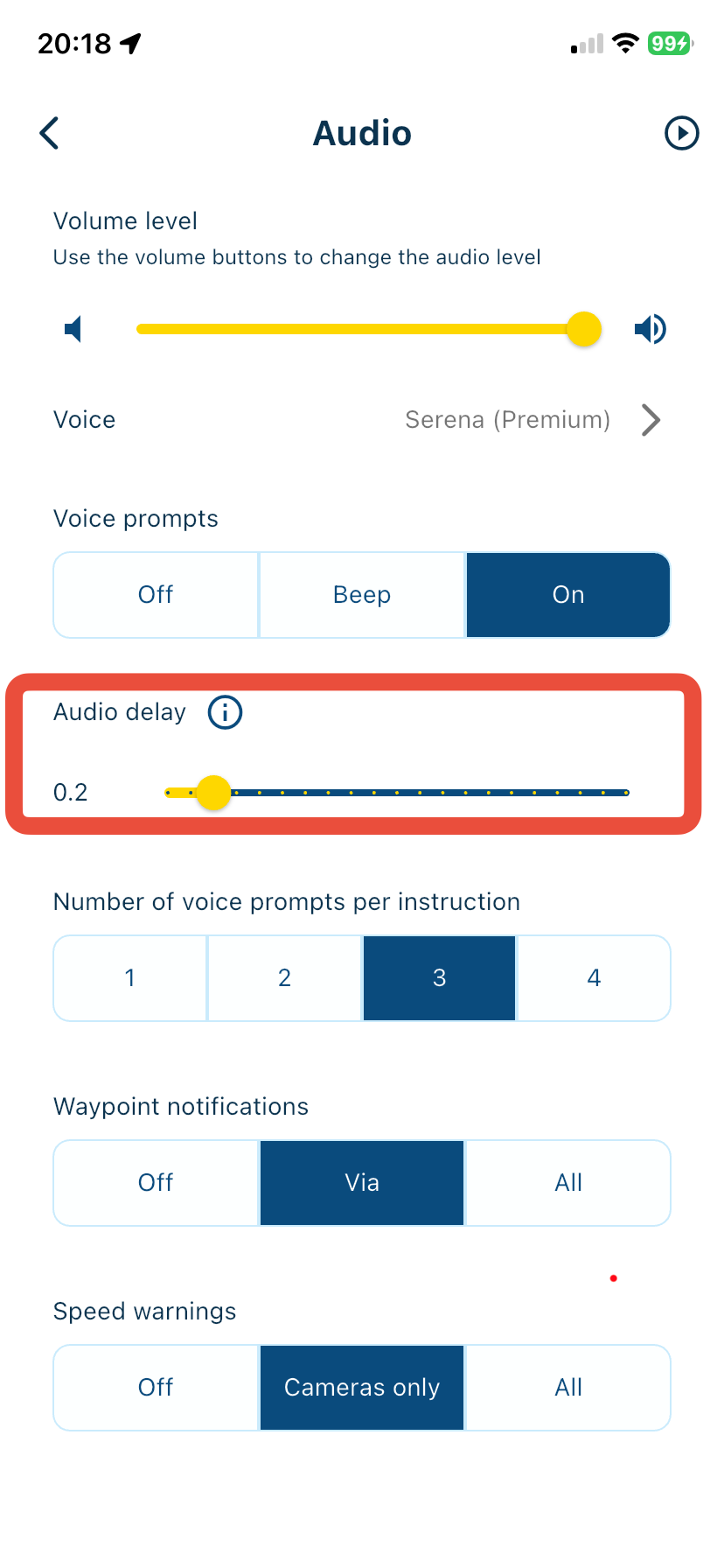

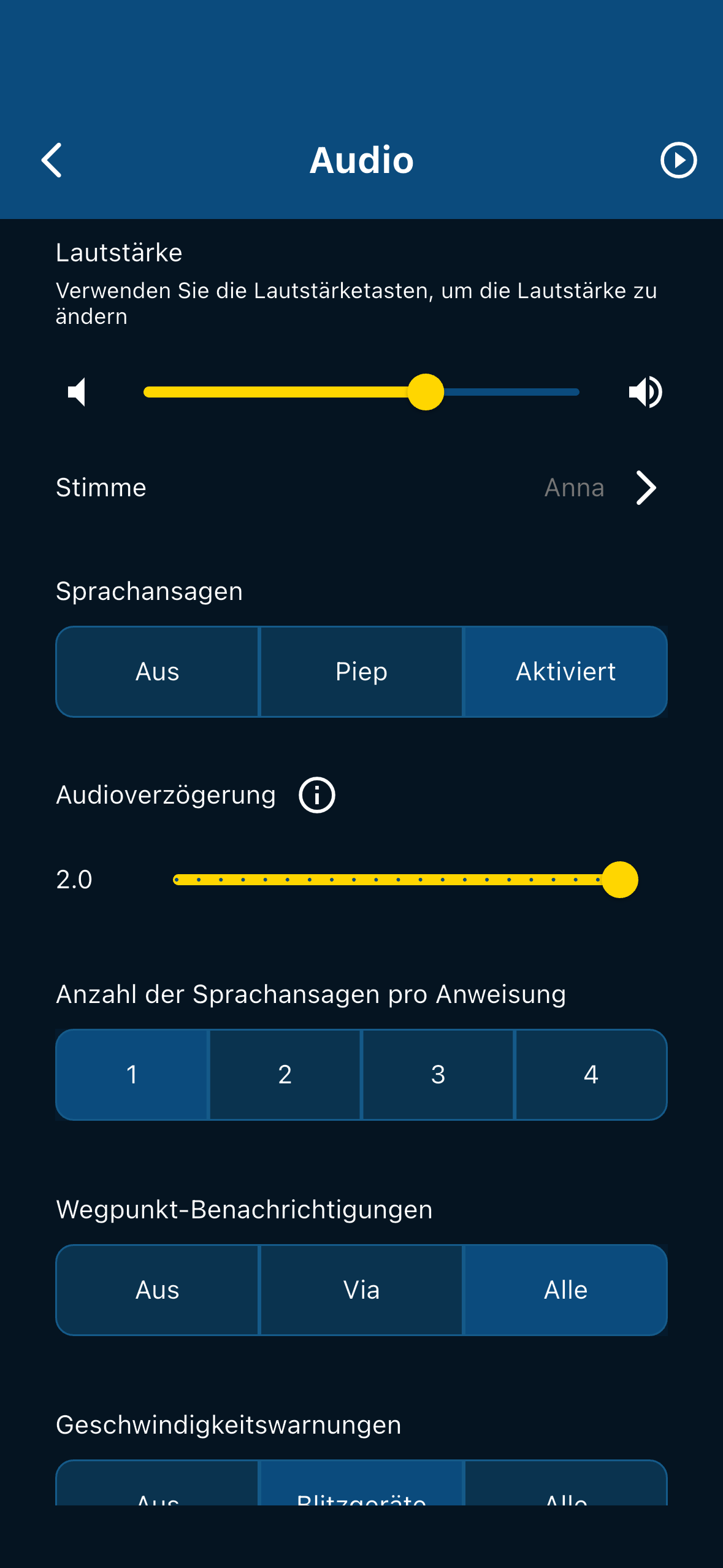

                            Hi Hubert, the slider has absolutely no effect, neither on iPhone nor on iPad.
