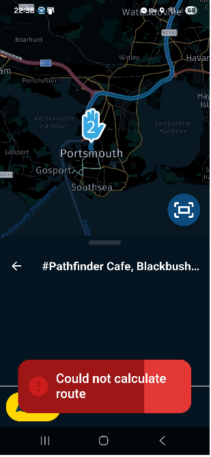

    Steps to reproduce:
    • Open the app
    • Select MRA RoutePlanner
    • Select Search icon
    • Select Favourites
    • Select a favourite
    • Select 'Add to route' (to add as point 1)
    • Select Favourites
    • Select a another favourite (different to the first one)
    • Select 'Add to route' (to add as point 2)
    A route is calculated at this point and shown on the map.
    • Scroll down and select Navigate
    The error message is displayed and Navigation does not start:
    If you go back to 'Route information', enter a route name and save it, Navigation can then start OK. It seems as though a route must have a name before Navigation can start. If that is by design, then a better message would be helpful.
    Regards
    Andy

                      @Andy-W Thanks for creating the ticket, I've read it.
                      I will fix the issue πŸ˜‰
                      It seems to be caused by the fact that you have enabled the "navigate routes as track" option. Try turning this off and retry your steps.
                      Working on a solution now πŸ™‚

                        @Corjan-Meijerink said in Error message 'Could not calculate route' when one is shown on the map #bug:
                        @Corjan-Meijerink Thanks for the update. I've turned off the "navigate routes as track" option and it works OK.

                          @Andy-W Thanks for confirming πŸ˜ƒ
                          From my side I can let you know that the issue is fixed.
                          So when the next update is available, this will work even when "navigate routes as track" is enabled.
