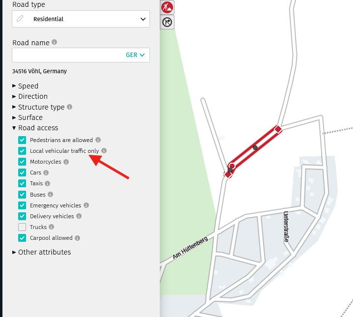

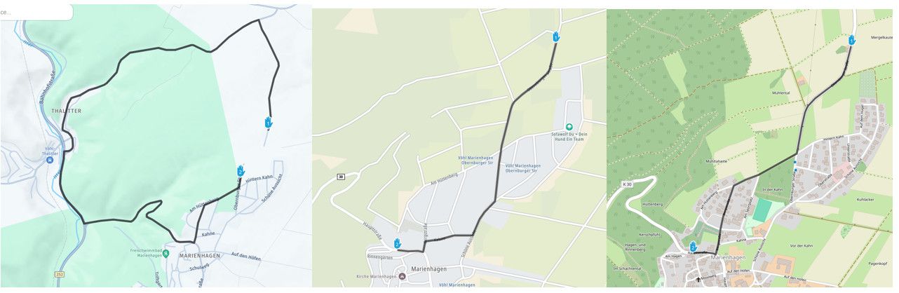

            @BertM the first picture is MRA just using the 3 different routing calculators, Here, TomTom & OSM
            by moving the 2 points closer together I was able to isolate / narrow down where the Here card was failing
            then looking on the Here Map Creator site I was able to find the local access restriction
            the reason that the route is working for you in one direction & not the other is you were lucky / unlucky that you have placed point 33 exactly on the restricted road so the routing passes through
            if you move point 22 so it is next to point 33 then the route will pass both ways
