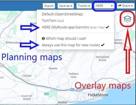

                      @David-38 You are planning your route using the planning map from OpenStreetMap (OSM). Use the planning map from HERE as this is the map that the app uses.
                      David 38 1 Reply Last reply

                        @Nick-CartheSow
                        So I need a Gold level subscription of the web planner to use the MRA app ?
                        Wish I'd known that BEFORE subscribing to MRP app.

                            wrote last edited by
                            #14
                            @David-38 said:
                            @Nick-CartheSow
                            No, if you look next to the word Gold it also says Nav. An MRA Navigation Next subscription gives you access to the planning map from HERE, check it for yourself.

                              #15
                              @Nick-Carthew
                              Thanks for that information ! I selected the HERE map on the web site, synced the route, and ran a test of the app.
                              Looks like I'm being directed to my Via points as I want !
                              Thanks everyone for your help and patience with an app newbie.
