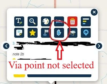

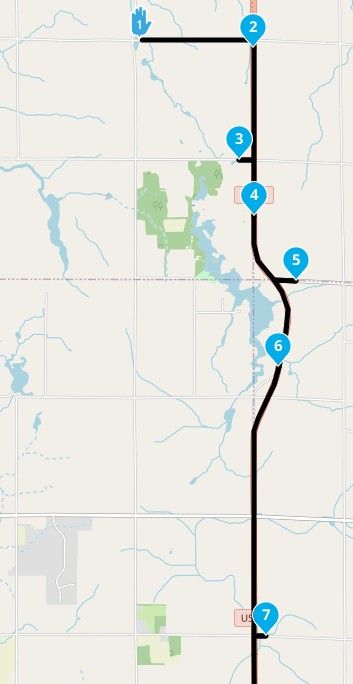

          Here is a picture of my route. I purposefully put via points 3,5, and 7 on the route just to test being re-routed to them after passing them. Does the fact that they are somewhat close to the 'main route' contribute to them getting skipped ?

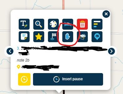

          And here is and example showing 3 is a via point
          Is it possible that the points are not being stored as Via points ? I'm using the free Basic MRA web site account to create routes. Is there something I could be looking for by creating a GPX file of the route and view the XML tags ?

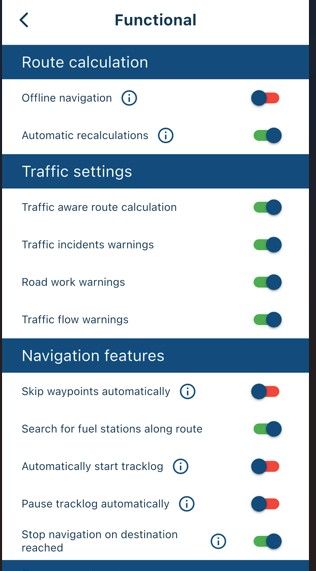

          Here are the settings I've got in the MRA app:

            @David-38 Jus to be clear, 3 is not a via point as can be clearly seen on your screenshot of the map. The route point menu screenshot that you shared shows how to select a via point, if the via point is selected the icon would show a shaping point.
            • Marinus van Deudekom
              wrote last edited by
              That 3,5 and 7 are being skipped automatically is exactly how it is supposed to be
