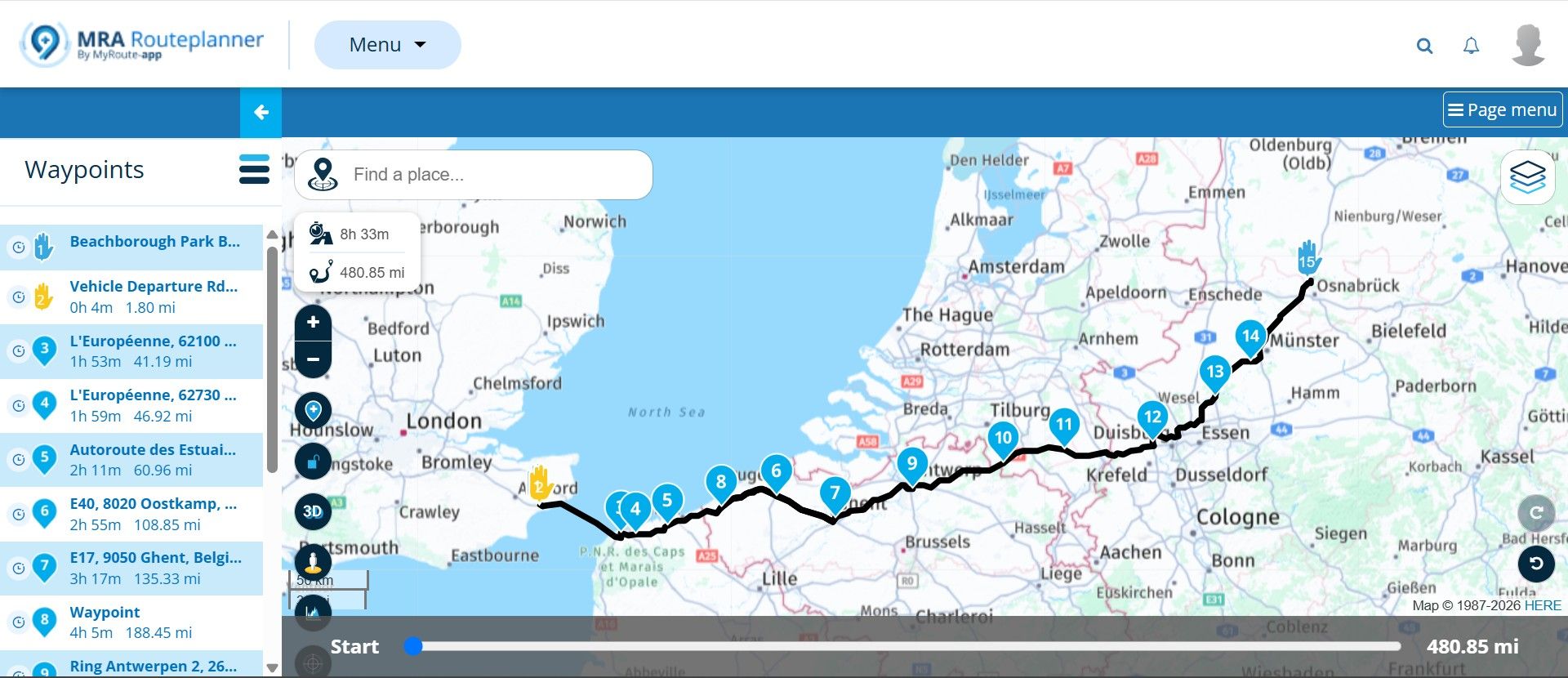

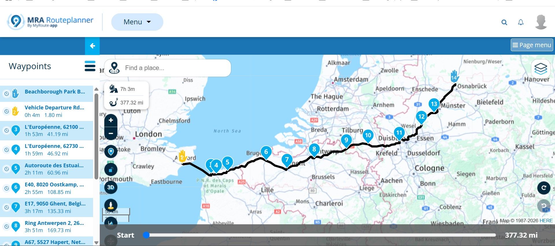

          OK. So here's my original route, (377.32 miles) I hope it's public
          https://www.myrouteapp.com/route/open/13569227
          When I use expand to add just one more point (15, up from 14) it becomes 480.85 miles and point 8 has been added between poins 5 and 6, both of which are on the correct side of the road.

                    Absolutely not. This is my original 14 point route

                      The new point number 8 can be identified as an MRA expand point because it's labelled "waypoint" the ones I manually placed have road numbers

                            #21
                            Hi @marinus-van-deudekom
                            Thanks for your comments. The screenshot you show is from the expanded route. This is my original 14 point, 377.32 mile route. In a moment I'll expand it in MRA and screenshot it again (MRA makes the changes in realtime and I don't know how to save versions of the original and expanded route)

                              #22
                              This is the expanded version. Please note the location of the new waypoint 8 and it's description.
