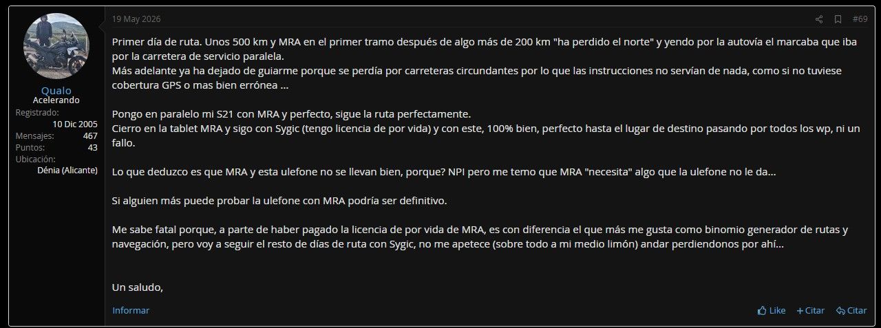

                          @Thomas-Neumeyer On a Spanish BMW forum, there is another member with problems with Ulefone and MRA.

                                        #70
                                        @Thomas-Neumeyer
                                        Hola Thomas
                                        Es exactamente el mismo problema. Pasadas una 2 / 3 horas la pantalla se congela y no recibo instrucciones, y el reinicio de la app no soluciona nada. Otras apps funcionan perfectamente.
                                        Ulefone me indica si quiero devolverla o si quiero enviarles el report de uso para ver que ocurre, pero esto último me han enviado instrucciones a medias y creo que la devolveré y listo, no quiero perder mas tiempo.
                                        Hi Thomas
                                        It's exactly the same problem. After 2 or 3 hours, the screen freezes and I don't receive any instructions, and restarting the app doesn't fix anything. Other apps work perfectly. Ulefone is asking if I want to return it or send them a usage report to see what's happening, but they only sent me half-baked instructions for the latter, and I think I'll just return it and be done with it; I don't want to waste any more time.
