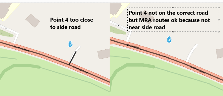

                Examples below show how mini diversions can easily occur ( I have just played with point 4 in your route)
                Different navigation systems have different tolerances to what they consider a reasonable placement error.
                I have found MRA navigation is very tolerant to misplacement of points off the intended road, a Garmin XT however a lot less tolerant
                All navigations systems will have a problem if points are placed near side roads, they have no idea if you wish to take the side road or not
