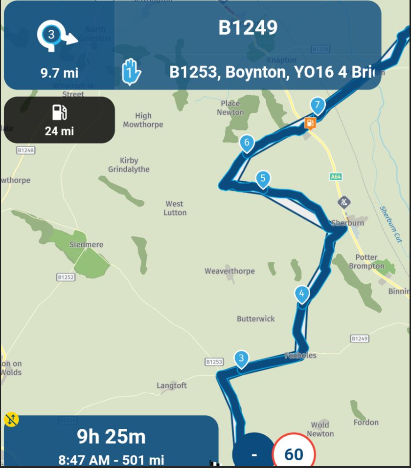

    When I load some routes for navigation the display of the "original route" beneath the planned navigation route does not conform closely to the road, it appears to straight line between some unidentifiable points
    On other routes it fits very close to the road & can only be seen to deviate a small bit when the navigation app is zoomed in to its maximum setting
    All the routes are planned with MRA on the PC & then navigated offline with MRA Navigation.
    Some routes may then be edited in the app
    Could someone please explain why with some of my routes the display of the "original route" differs?
    & while on the subject of the "original route" could the colour be changed from white to a much more contrasting colour?
    on a bright sunny day with a washed out garmin map style selected the white "original route" is virtually impossible to see
    (yes I know there are other map styles but occasionally for whatever reason my style reverts to the washed out bland garmin default colouring"

      sometimes the offset from the road for the "original route" (track) can be large
      when this happens & zoomed in at a junction the "original route" (track) can sometimes overlay the entire junction so the exit roads from the junction are hidden/obscured by the overlay
      This imo is borderline dangerous as instead of concentrating on the dangers of navigating the junction I am busy trying to guess which exit road from the junction the navigation system is telling me I need to take

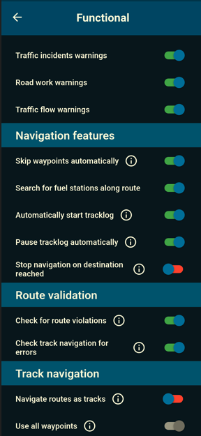

            @Brian-McG, I see you are using offline-mode. I suspect you have "Navigate Routes as Tracks" enabled. Tracks work best in online mode, because tracks van only be calculated online. If offline, you get a less optimal track. If offline use is a must for you, you would better disable "Route as Track".

              @Con-Hennekens nope, not navigating tracks & option is always disabled

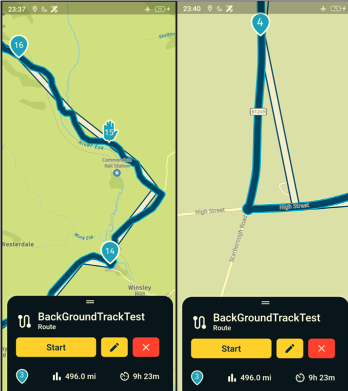

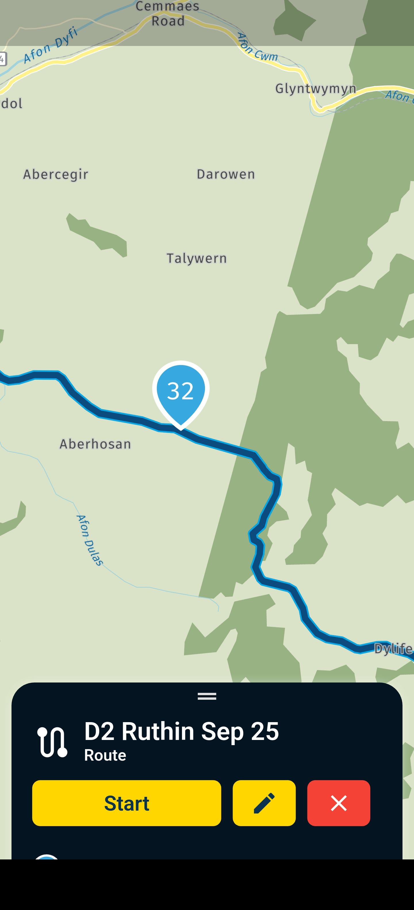

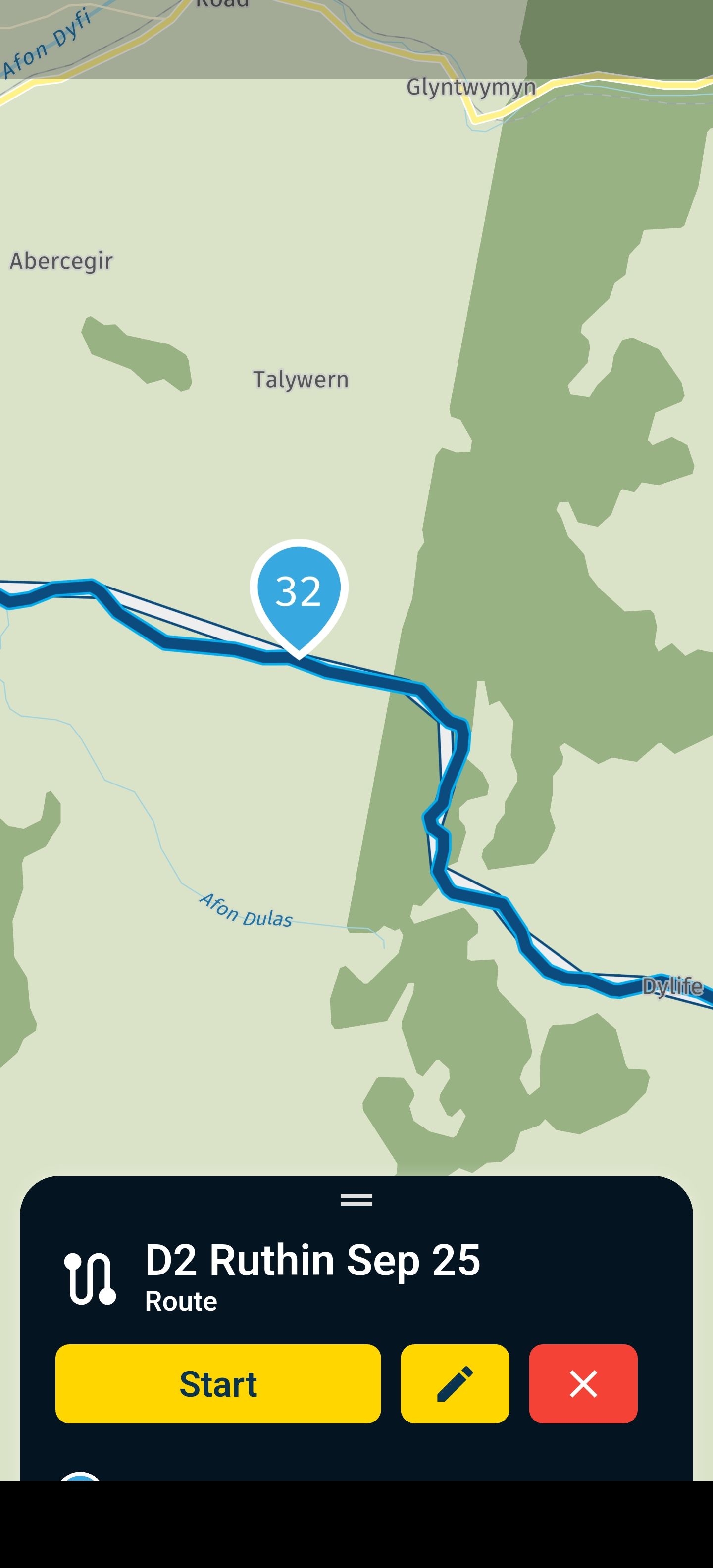

                If I edit a route in the web planner or via the app website route lab link - when I try to navigate this route offline the "original route" (track) displayed in the navigation will as you say not be ""optimal"
                In fact they can be far from it. In the second picture the right turn at the roundabout with the track disappearing off a couple of hundred metres before is the same roundabout shown in my first post which shows very small calculation errors, in this example the track error is huge.

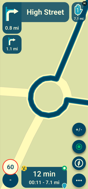

                What I have found is that if I take a route that has been created on the web planner & then edit it within the app route planner I get a different & what appears to be optimal "original route" (track)
                Yes this is the same round about as in the above posts but with the "original route" (track) completley hidden because it is perfectly matched to the route/road
                So my questions are why did you think the "original route" (track) in offline mode would be "less optimal"?
                & why is it that when the route is edited in the app planner it appears to calculate the optimal "original route" (track)?
                my guess is that there is some tiny difference between the Here online map & the downloaded offline map -
                this small difference upsets/causes a glitch in the calculation of the "original route" (track) such that it uses less points (sometimes a lot less points) to calculate the "original route" (track)

                        @Corjan-Meijerink sorry the divergences of the "original route" are sometimes not minor, they are major, hundreds of metres, plus the issue is the system is not consistent
                        if the original route can fit to the road correctly after the route is edited in the app route planner,
                        why does it not fit correctly when the last edit is done on the web planner?

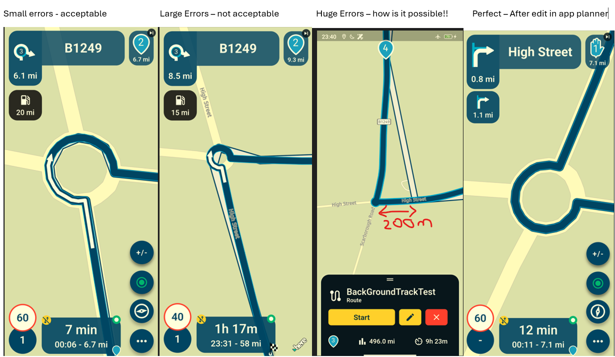

                            @Con-Hennekens yes that is what I am saying, it would be nice if someone could replicate 😜
                            I am seeing the error in offline navigation
                            the route is edited in web planner - then synced to the device
                            the device is taken offline (airplane mode or wifi/network off)
                            the route is opened & navigation started with original route displayed
                            sometimes the web planned route appears ok with small errors as @Corjan-Meijerink expects
                            other times it can have larger errors & occasionally very huge errors
                            if I edit the web planned route in the app planner it seems to fit perfectly
                            I can understand the idea of trying to save storage, reduce data & speed up transfer
                            if the errors were always small then I would say - not a problem
                            when the error is large the original track line can obscure whole junctions & makes it difficult to read the map
                            for me the problem is the original route is not displayed consistently
                            I don't think a long term solution is to re-edit every route every time it is transferred/synced to the app
                            oh & don't forget the lack of contrast with a white original track
                            on the default garmin style map with this bug you can see nothing of the roads
                            BlackView BV7100, Android 12

                              @Brian-McG, This is a good find. Thanks for your elaborate explanation. I will try to replicate this behavior.

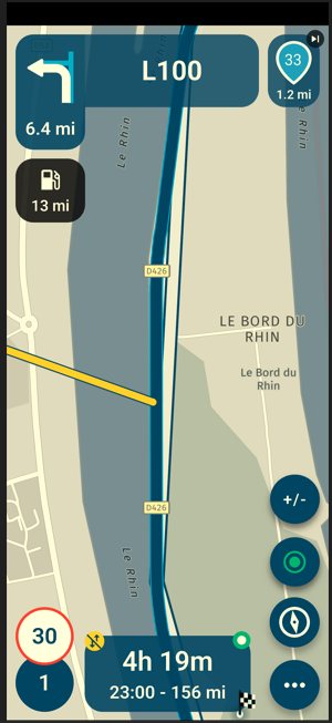

                                Sometimes the errors with the "original track" can be huge,
                                with the above route the "original route" is wrong by hundreds & hundreds of metres
                                what causes the wrong calculation of the "original route" in offline mode?
                                I have also noticed that with a route created in the web planner,
                                if the navigation is started with a network connection, the "original route" will fit perfectly to the road
                                the same as when the route is edited in the app planner, you get a perfect fit
                                I only seem to get the bad fit of the "original route" when I start the navigation in offline mode

                                  @Brian-McG, Tried to replicate this some days ago, but did not succeed... Although I have seen these straight lines before too, I was not able to replicate it in any circumstance you described. I was surprised by that and don't understand why. Old routes, new routes, offline, online, changed in the webplanner, I could not get the straight lines to appear. I'll try again later, probably after the holiday season.

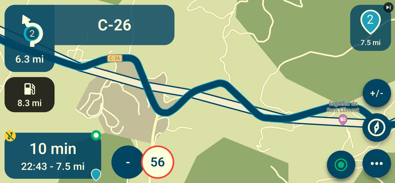

                                    I've seen the same behavior during my 8 days trip in the Eiffel 2 weeks ago. It was clear to see it when driving hair pins.
                                    I was driving offline
