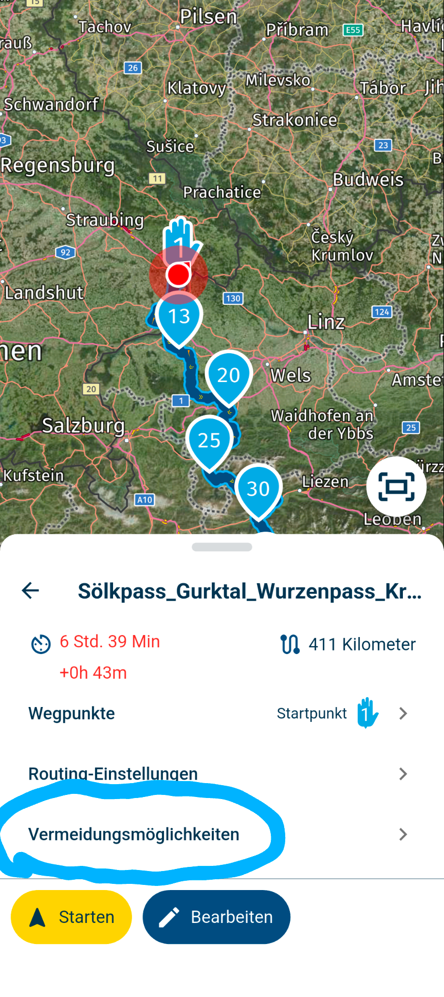

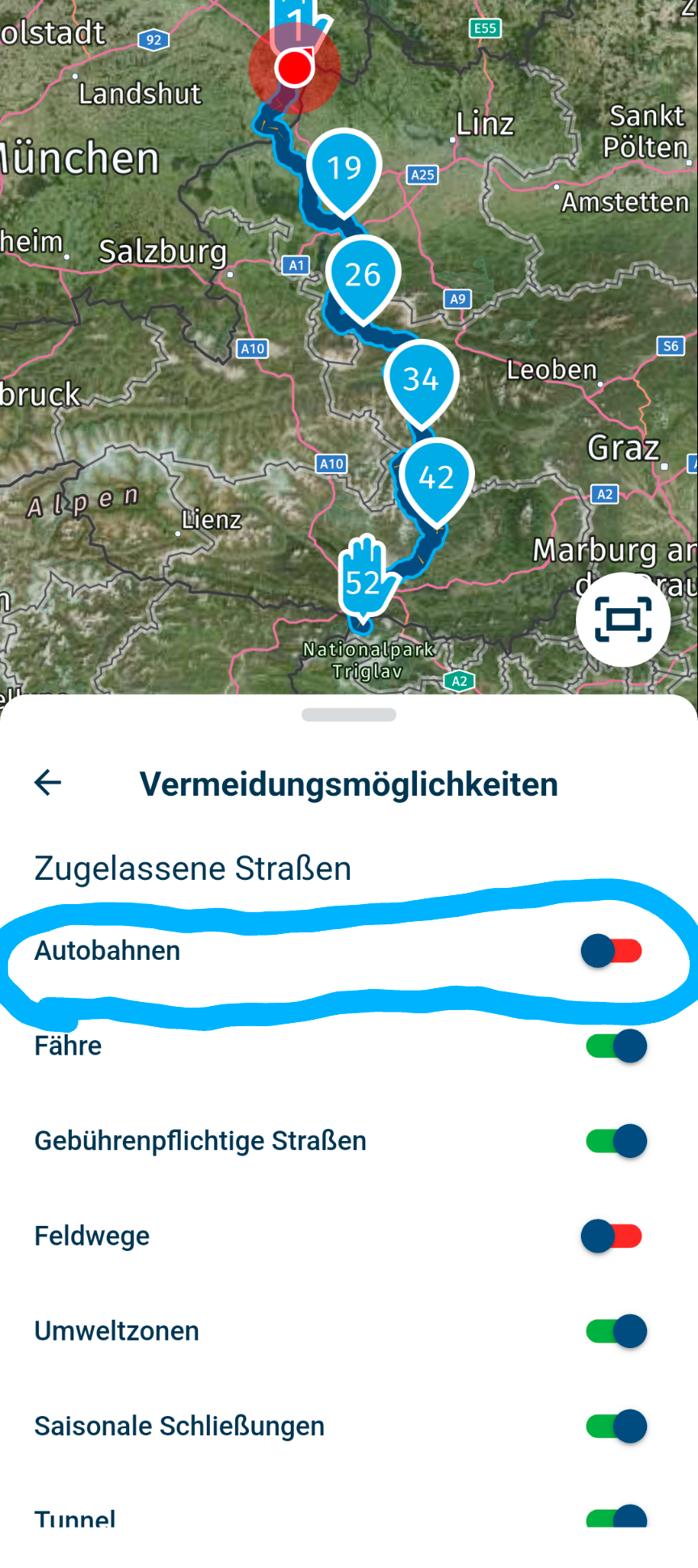

            Peter Zehentreiter Offline
            Peter Zehentreiter
            wrote last edited by Peter Zehentreiter
            @Aggelos-Minoudis Where do you want to turn off “Avoid Highways”?
            In the app or in the web planner?
            Here's how it works in the app:
            Open a route.
            Tap “Navigate” (do not tap “Start”).
            Then tap “Avoidance Options,” where you can enable or disable various options.
            Once you've made your selection, tap “Start” to begin navigation.

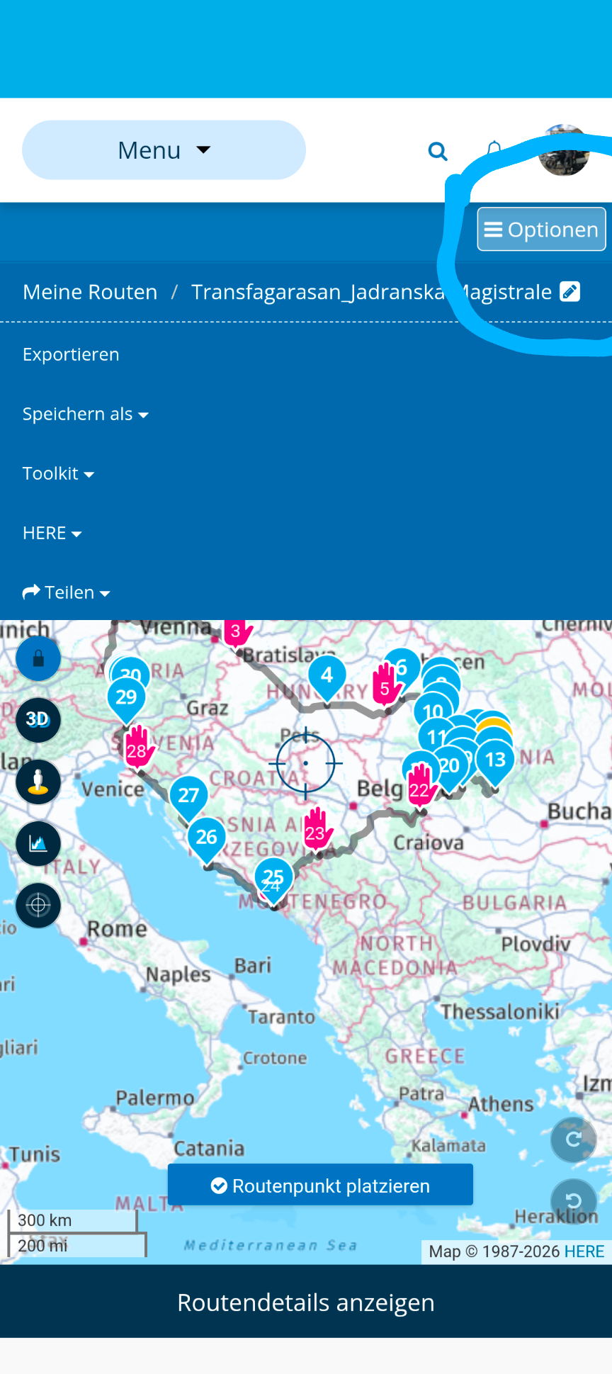

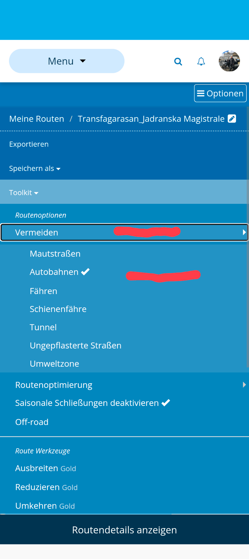

            In the Web Planner, follow these steps.
            Open your route
            Go to Options
            Go to Toolkit > Avoidances
            Check the box next to the avoidances of your choice
