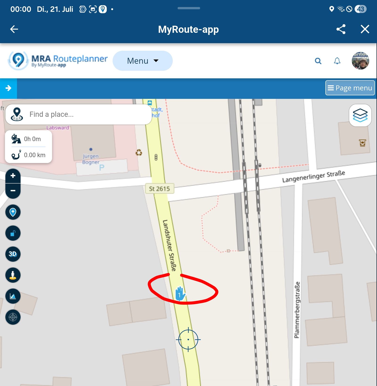

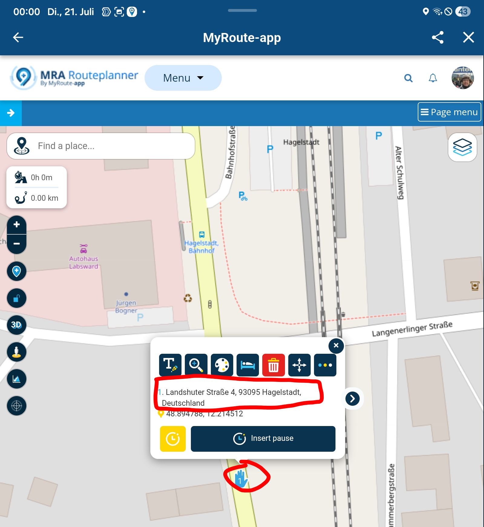

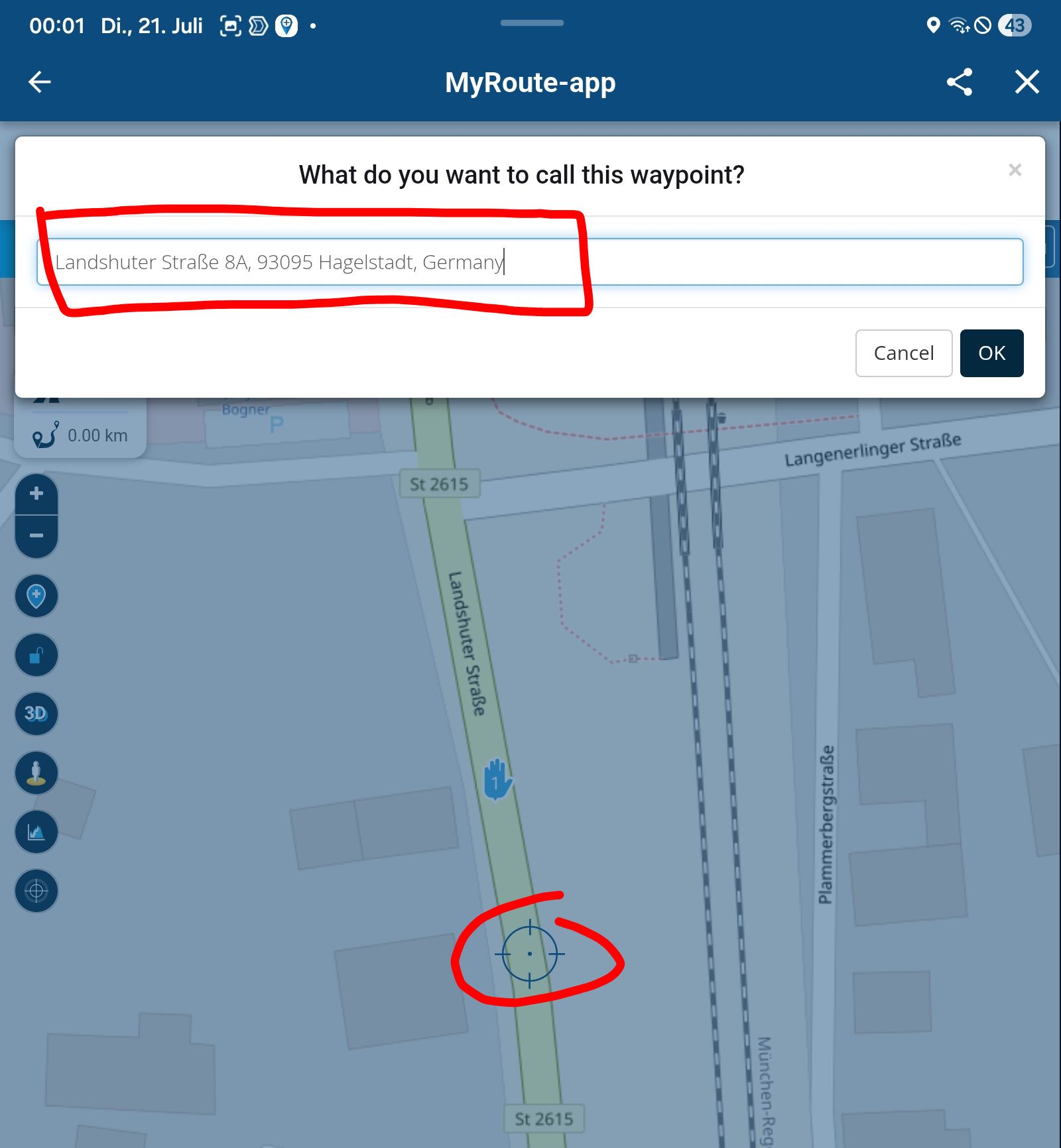

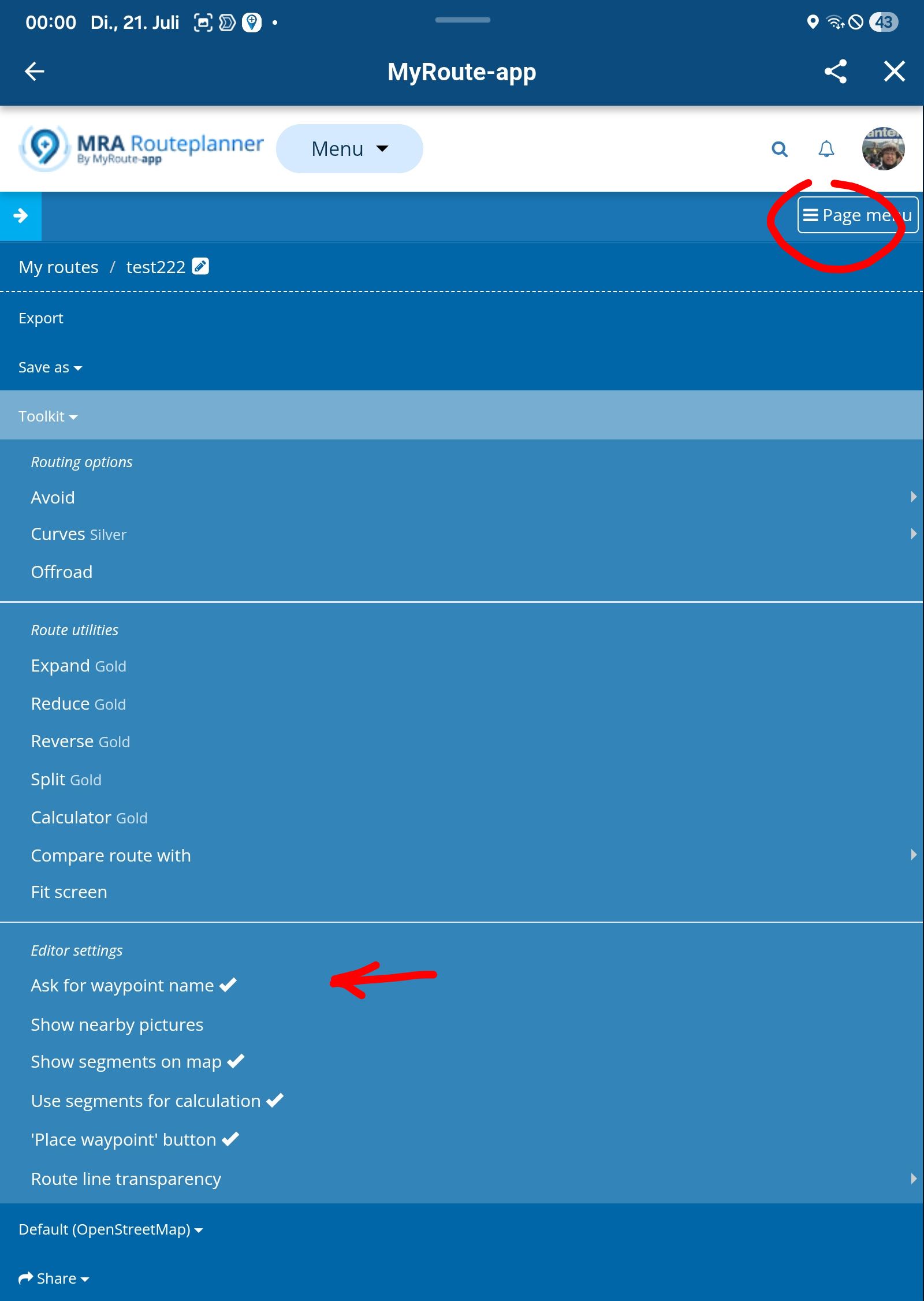

                                  #29
                                  @Lenny-O I think he's referring to the editor settings in the toolkit on the website.
                                  There's an option there......Ask for the route point name.
                                  If you enable this option, when you place the waypoint, you can choose whether to keep the default name, assign a name of your choice, or delete everything right away.
                                  LennyO 1 Reply Last reply

                                    #30
                                    @Peter-Zehentreiter With that option if you just highlite the address and Delete it, it goes into a stupor...
                                    Seems like you have to actually hit the space bar at least once for it to take the empty address / name.
