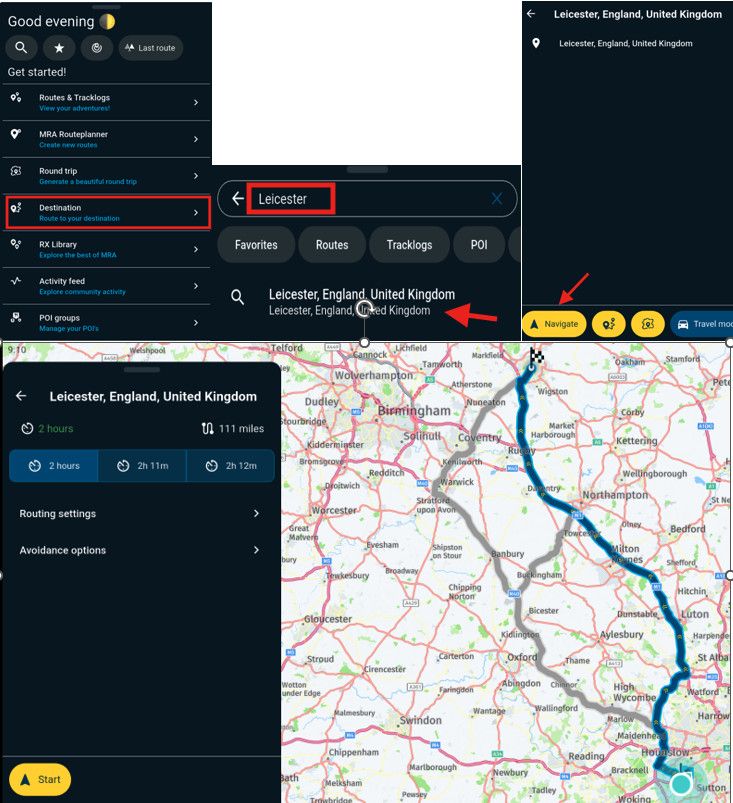

              @Mark-Williams-5-0 I think we may be talking at cross purposes or different things as this is not adding up at all correctly for me & does not match what I see when I "enter a destination". You say.....
              When I enter a destination on the MRA Android app and select the allow Highways option
              For me this means a simple A > B route from your location to a destination
              To do this I would select "Destination" from the route options draw,
              Search for & then select my destination, followed by pressing the Navigate button & my route options would be shown
              As you can see when select Leicester as my destination from west London it definitely allows me to use motorways / highways as it gives me the choice of routing via the M1 or M40
              Under "Avoidance options" the "Highways" button is the default green as an allowed road
              I think to help further you will need to explain your steps a bit more fully
