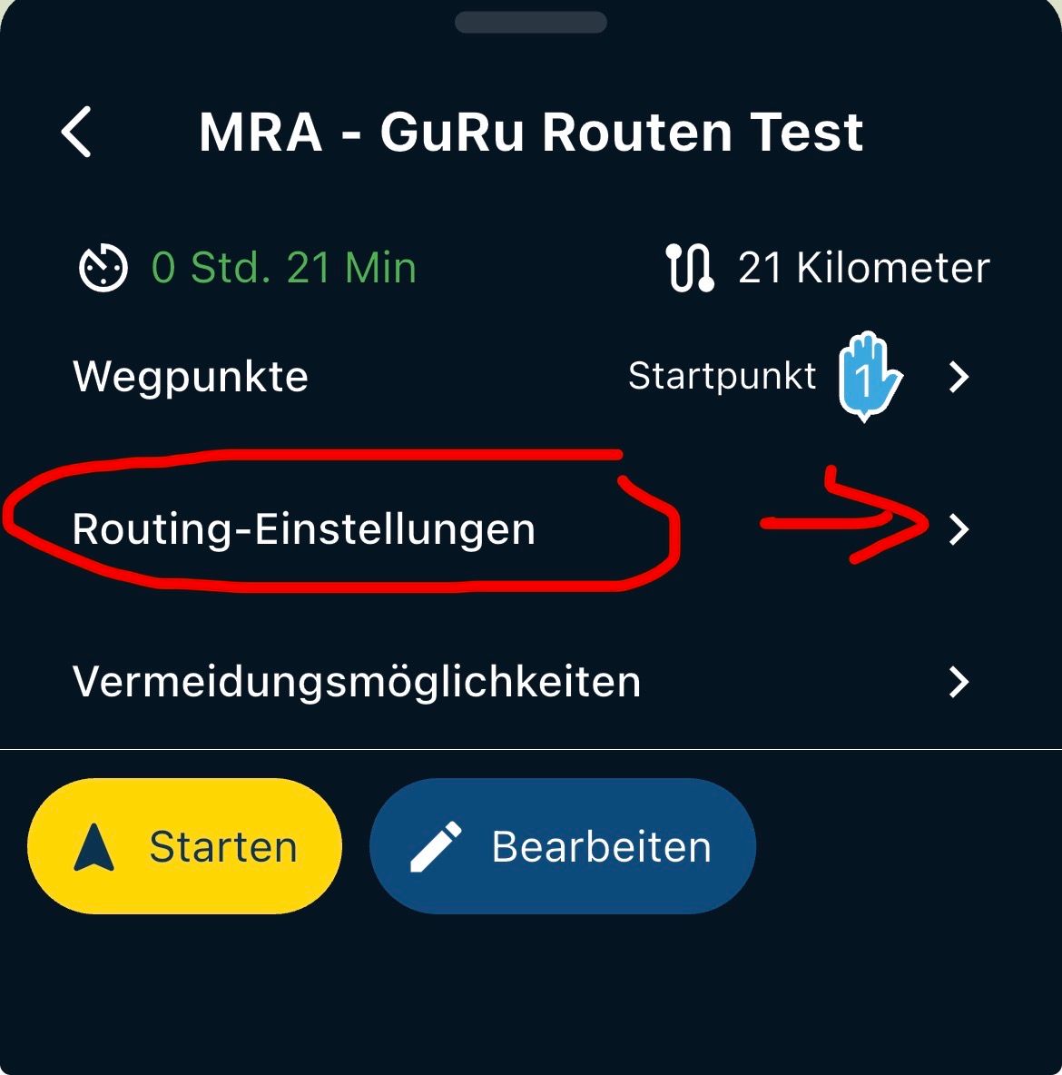

        @montorsi-paolo-0 You also have the option to configure the navigation app so that, after a pause, it starts at the nearest waypoint relative to your starting point.
        Select the route and tap "Navigate," then choose "Routing Settings" from the menu and enable the "Start at nearest waypoint" option.
        Good luck with that!
          What Nick wrote works too, of course—and it’s always visible on the map display at any time. ...

                      @Hubert-Thoring
                      The "Start at nearest waypoint" was already selected but the option "Use the actual position" it wasn't. Maybe this was the problem.
                      By the way, following your advice, I found also that is possible select the starting point by choosing a waypoint. My bad.
                      Thanks
