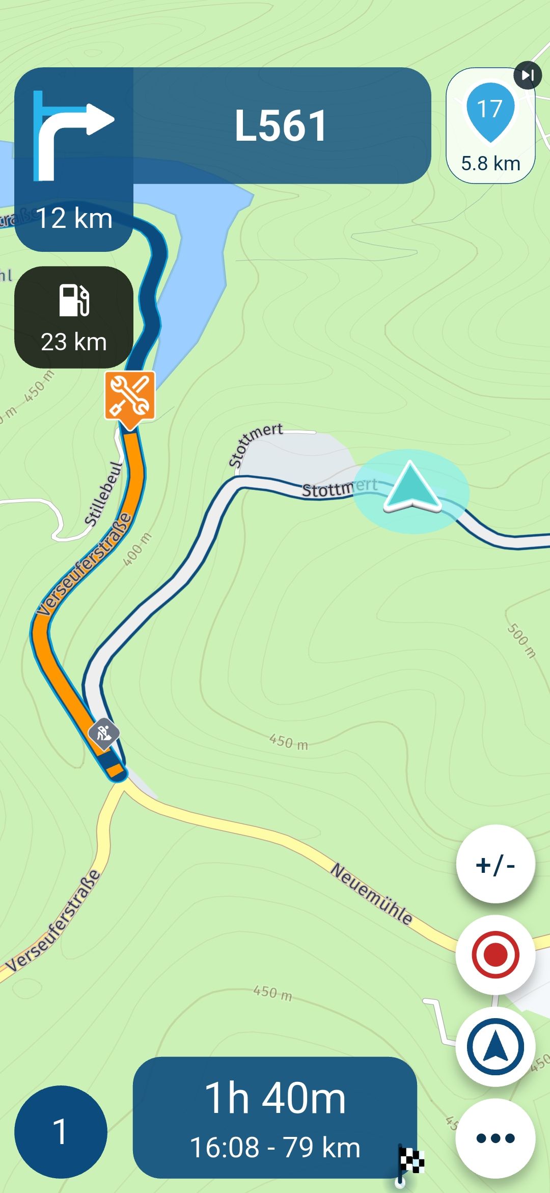

    Yesterday I made a tour ~200km.
    After a short coffee-break the navigation stopped working.
    The position marking did not move from the last place.
    No navigation prompts, no distance updates.
    So I stopped navigation. Closed MRA and restarted the App + the route.
    But the position arrow still was at the same (outdated) place. However MRA seemed to recognize that I was at a different position in the meantime (see screenshot), but navigation still was not possible.

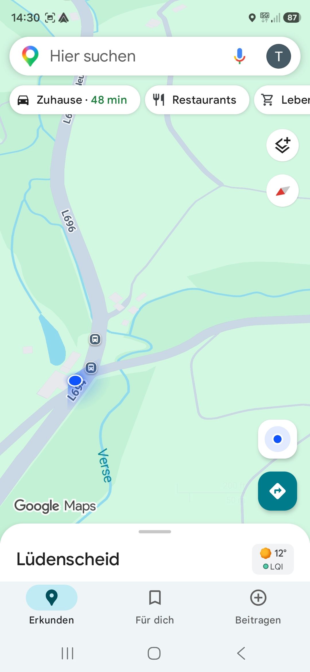

    I switched to Google Maps and my GPS position was accurate (see 2nd screenshot).
    This happend twice yesterday.
    I have given the relevant permissions in Android (always) for GPS.
    Also the Battery optimization is off.
    Clearing the App cache also had no effect.
    The only solution was to deinstall and reinstall the App.
    After thisbist was working again (temporarily).
    Am I doing anything wrong here?

      Selected the wrong screenshot in the first post.
      This is what MRA showed me:
      • Jörgen Offline
        Jörgen Offline
        Hi, it looks like on the first picture that you are using free ride without navigation.

          Hi
          Thanks for your reply.
          I had added an additional screenshot. Please refer the 2nd post.
          As new member my input is reviewed first and published with a delay, actually.
          In this 2nd screenshot you can see, what I was referring to.
          The position arrow is still at the old position (where we had a coffee break).
          My actual position already was at the junction, exactly where the route is starting with the blue line again.
          As mentioned, ending navigation, closing the App (also from the background) and restarting, the position was shown as in my 1st posting (wrong position).
          Starting the navigation then, resulted in the situation you can see in my 2nd posting.
          Any idea what I was doing wrong?

                      Sounds a bit like this well known issue (?)
                      https://forum.myrouteapp.com/topic/10509/gps-positie-freeze
