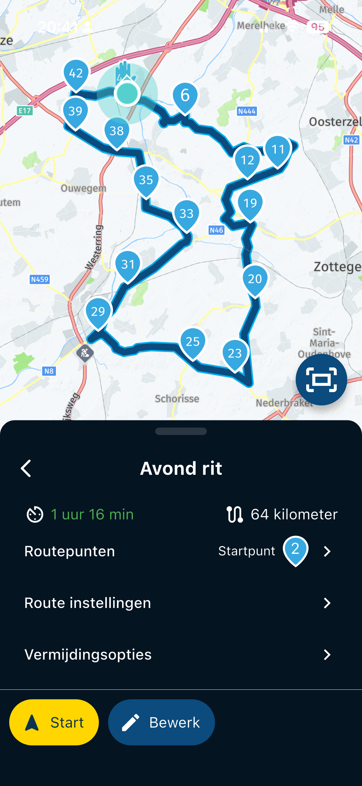

    Hallo,
    Tijdens laatste motor rit was halfweg de MRA navigatie vastgelopen. Reageerde niet meer.
    Dus app en route opnieuw opgestart, maar MRA wou de route enkel herbeginnen vanaf het startpunt. Vroeger kon je start vanaf dichtstbijzijnde routepunt selecteren. Was heel handig, maar deze optie bestaat niet meer ?
    Routes rijden als tracks staat uit.
    Wat is hiervoor de oplossing of wat deed ik fout ?

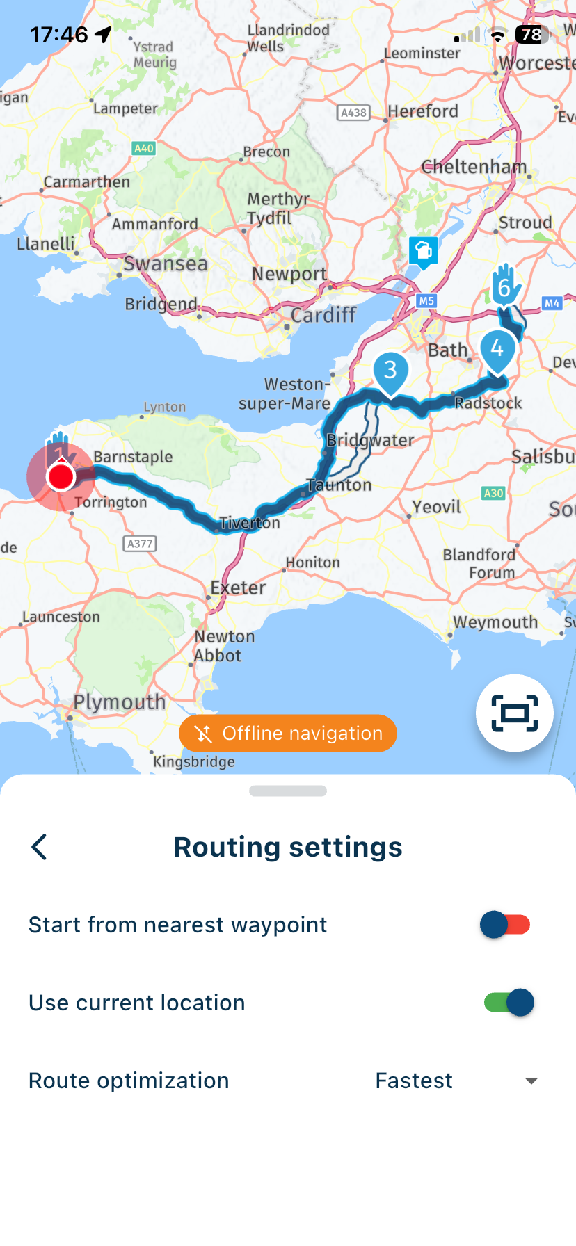

      @Philippe-Veys
      Start vanaf dichtstbijzijnde waypoint is alleen beschikbaar voordat u begint met navigeren. Tik op route-instellingen en u ziet het.
      Start from nearest waypoint is only available before you start navigating. Tap routing settings and you will see it.

                    No it is not. Before pressing "Start", tap "Route settings", there it is.
                    The correct way to pause a route, is to enter the menu, and tap "Stop navigation". A "Resume" button appears that always picks up where you left.
                    If you navigate tracks or use the "Navigate route as track" feature, this is skipped indeed, since you are navigating a track. You will have to decide the point of entry yourself indeed.

                      Ok, I noticed that for some routes I made, I have the possibility to select Route Settings with possibility to choose Start at closest waypoint before I press Start, and for some I don’t.
                      What could be the reason for this ? I don't use the routes as tracks. As I recall, I always create the routes the same way.
