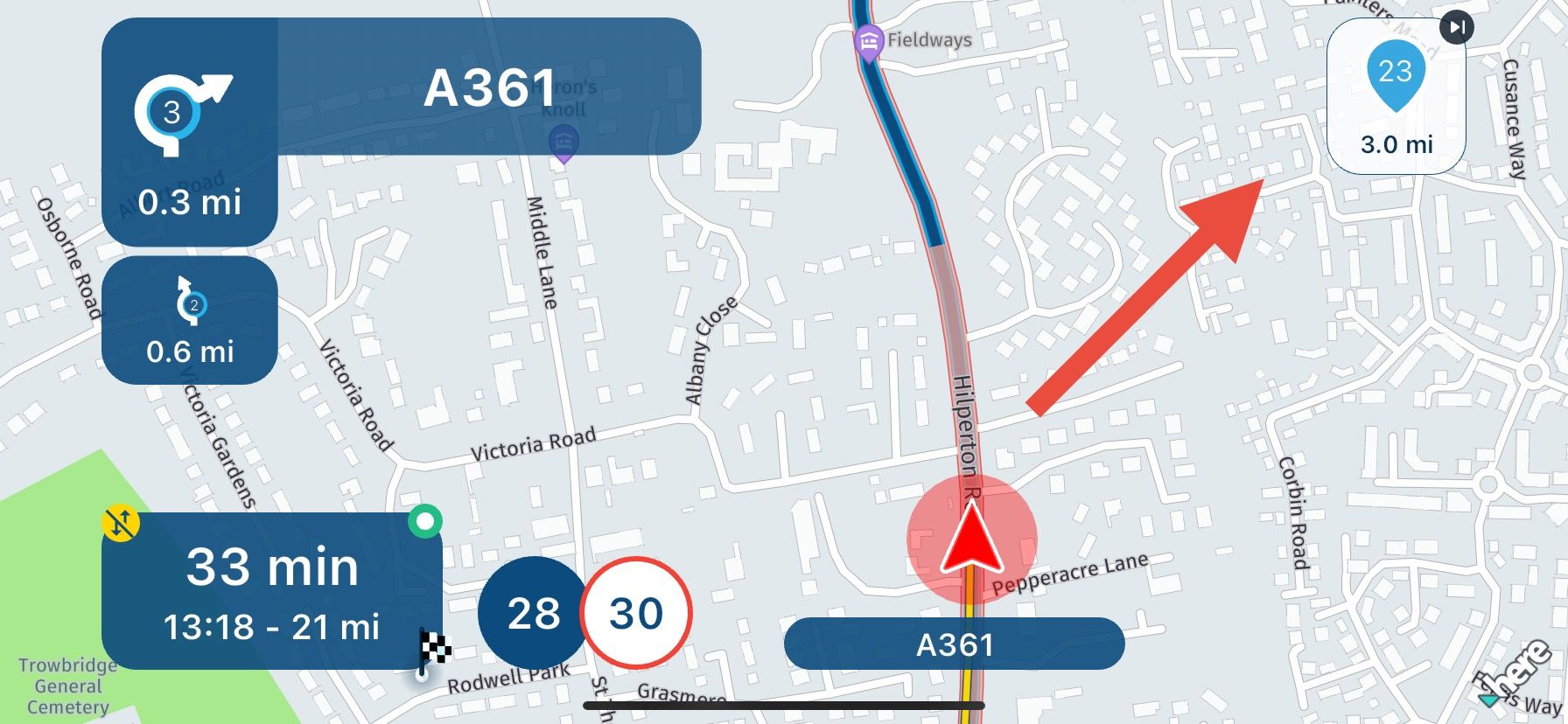

          @Lenny-O In situations like this the upcoming waypoint icon can tell you what is going on. If it is showing the number of the waypoint that you should have passed, then the chances are that the app is attempting to send you back to it as it wasn’t registered as being passed. A tap or long press of the upcoming waypoint icon will skip that waypoint and hopefully the app will continue to route you.
