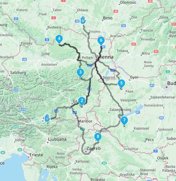

    @Brian McG:
    It may be that my planning system is unusual, but I've always found it convenient to plan this way.
    Thanks for your suggestion, too; it's very clever, but even this way involves extra work outside of MRA, and it's probably not faster than moving waypoints from the list directly into MRA.

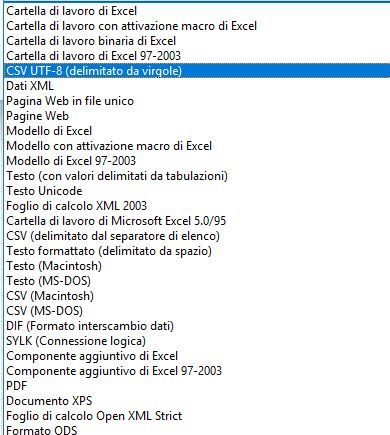

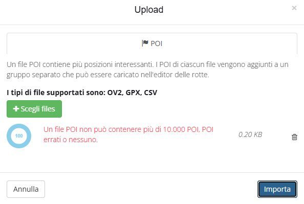

      Thanks so much for your support.

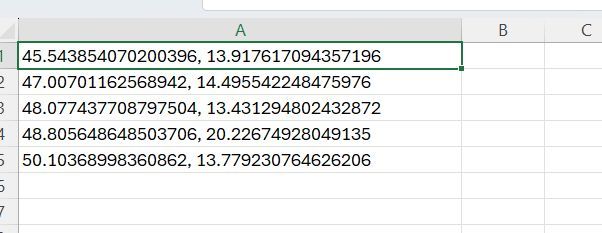

      I tried, but it doesn't work. Could you please show me how to set the coordinates in Excel and what CSV format you choose for saving?

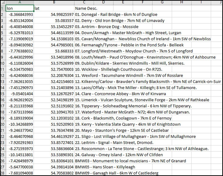

        Your CSV need to be Long, Lat and a description of the POI.
        Here's one of mine.

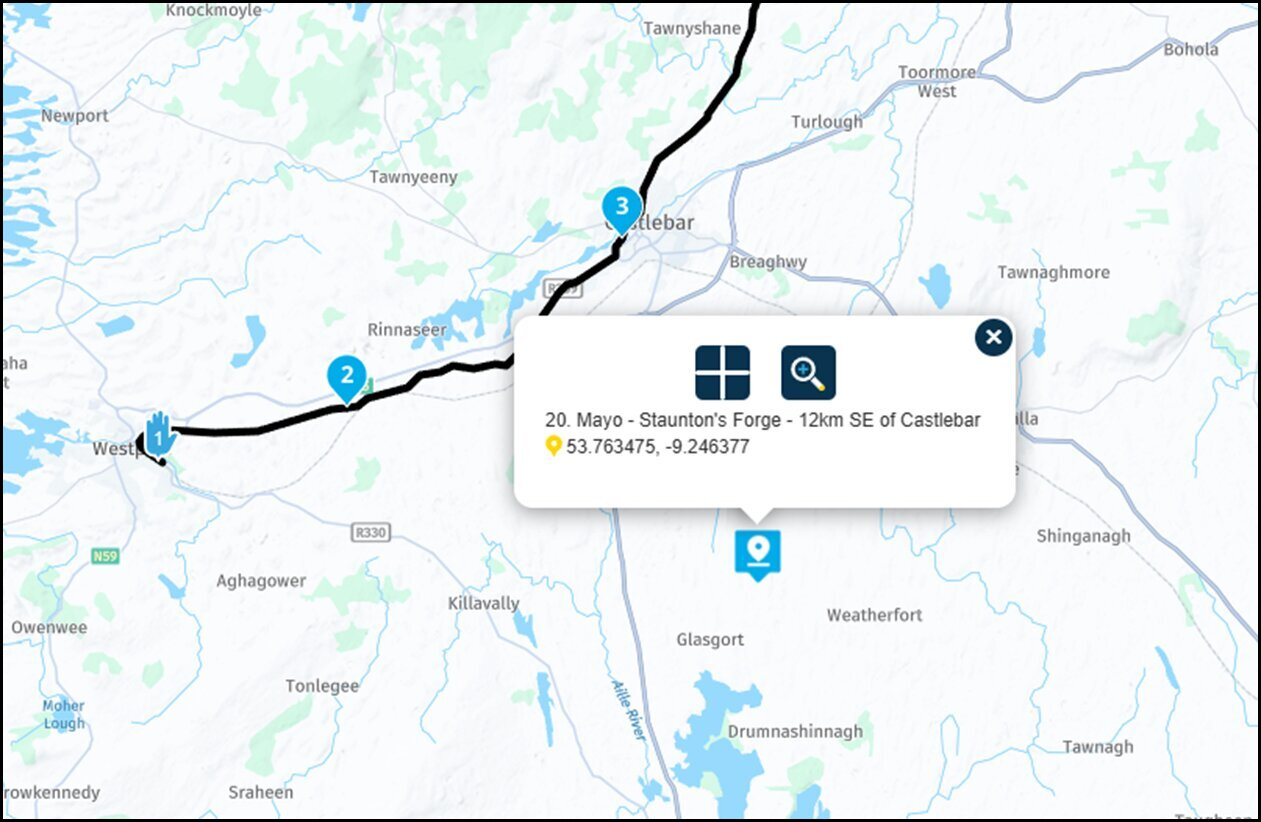

          This is what the uploaded POI's look like.

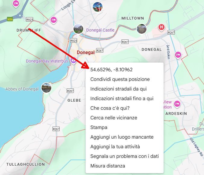

              I discovered that MRA doesn't display POIs from csv file if they're imported as lat-lon instead of lon-lat.
              My Google Maps displays them as lat-lon, and in Excel I have to reverse the parameters. Why?
              However, there is an alternative method, but it would be appreciated if MRA allowed renaming the waypoint positions.

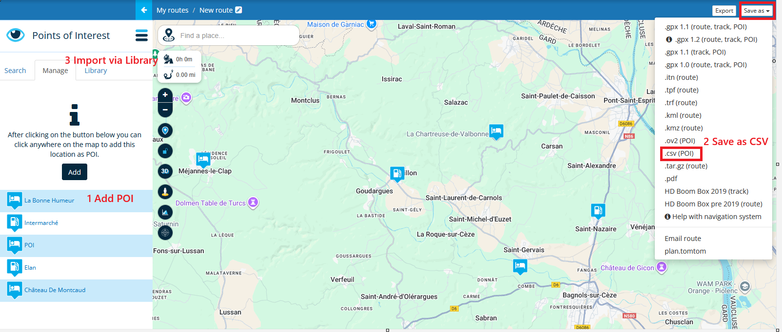

                @Corrado-Miniati-0 the easy way to understand the format is to create a map / route in MRA with some POI's
                then save the route as a CSV
                you can then inspect the csv & replicate the format
                when you create your own custom CSV to import your points, import it via the Library tab
                you will need to zoom into >=10km to see the imported POI's
                yes the lon-lat v lat-lon is an oddity of MRA, I dont know why, maybe it is a dutch thing 😊
                the points will be displayed just not in the part of the world you are expecting to find them 😂

                  Thanks, maybe Corjan could check if the lat-lon vs lon-lat theme is a bug
                    #33
                    It definitely is not a bug 🙂
                    Do I find it logical for a user perspective? No.
                    Will I change it? No. Mainly because everyone using this is now used to that.
                    I do know the origin of these things.
                    Lat / lon is preferred by humans but I don’t know why. Lon / lat is however mathematically the correct order 🙂 Longitude representing the horizontal (x) axis and Latitude the vertical (y) axis.

                            If you look at an exported KML file the lat/lon is reversed when exported, so the display in Google is different as the exported file.
