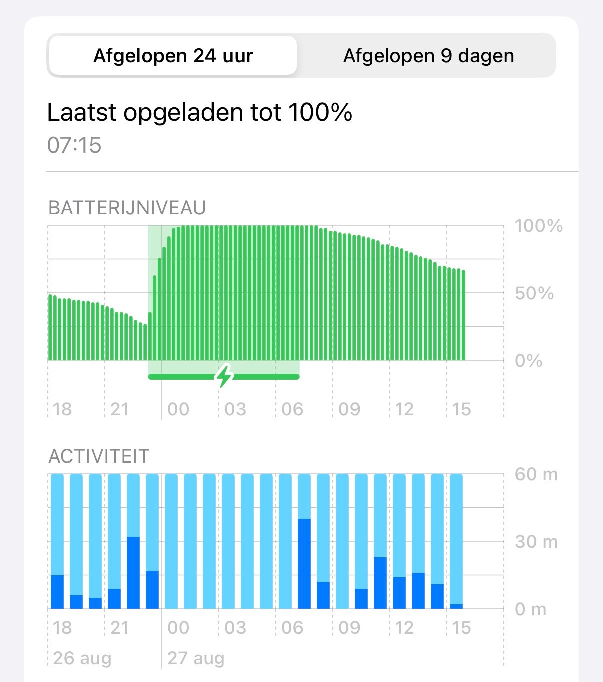

              @Thomas-Scharrer You noticed it in this battery settings menu, right?
              Corjan Meijerinkundefined Thomas Scharrerundefined 2 Replies Last reply
              • CD130undefined CD130
                #14
                @CD130 if that happens there is an issue. It definitely is not normal or expected behavior.
                Please create a support ticket if it happens including the logs and indicate if you were navigating / tracking / using CarPlay. If the last applies, share what you did once you arrived at the destination / stopped the navigation.
                  Thomas Scharrerundefined Offline
                  Thomas Scharrer
                  #15
                  @CD130 correct
