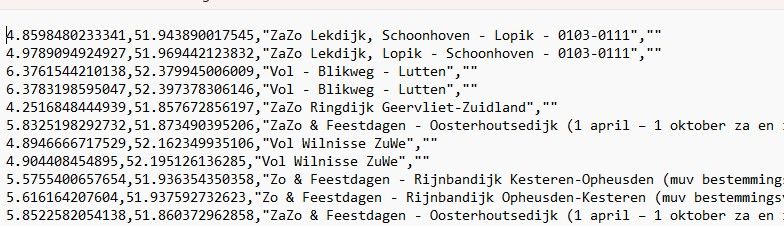

            You must only use POI's in the map and no waypoints.
            The program will still be telling you there is no route, but ignore it.
            After saving the file as .csv(POI) you can upload it again as POI.
            The file you exported looks like this when you open it in Notepad.
