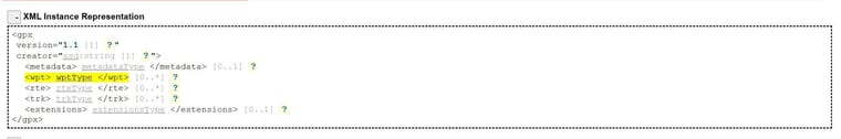

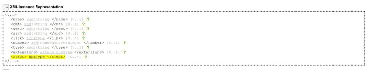

                        @Con-Hennekens
                        I'm aware of this description, and it's likely the root cause of all this confusion because it mixes up elements and types.
                        This becomes clear when you take a look at the schemas:gpx.jpg
                        <wpt> is an element, <rtept> is a different element. Both have the same type (<wptType>).

                          #33
                          @Con-Hennekens
                          A Trackpoint (<trkpt>) has the same type <wptType>, but you wouldn't call a track point a waypoint, right?
