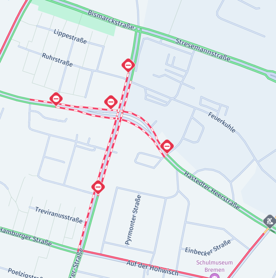

    What are seasonal closures?
    Online route planning MRA Web.
    Here® Engine. Motorcycle.
    For me, seasonal closures meant things like closed mountain passes in the Alps or roads closed in winter.
    Now I noticed this difference on a route with roadworks.
    I was pleased to see that Here® plans around the roadworks.
    Then I deactivated seasonal closures.
    And now Here® plans the route through the roadworks.
    It's good to know that this is possible. And I can live with it, but it's a setting that changes something significantly without the user being aware of it!
    But what are seasonal closures really?
    This is how it looks on HereWeGo®:

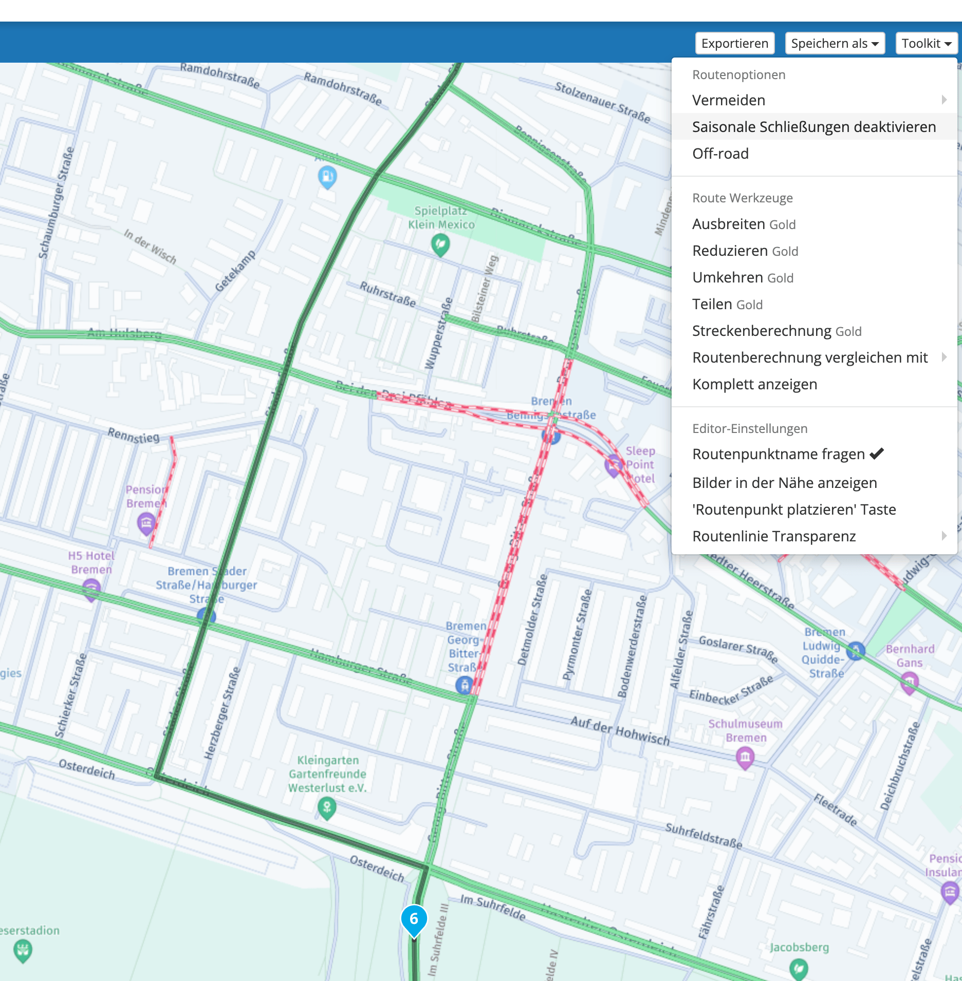

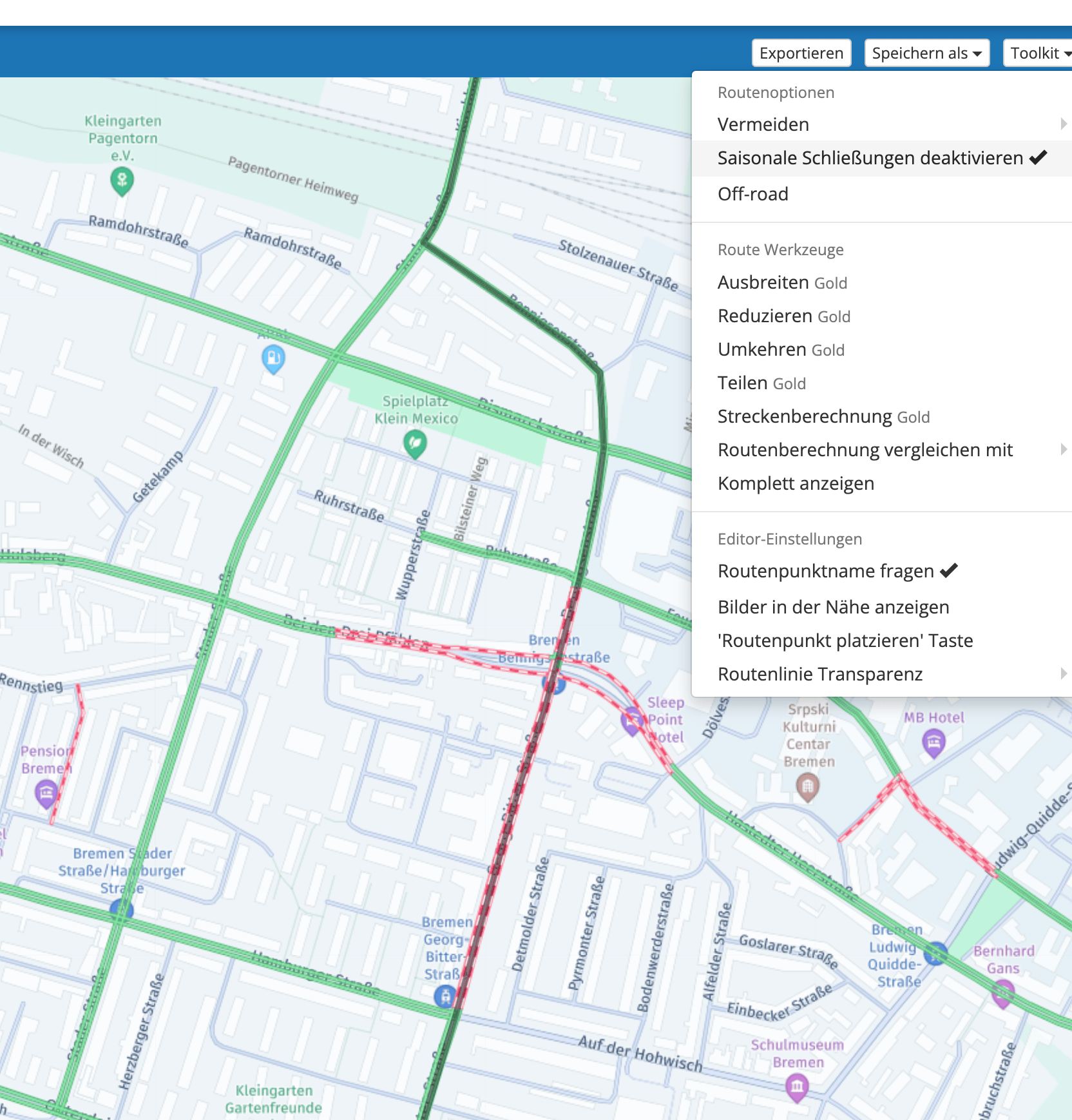

    Route Planning With seasonal closures activated:
    With seasonal closures deactivated:

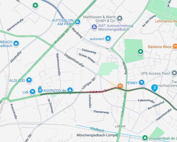

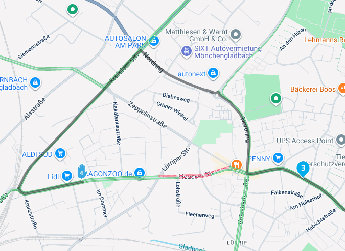

            • Jörgen
              Hi, I tried your problem with a closed road in Mönchengladbach and see the same issue.
              If “sessional closure” is active you will be guided around the closed street, if deactivated you drive through the closed street.
              This looks like a bug in the Here map that needs to be noticed to HERE from MRA.
              Active
              Deactivated
