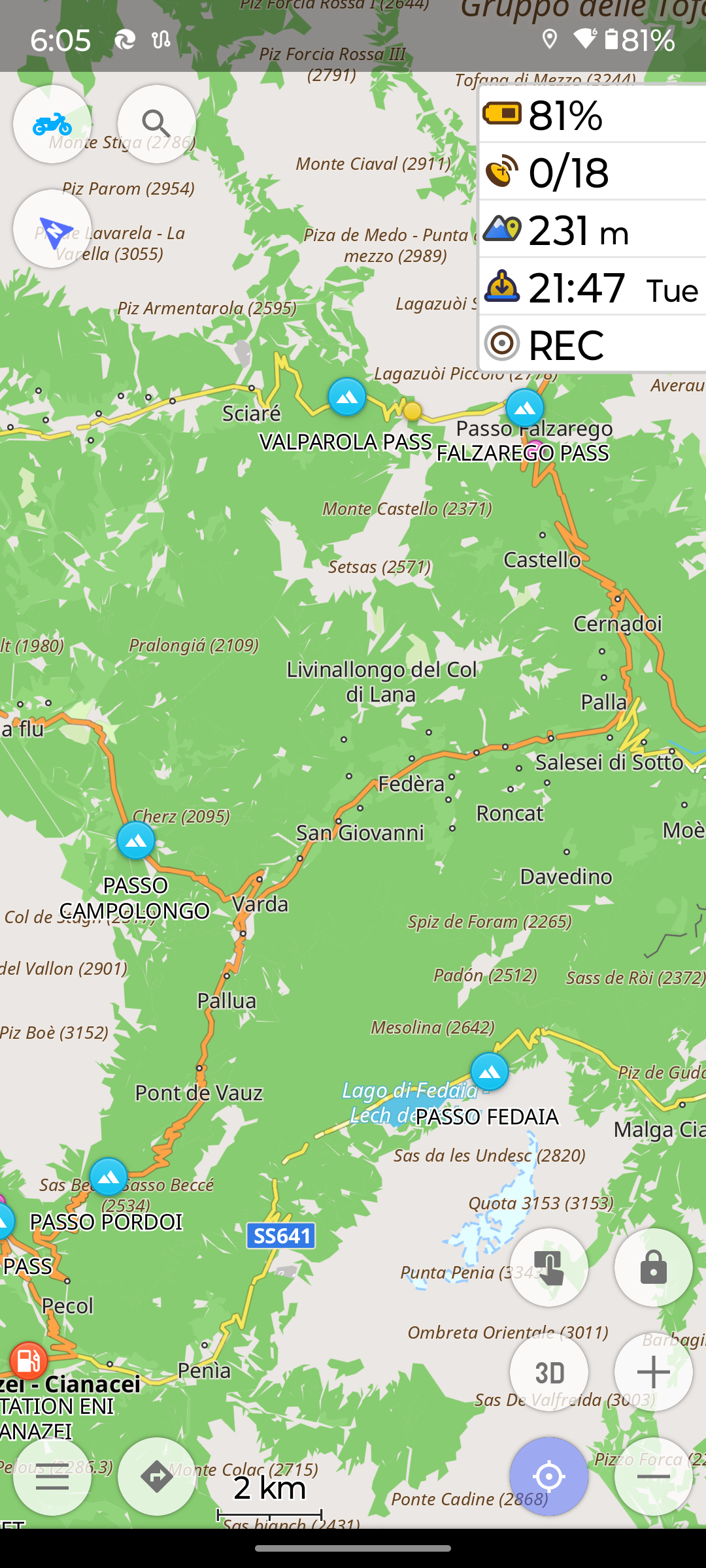

    One major issue I encountered was with tunnels. In an Austrian tunnel, I missed an exit leading to another part of the highway (also within a tunnel), because the navigation froze and the location cursor stopped moving once GPS signal was lost. As a workaround for the next tunnels, I switched to OsmAnd, using a GPX file exported from MyRoute App. OsmAnd handles tunnels differently: after GPS signal is lost, the cursor continues to move at the last known speed, which allows uninterrupted navigation. If you maintain a steady speed, the GPS resumes smoothly after exiting the tunnel with no visible lag or navigation hiccups.
    I went back to using MyRoute App until day seven of the trip, when bad weather forced me to plan a new route home while also trying to visit some of the attractions I had originally scheduled for later. I attempted to plan a new route using the app’s built-in planner. Unfortunately, this didn’t help at all because the POIs I had saved in the online planner on my PC were not visible in the mobile app, and I had no internet access to use the web version.
    I had to switch back to OsmAnd, where I had the same POIs organized in folders and displayed directly on the map. Creating a new route was easy — I just selected the POIs as waypoints and continued navigating without any hassle.

        Manzo91
        "As a workaround for the next tunnels, I switched to OsmAnd, using a GPX file exported from MyRoute App. OsmAnd handles tunnels differently: after GPS signal is lost, the cursor continues to move at the last known speed, which allows uninterrupted navigation. If you maintain a steady speed, the GPS resumes smoothly after exiting the tunnel with no visible lag or navigation hiccups."
        I hope they implement also this to MRA because i've had your same problem with some tunnel.

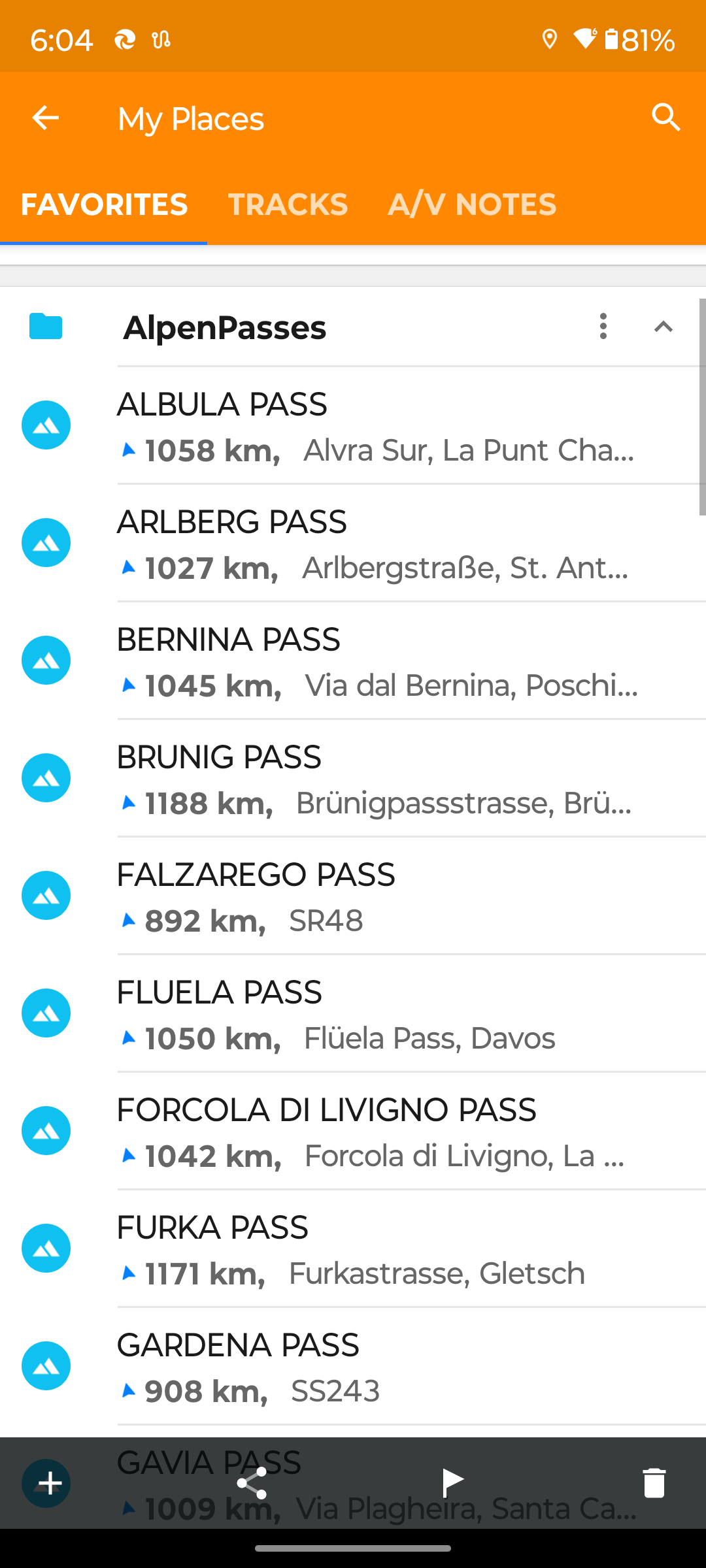

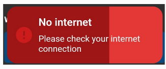

                    @Guzzist I am talking about creating a NEW route ... Using the saved POI lists ... without internet,
                    said in Experience with MRA through Swiss Alps, Dolomites, Austrian Alps:
                    I feel more comfortable to use in App the "Route lab
                    Try that without internet !

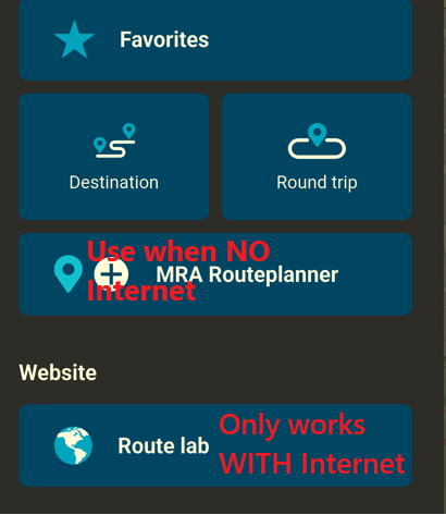

                      @Adrian-Avram said in Experience with MRA through Swiss Alps, Dolomites, Austrian Alps:
                      @Guzzist I am talking about creating a NEW route ... Using the saved POI lists ... without internet...
                      oh sorry, unfortunately I overlooked that.
                      MyRoute-App does have different functionality as other Apps, like OsMand.
                      If you want to work offline, you need to download "offline maps" for all regions you want to drive, in forefront. As long as you have Internet connection. By downloading the map, all the internal POI will be included!
                      Later on, while you drive, you can stay offline.

                      • Guzzistundefined Guzzist
                            you cannot plan a new route using the in app web planner without internet.
                            I think you have pretty much answered your own question - a WEB planner is obviously not going to work without a connection to the internet!
                            You get this red warning when you try to access the WEB planner when not connected to the internet because your not connected to the internet!!
                            You could try clicking the APP planner button which will allow you to plan a route completley OFFLINE instead of clicking the wrong WEB planner when your offline
                            It won't help with your POI issue but you could have made a polite sugesstion that such a feature would be nice to have
                            Normally navigate "Routes as Tracks" in Offline mode with Offline Maps
