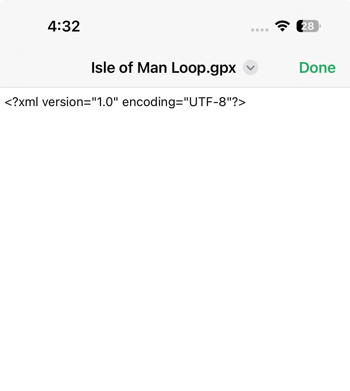

    After creating a route on MRA, i download it (.gpx 1.2) and share it with a friend. When he opens then file, it shows as 'incomplete' - per the screenshot attached. Why does this happen. Sharing the same route via link from MRA opens up correctly on MRA used by another friend.

        Share the gpx 1.1 file

          .gpx 1.2 is an proprietary format from MRA.
          So better use a compatible format. See post above.

              Does 1.1 behave differently than 1.2?

                Yes, gpx 1.2 is a route-track with via points, so it does needs via points in the file.
                Gpx 1.1 is a route, track and poi’s
                • Guzzist
                  I 'm sure, gpx 1.1 nor gpx 1.2 is the reason for incomplete created file. As the screenshot shows: only the first line is in the file; rest is missing!
                  So, there must me another reason, why the file isn't created correctly.

                    When i save the route as gpx 1.2 the gpx file look normal and complete

                      I’ve looked at your route and saw a few things
                      There’s a lot of shapingpoints that are not ON the route this giving Garmin devices the possibilty to mess up your route.
                      You say that you’re trying to export a 1.2 gpx. That Will only work on a Garmin device. Does your friend have a Garmin. If yes for the 1.2 format the advise is to add a couple of viapoints extra
                      The export of the 1.2 didn’t show up wrong on my end
                      Last
                      I’ve noticed that you set the route to motorcycle a profile that has not a lot Off d’avantages in it so that’s why I only use the car profile.

                        @Marinus-van-Deudekom, your observations are probably correct, but neither of them are relevant for the question.
                        @Guzzist said in Sharing downloaded GPX - shows incomplete:
                        I 'm sure, gpx 1.1 nor gpx 1.2 is the reason for incomplete created file. As the screenshot shows: only the first line is in the file; rest is missing! So, there must me another reason, why the file isn't created correctly.
                        I agree

                          Bottom line is that I need to share 1.1 if sharing gpx file
                          Thank you all for your help.
