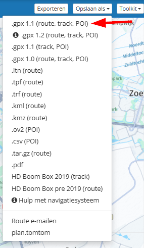

        @Stephen-Moriarty if you save your MRA-ROUTEPLANNER route as gpx, please be carefully, because in the list of possible formats for download, there are gpx options "only track" as well as "track and route".
        Next, you need to know about the "nature" of a track: it's typically, navigation devices populates only start point and end point on screen. The "nature" of a route is: additionally to start- and end point, there can be more dedicated route points, which will be populated on screen of navi devices.
        If you are using DMD device / DMD2 app, you can load a gpx 1.1 file, which contains track and route. In DMD2 App, you can select the track and choose a color (I'm using light green for tracks). Then select the route and choose a different color (I'm using purple for routes). And set the option, to make both - track and route - visible on screen.
        By this, you can see, if routing algorithm of DMD2 App is really following your planned route. If purple route line is exactly on light green track line.
        At least: DMD devices are based on Android, means: you can additionally to DMD2 App also MyRoute-App run on the device. For MyRoute-App, it's not necessary to handle with gpx files, because there is an option you can select, to activate a ongoing synchronisation between MRA-Routeplanner and MyRouteApp.

          Please keep in mind that the gpx 1.2 format is not an official format! It is made by MRA to add some extra features whch is not included in the official 1.1 format. So, best is to use the gpx 1.1 format since this is the official format. Read here more about the gpx 1.1 format: https://www.topografix.com/gpx.asp
          You can save your route as a 1.1 format gpx file includin routte, track and POI.
