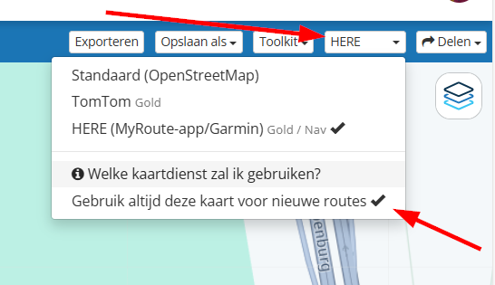

          Why everybody is recommending a subscription is not clear to me.
          @Roger-Needham-0 said in Other travellers using MRA not following the defined route:
          I am a Lifetime Gold Routeplanner. I therefore understand that the routes that i plan will be in HERE format.
          No, you can still use TomTOm and OSM as standard layer. This can be set in the pulldown menu were you choose your standard layer. Only with Gold you have TomTom and HERE. The default layer is OSM.
          Some friends that are standard MRA Navigation users have noted that when we are out on the road, their 'version' will sometimes take them off the route that I am following. Is this because they will be using OpenStreetMap format?
          No has basically not much to do with the layer (map). In some cases there arfe small differences between OSM, TomTom and HERE but this has more to do with how accurate and up-to-date the mapmakers maintain and update their maps. Nothing to do with MRA.
          Also, the choice of layer (map) to use will have not much influence in the route and how you drive it. My best guess is, is that your friends have reroute calculation switched on. And then you could run into the possibility that were you rturn right, your friends (or some of them) must turn left according to their navigation to get to the next waypoint (shorter route/shorter distance). You should check this.

              @Roger-Needham-0 The users of a TomTom-device use another map and they can't switch off automatic recalculation. If a road that is used in the route does not exist in the map of the TomTom, the TomTom will automatically take another road on its map (part of the software design). If you want to avoid this you should compare the routes in Toolkit and erase the differences by changing waypoints..
