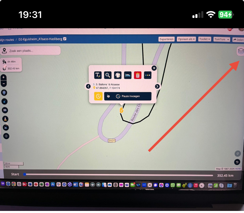

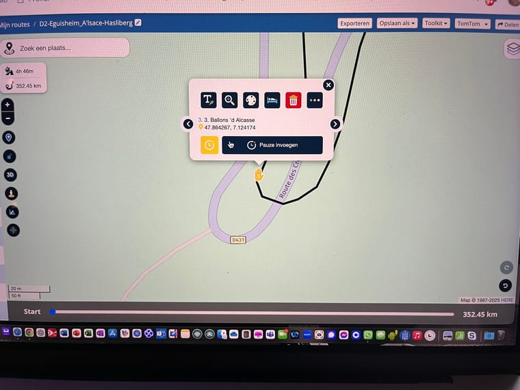

    Hi, Ive generated a few routes for an upcoming road trip. I'm using the web routeplanner in an Chrome browser on my MacBook Pro. Im using the TomTom Maps since ill be using the route on my BMW Connected Ride Navigator. Now i've notisced that some parts of the route does not follow the actual TomTom map. The RP's are correct, if i create a RP on the actual map road, the name of the road is corect but the plotted line remains off.
    Any ideas as to what is happening here? Thanks in advance!!

      @Kenneth-de-Miranda if you select the TomTom overlay map you will see the route line follows the road.

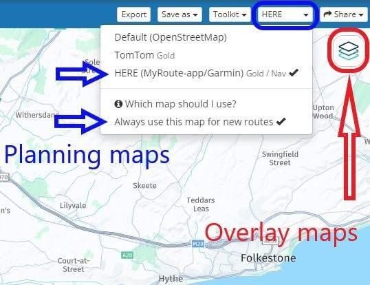

          @Kenneth-de-Miranda Your planning map is the TomTom map. You can set that as your default planning map by clicking: Always use this map for new routes.
          The planning map is the map that makes all of the calculations.
          The overlay maps do not affect any route calculations. Think of the overlay maps as clear sheet with extra information that you lay over the planning map.
          The system will remember the last overlay maps as that you used.

              The planning maps are in the blue menu bar, if you do not see the blue bar, all of the same options can be seen after clicking Page menu.

                    @silberfuchs67 When planning your route using the planning map from TomTom, turn on the Compare route with HERE tool. This will show an additional green route line (the HERE route) place enough route points so that the green line from HERE follows the black TomTom line.
                    When you navigate this route with MRA Navigation Next, because it has not been planned on the HERE map, the app will navigate it as a track so you will need to be online.
