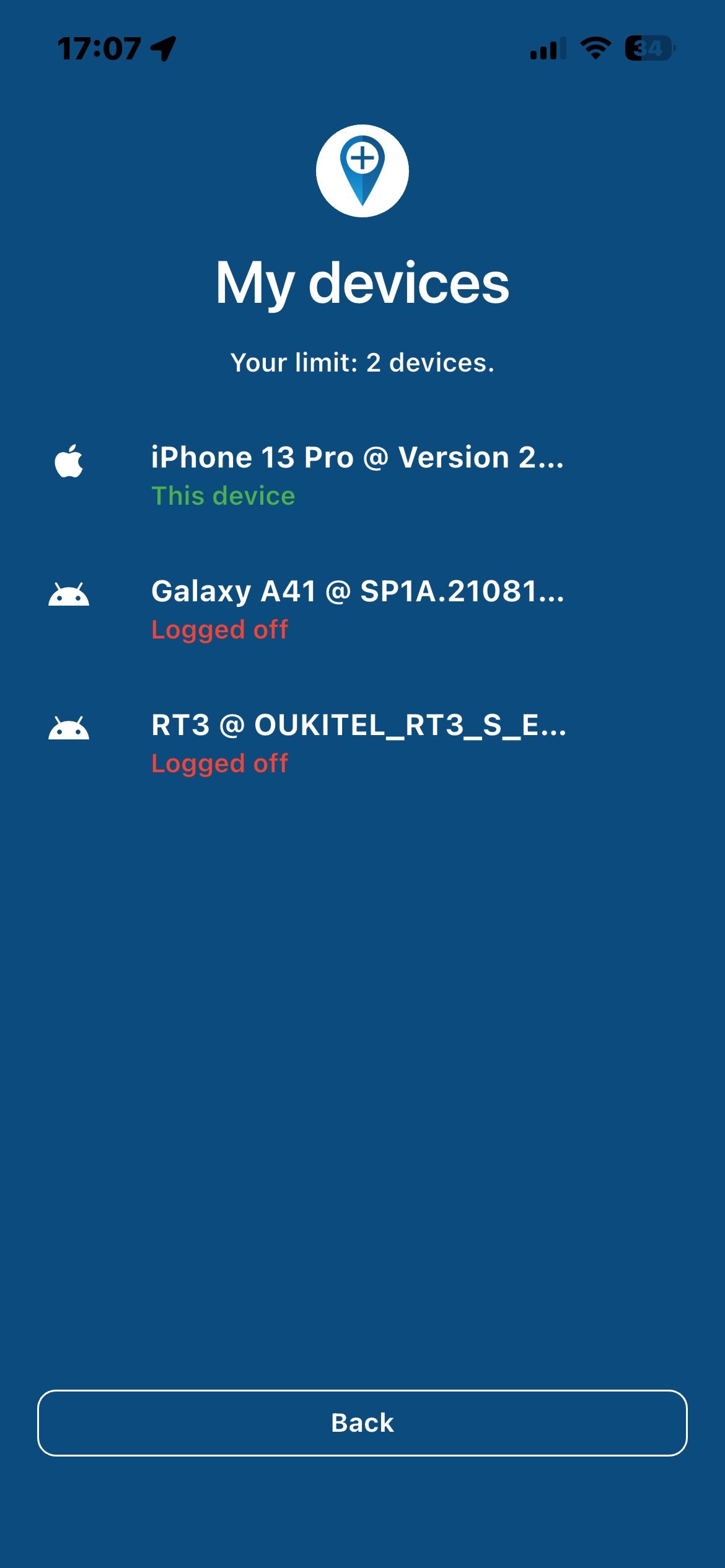

                            Simon von Kaufmann
                            Simon von Kaufmann
                            Simon von Kaufmann
                            I also had this problem as well trying to use the Web version of MyRoute-app. Some have given a partial answer but I would like to explain a bit more as I needed to work this out too. The Zumo is designed to interact with your mobile phone. So you need to download the My-route-app onto your mobile phone from the Appstore (I am using Apple ios) and then transfer the file to your Zumo using Garmin Drive. It will then come through as a track which you can convert to a route if you want to.
