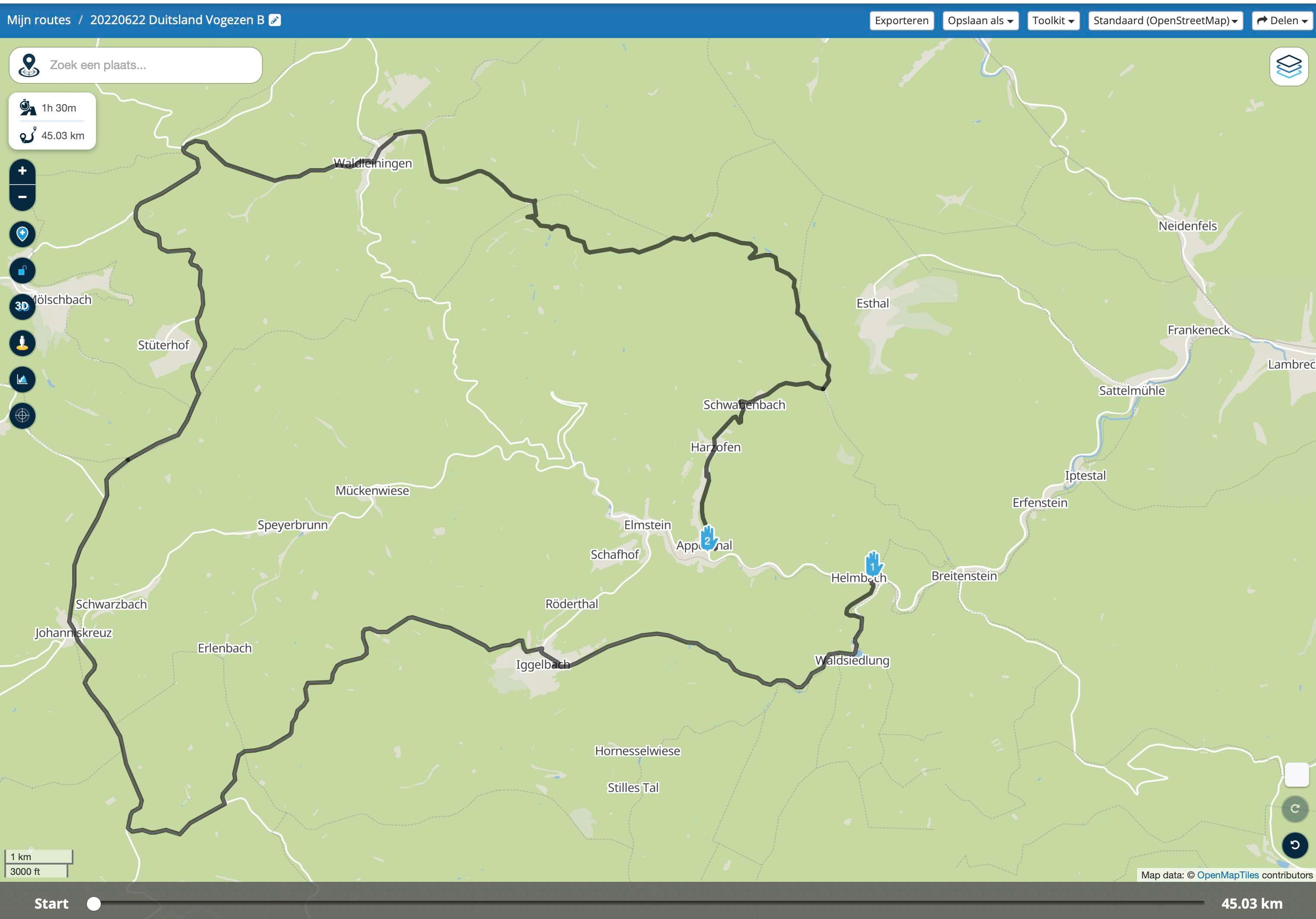

        i have same problem.. way points only a few hundred meters apart show a complete unnecessary track of several kilometers wrong route

            @nick-carthew well that would be logic.. how ever.. it is also on random streets..
            ![alt text](Schermafbeelding.jpg image url)
            Radar 1973 1 Reply Last reply

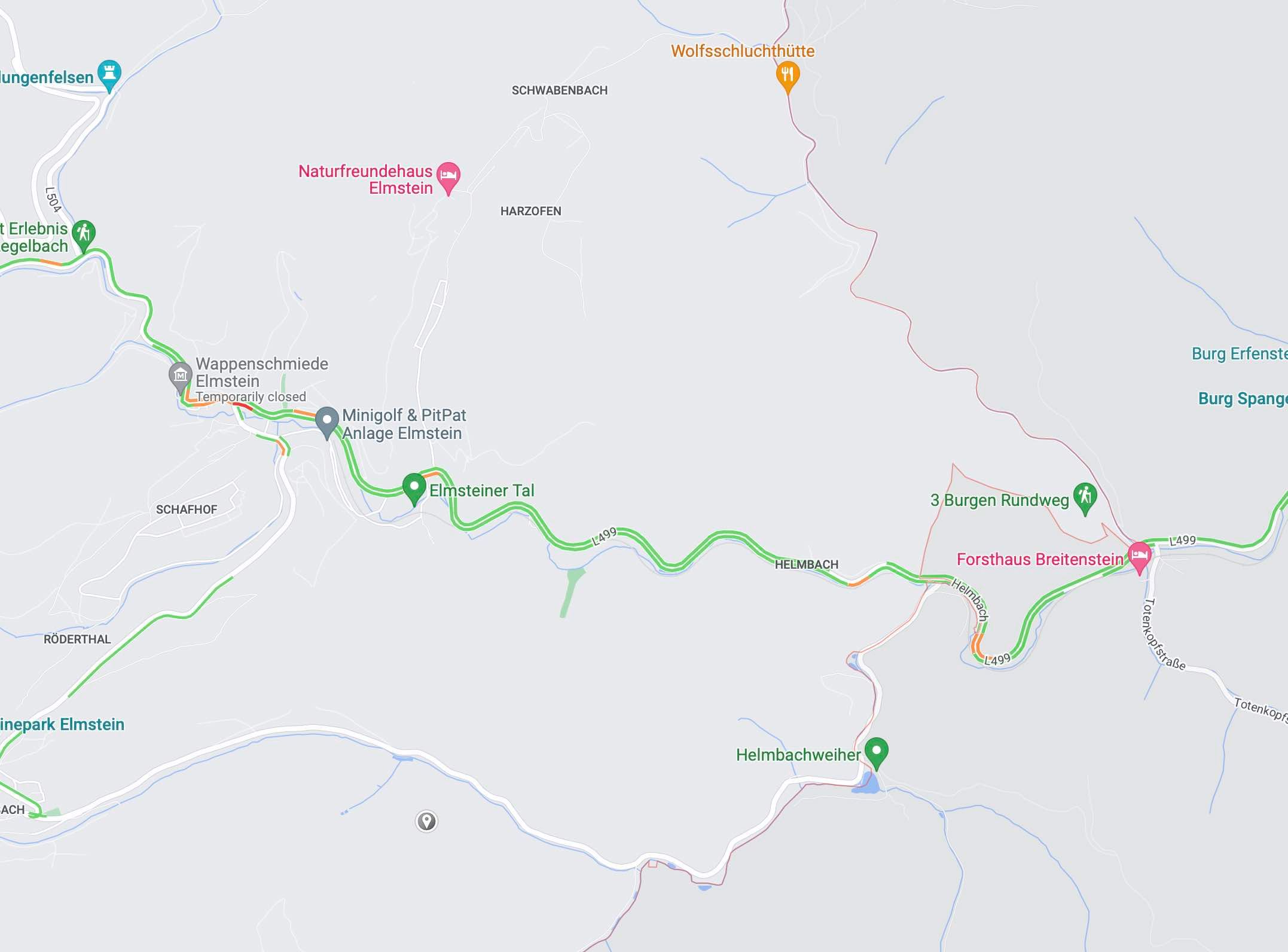

              @radar-1973 Schermafbeelding traffic.jpg And this is GOOGLE traffic.. zo no reason that there cannot be a route between 1 and 2????

                @radar-1973 Share the url for the route please.

                  @nick-carthew https://www.myrouteapp.com/nl/social/route/6205322?mode=share

                    @radar-1973 looks like MRA uses a different way of calculating route (walking in stead of riding motor)

                      @radar-1973 It does look strange, I will report it to the developers. Thanks

                        @nick-carthew This road is blocked for motorcycles from 1. April to 31. October.

                          @radar-1973 Could it be related to the Streckensperrungen (road closures)? If I change the mode of transport to cycling the road between route points 1 and 2 is used!

                            @reinhard-32 I thought it was possibly part of the Streckensperrungen. Thanks for confirming 👍đŸŧ

                              @nick-carthew In addition here is a good startpoint for road closures in Germany:
                              http://www.mintelonline.de/Streckensperrungen/

                                  @reinhard-32 Thanks It would have never occurred to me that it was closed because google did not show that!! thanks for the closure website!!
