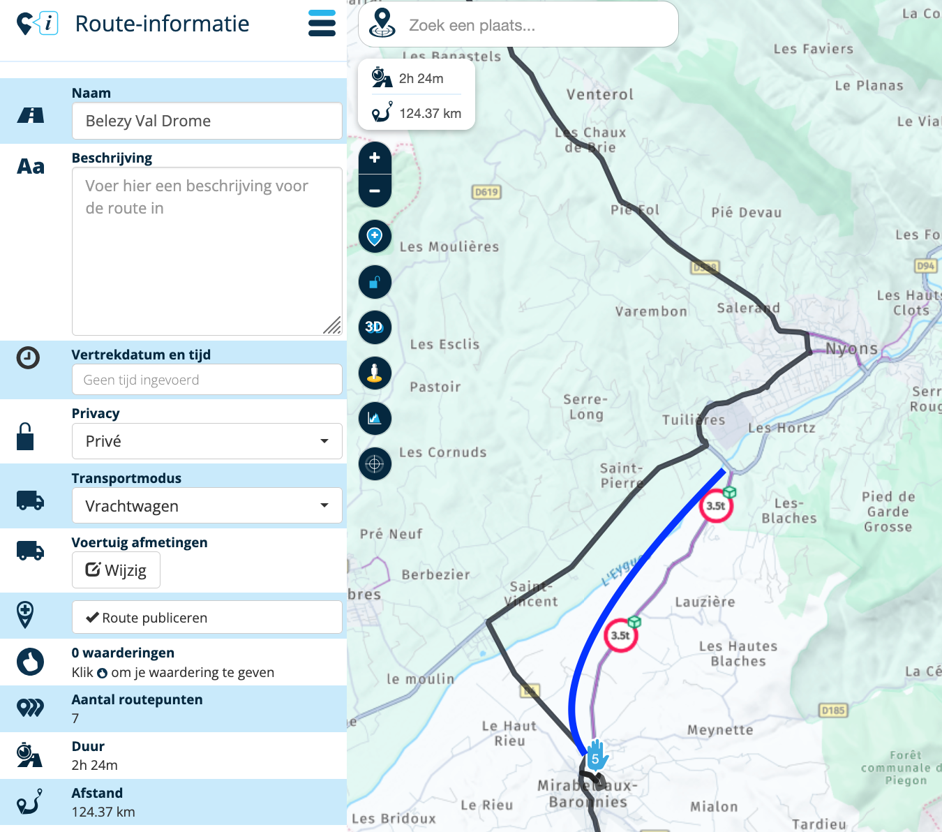

      @Robineke Let’s first establish which sign should apply in order to interpret the rules implemented in the planner. There are different signs for different types of vehicles.
      If a road is marked with the sign shown below, no vehicle heavier than the weight indicated on the sign is allowed to use that road. In addition, there are separate signs for motorhomes and trucks with a specified weight limit.
      And then that data also needs to be included in HERE’s map data, as HERE is the map provider for the planner. If I enter the weight of your motorhome as the weight for a truck, I actually get a different route at the points you mention.

          @Travellexxie When you select the logistics map, you can indeed see that the route the motorhome is being directed over (blue line) is subject to a restriction for vehicles over 3,500 kg. So I agree with your finding.

              @Rob-Verhoeff indeed it is the sign as you indicated. I am aware of truck limits over 3,5t which are not applicable for campers. This is the sign for all vehicles.
              When I come close to the route limitation it indicates."restricted route" but then it is far too late.

                      @Travellexxie I got your point, I think. My camper weight is 4500kg but the road is limited to 3500kg.
                      It means that my weight is far higher then allowed so MRA should take that in account.
                      And that is not what it does only at the latest moment of entry, when I see the sign, it mentions "restricted road".
                      Unfortunately it does not provide another road and still guids me over the road which is limited to max 3500kg.

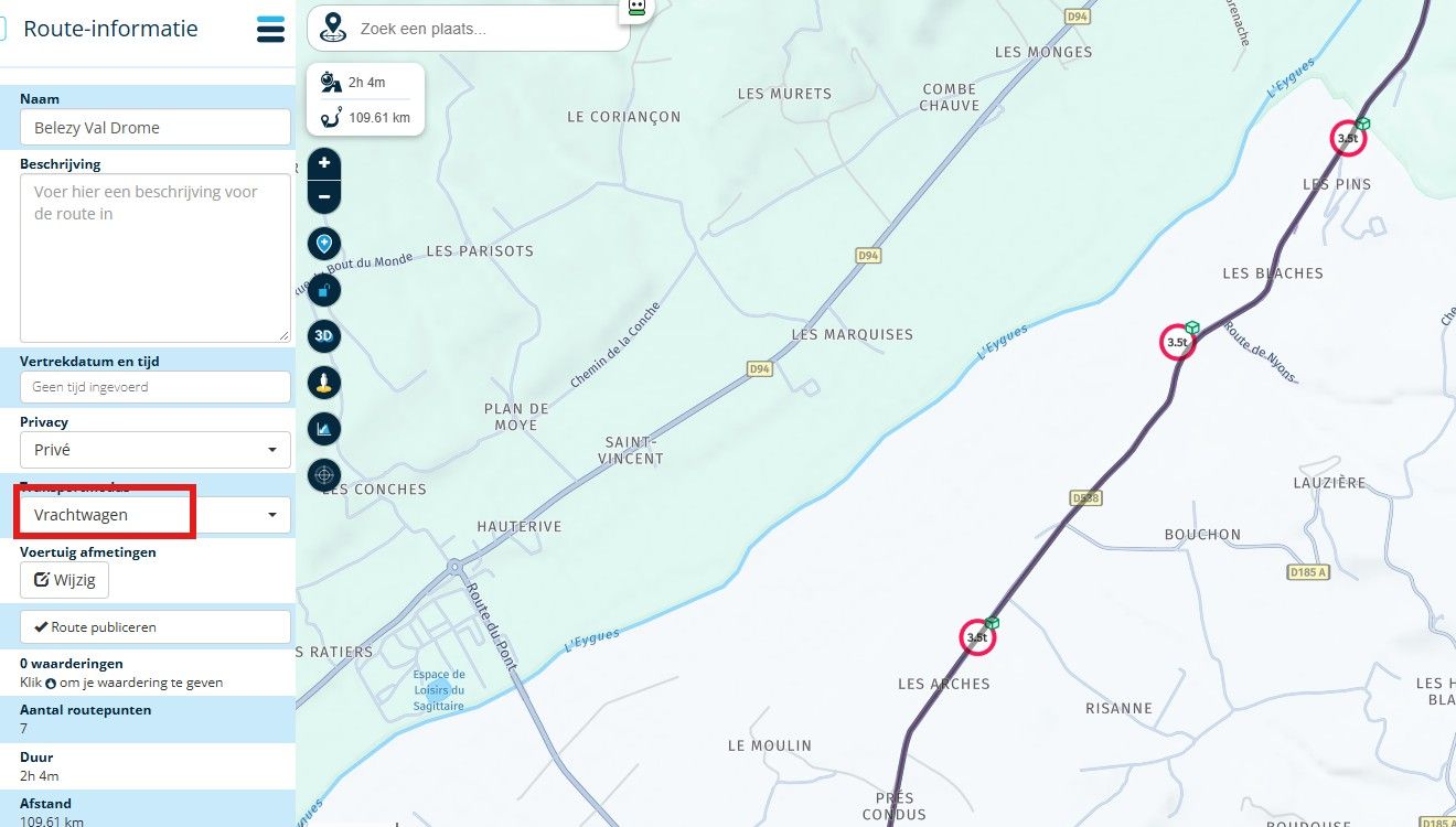

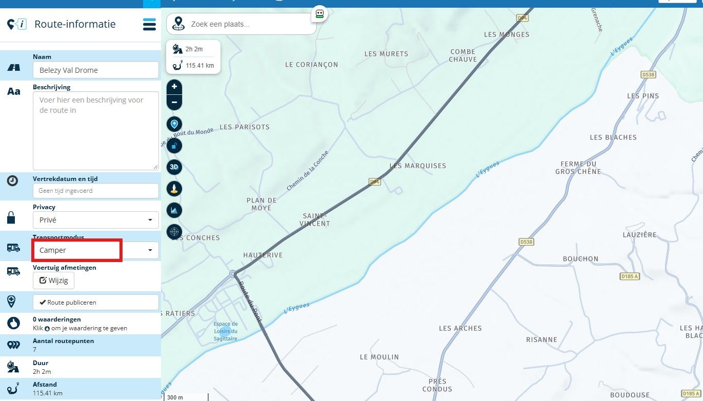

                                  That's funny, I don't. And the most funny part is (I raised my camper to 4500kg), that in the truck mode, the route still goes over the <3500 road. In Camper mode it is OK, but the sings aren't there.
                                  Camper mode
                                  Truck mode
                                    Camper mode
                                    Truck mode

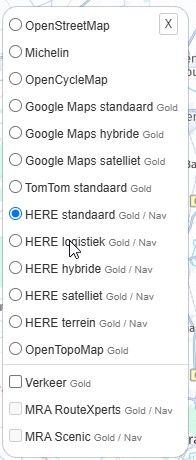

                                    @Travellexxie, For truck mode automatically the logistics layer gets activated, for camper mode it does not, because many campers don't need that. Just enable the logistics layer 😉

                                        @Travellexxie Maybe you were already using the HERE Logistics overlay map, the overlay map is remembered from your last route.
                                          @Nick-Carthew no I didn't, I have used the camperprofile plenty of times during my 3 months travel through Spain and Portugal, The "weight-indicator" was there when I started this profile.
