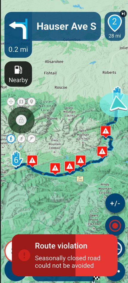

    I can't figure out why MRA is not allowing me to make a direct route entirely along the Beartooth Highway from Red Lodge, MT, to Cooke City, MT, and including the portion in Wyoming. I can only guess that MRA knows there is a road closure which doesn't allow the direct path. I created this route about two months ago, and back then, MRA did follow the Beartooth Highway, but today it does not.
    I can not find any road closure information on the MT or WY DOT websites.
    Any ideas?

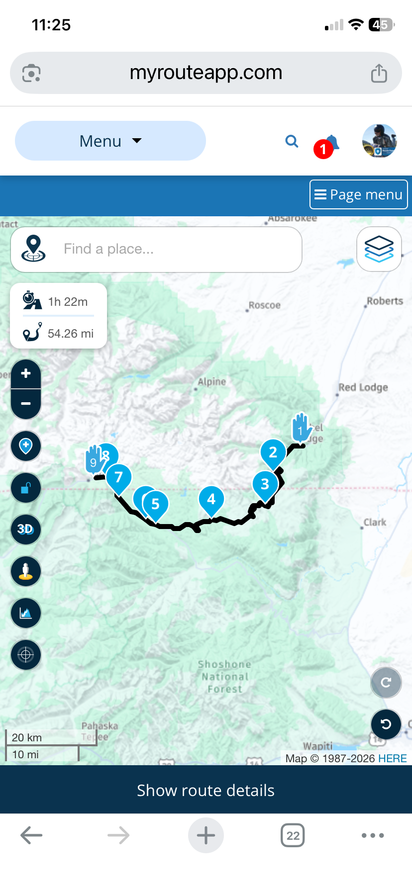

          @Stevedo-6-0
          I was able to route on the Beartooth Highway without using the Disable seasonal closure tool, I just added some extra route points.

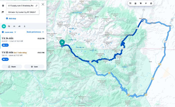

            @Stevedo-6-0 said: I assume that this is a HERE maps issue.
            Use the "Compare" tool & you will see that TomTom & OpenStreetMap route without a problem
            I would then go to Google maps & simply try to route from Red Lodge to Cooke City
            If Google, TomTom & OpenStreetMap say its passable, then you can be pretty confident you are correct in saying yet again the Here map data is bad
            In this case the Here map data seems to only be bad / out of date for MRA as the HereWeGo site seems to route through with no issue

              @Nick-Carthew Nick, that's interesting...
              As soon as I saw the post come out, I tried to create the same route and it would not let me. I started adding waypoints and found 2 spots where it wanted to create a bypass. (WP6-WP7 and WP8-WP9)
              One of the roads to be used as a bypass was seen as blocked by the gate on Street View (WP8-WP9).
              I did not disable seasonal closures, of course and no avoidances selected.
              I also searched the Internet and was not able to find any closures posted anywhere.
              TomTom and OSM Navigate straight thru the bypasses on HERE.
              https://www.myrouteapp.com/route/open/14020487
              So, I wonder what made you able to do ut without a problem...???
              You must have this thing in total submission to you! 🤕
              I noticed that you did your route on the phone, so I thought hmmm... maybe that's where it is somehow different. So, I just tried my phone and encountered the same issue as on the Route Planner.

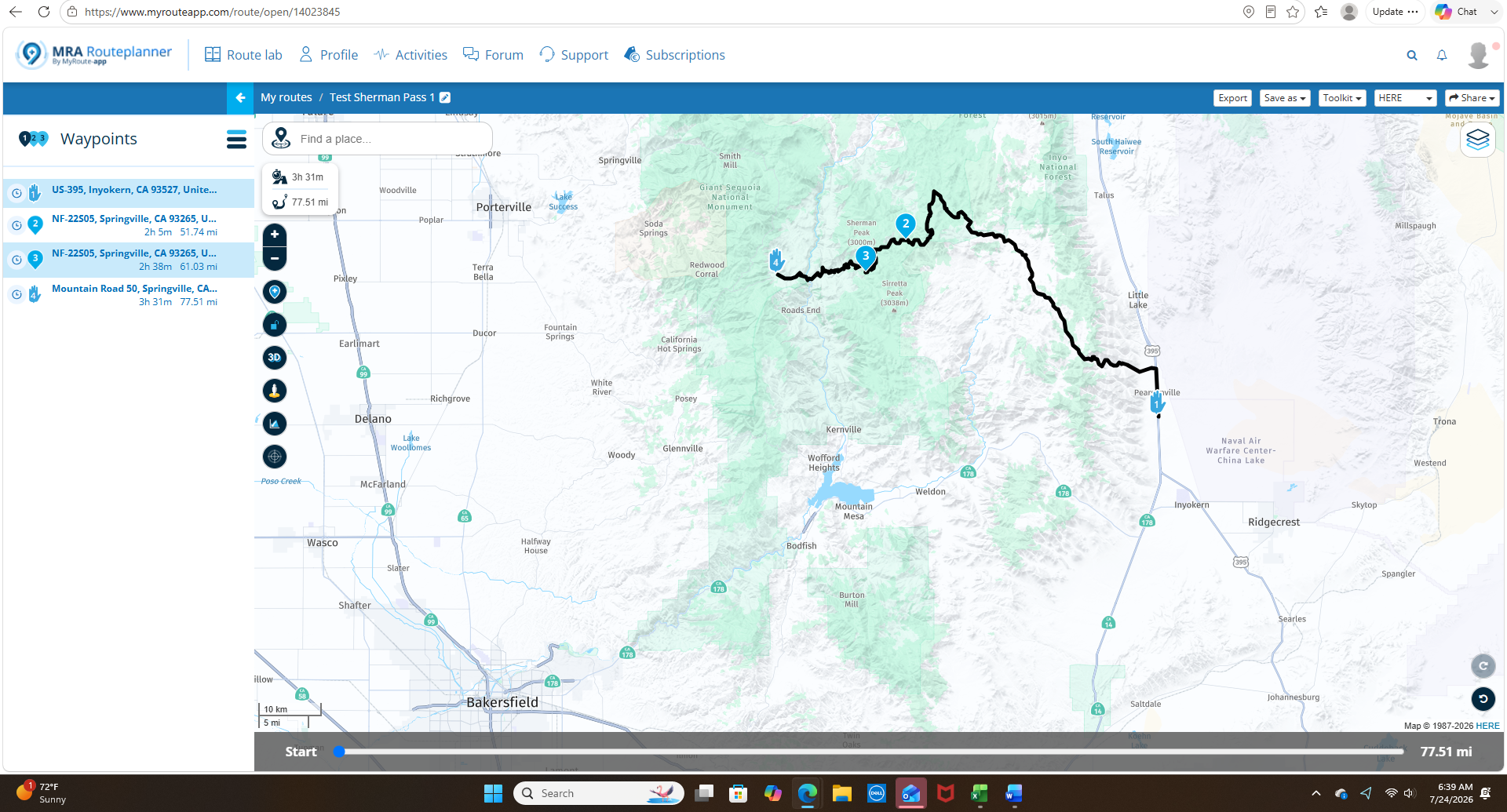

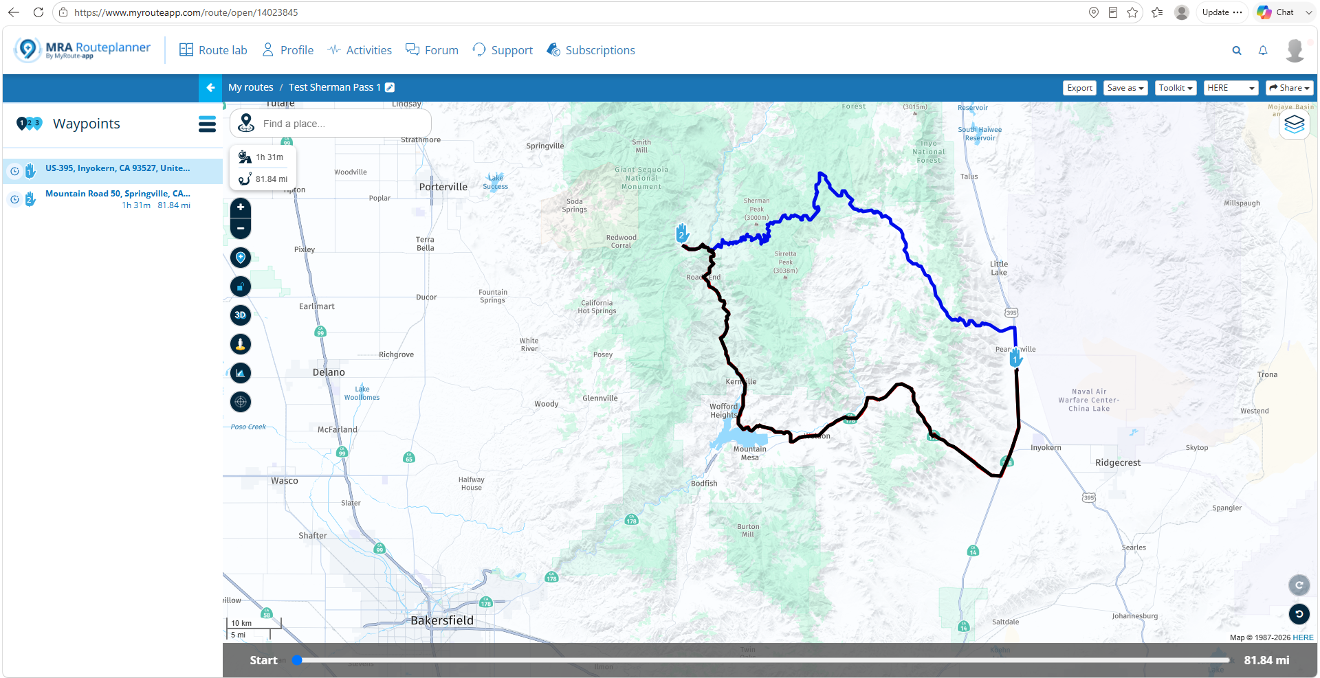

                      @Lenny-O-R-Xpert Lenny, I think it's simply a difference between how the respective MRA HERE and other base maps calculate the route. HERE has a preference for calculating across a more major route when available. You can see the same bias in a calculated route crossing the Southern Sierra in California:
                      Adding additional shaping points gets you the desired results:
                      In general, it's always best practice to overload shaping points in more rural areas. Especially if the route is going to be exported to a Garmin device that has completely different calculation algorithms.
