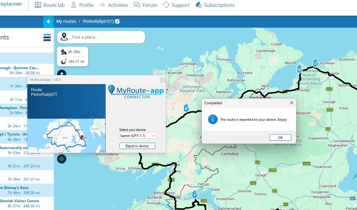

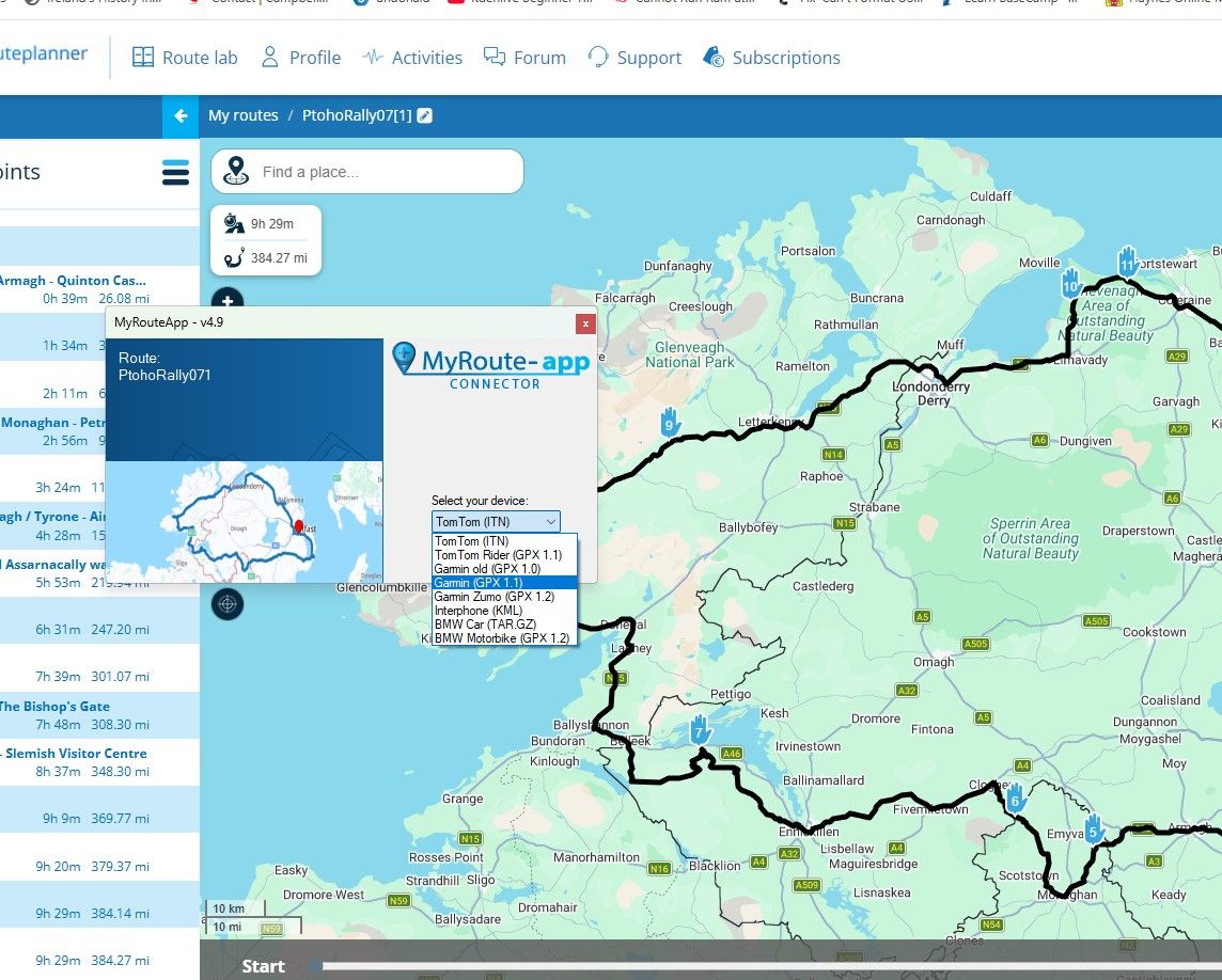

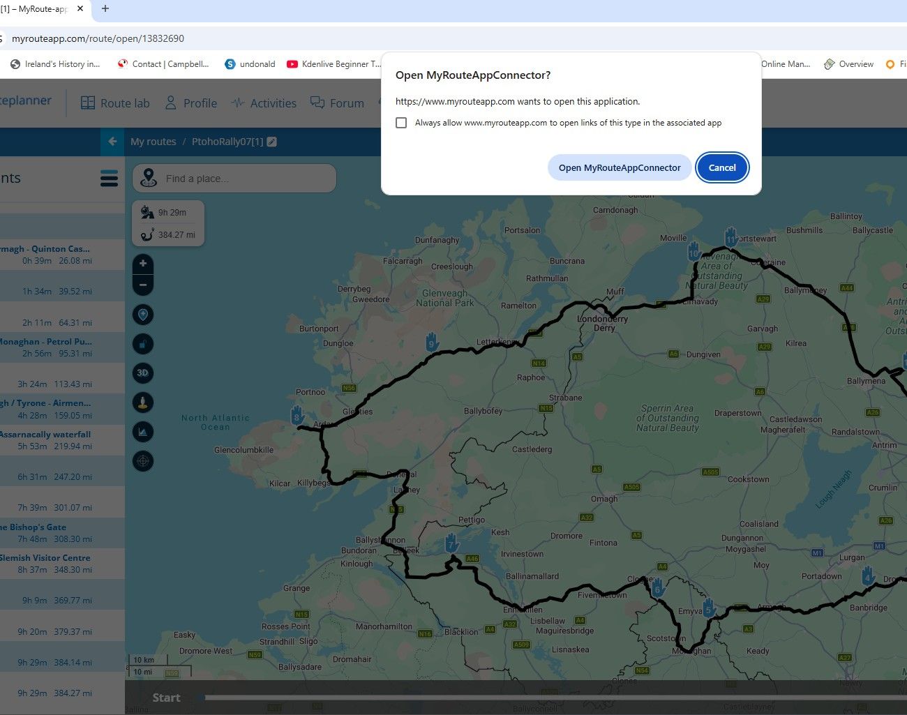

                This is what I get using Win 11 and the exporter this is not my preferred transfer route I use my phone and Garmin "Drive" usually and my "Daily" computer is Linux based so I just transfer files from MRA directly to the device.
                Click on open MyRouteAppConnector

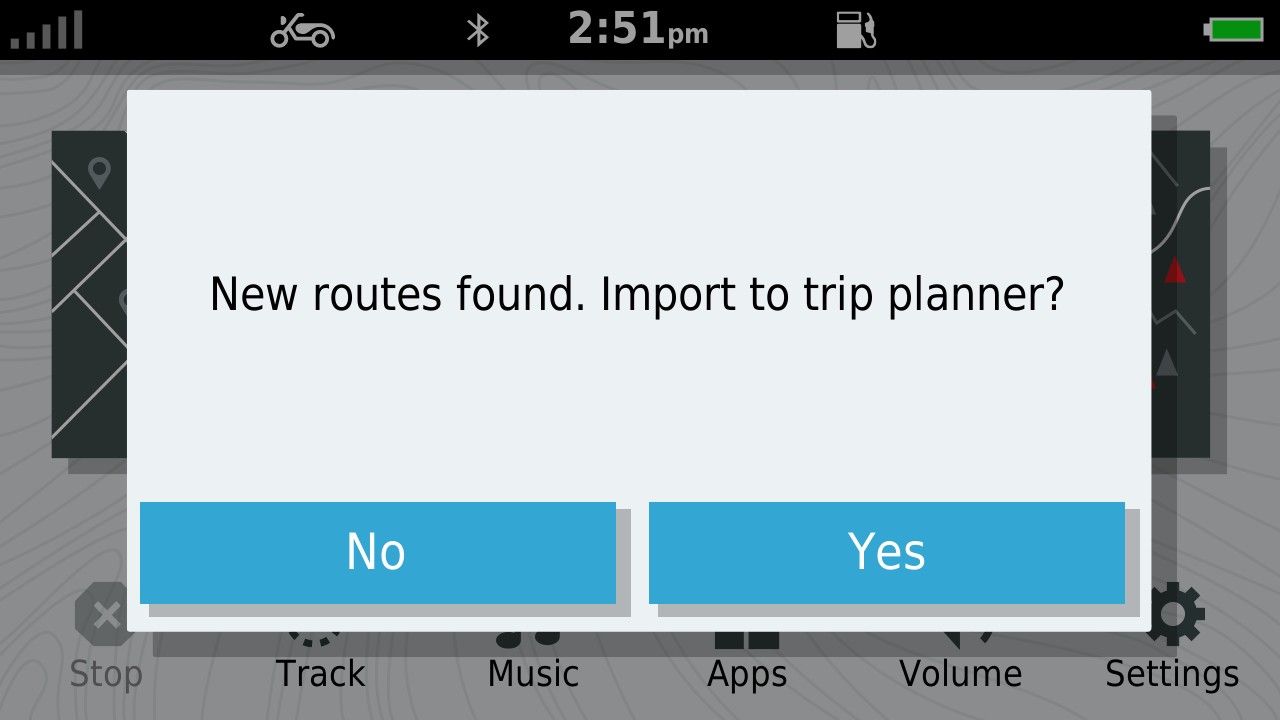

                In the unit when detached from the Computer you get this

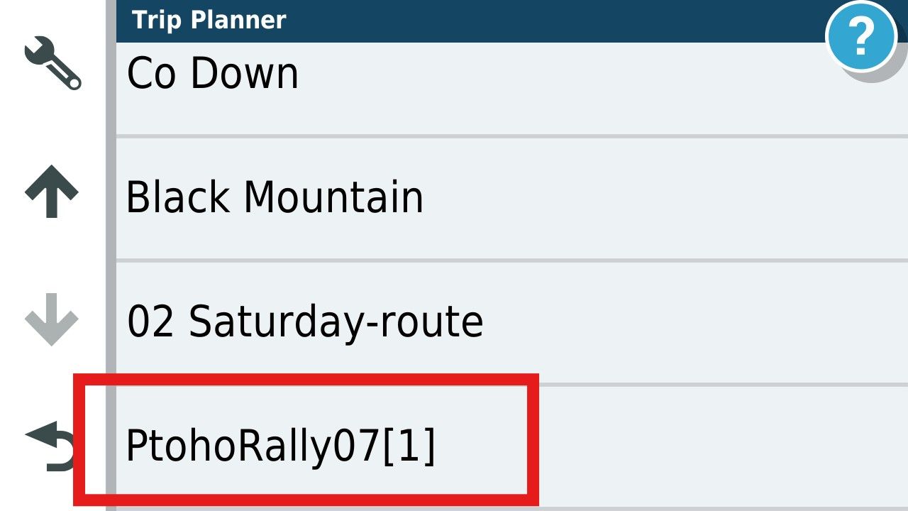

                When imported (and calculated in the case of GPX1.1 you get this in Trip planner.

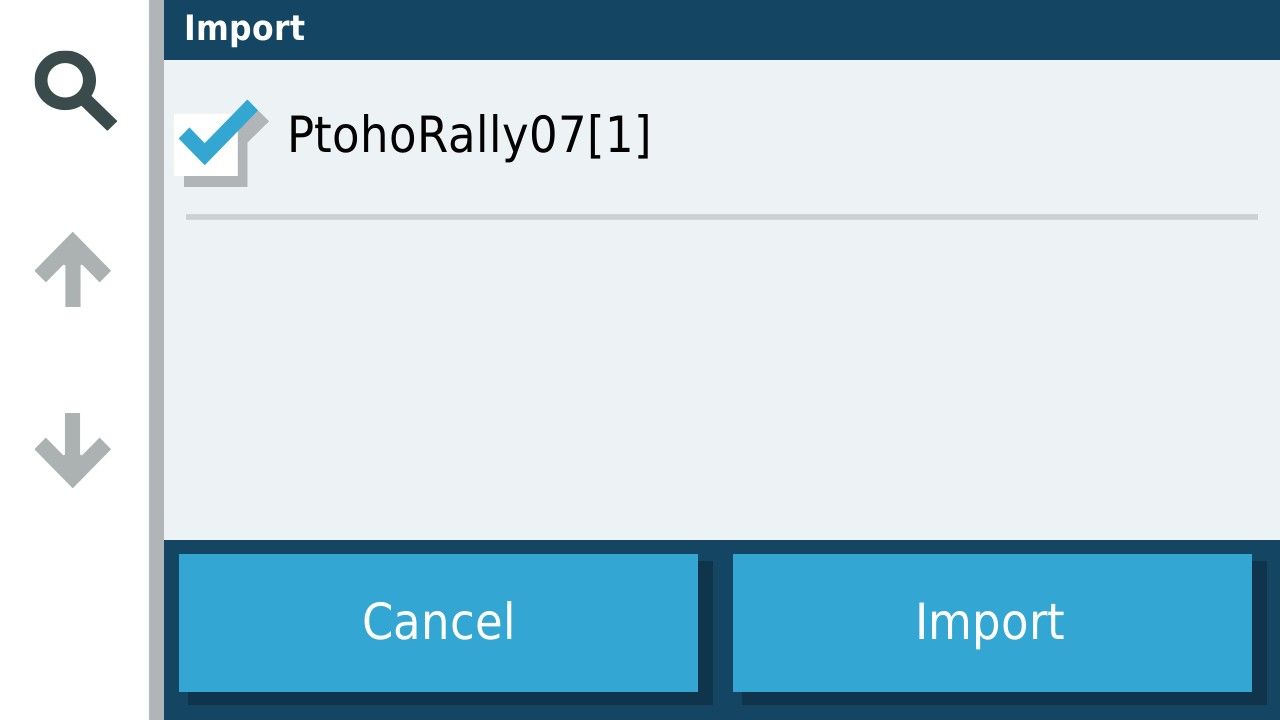

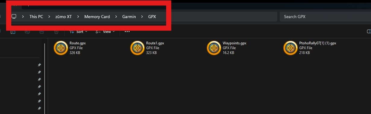

                  Alternately you can just plonk the downloaded GPX file directly on a SD card in the device and import the route and track. I always download the track for the ZumoXT and run the track under the route to see any discrepancies.

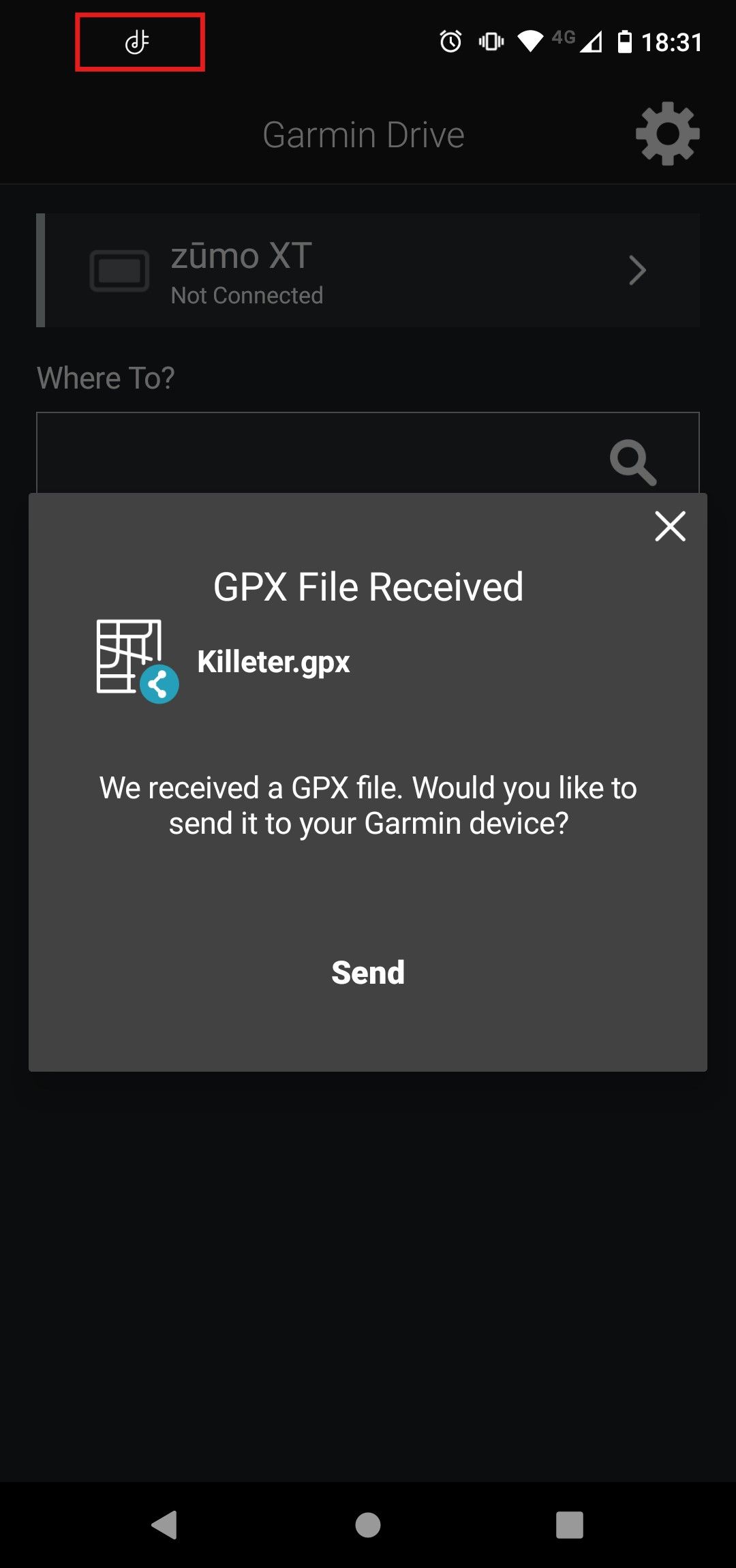

                    The easiest way is to transfer the file from your phone.
                    As long as the little Icon in the red square is highlighted your phone and device are connected and the file will send. For me this has been 100% reliable and a boon when using the XT and MyRoute app on tour. All that said I now navigate with MyRoute app and use my XT as a backup and to run tracks and proximity alerted POI's which I still have a use for and that MyRoute app is (understandably as its a niche requirement) not capable of.

                      as @Mzokk says the easiest way to transfer files to your XT is to open the MRA app on your phone & send the file to the Garmin Drive app,
                      it is simple & takes seconds & avoids any messing with cables or pc's
