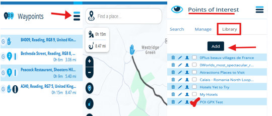

                  Hi @Kerry-Lebel not sure if this will fit exactly what your after but it may be a bit of a work around the issue
                  if you upload the GPX file with the route/track/poi's as normal
                  you should end up with a route or track of the path you want to follow
                  now in the route file click the 3 hamburger menu next to "Waypoints" to expose the menu & select the POI tab
                  on the POI tab select "Library" & then "Add"
                  if you select the same GPX file to upload I think this will load the POI's
                  you just need to place a tick in the selection box for the POI's to always show for this route in MRA
                  it will only be the POI name, no other details, as MRA does not cater for detailed info within POI's
                  MRA prefers to have detailed info in the Waypoint > Notes field
                  these POI's will not be exported if you save the route out of MRA as a GPX
                  they will only be displayed within the
