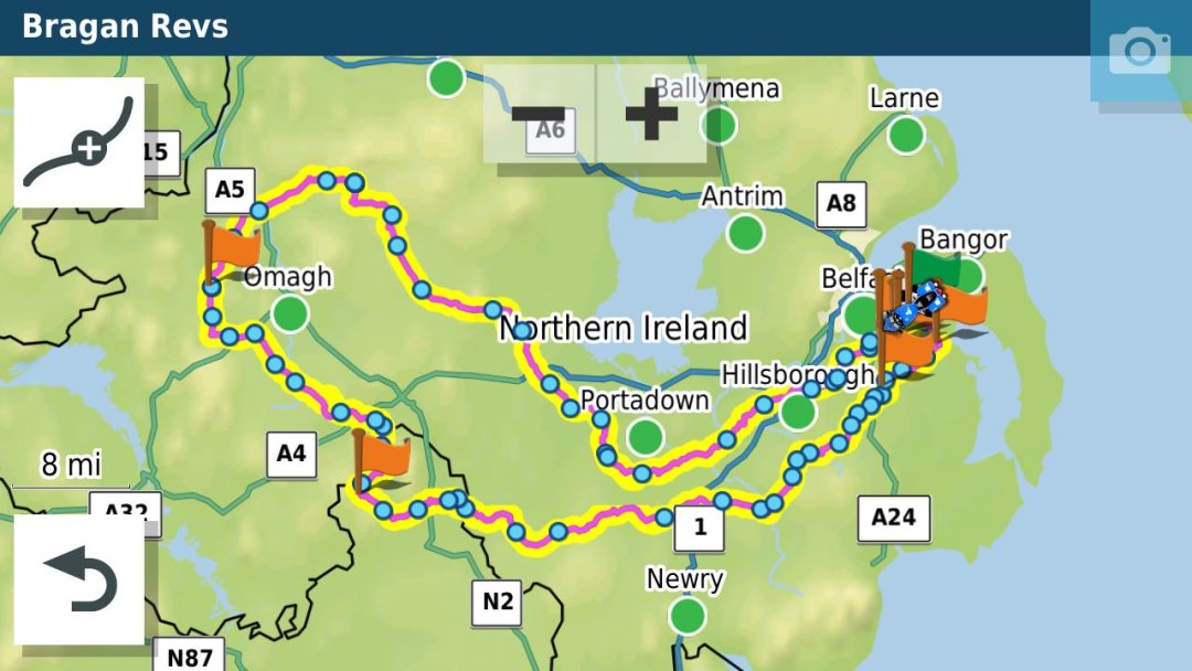

        I use MRA and a Zumo XT for a successful outcome using the XT I always do the following.
        1. In trip planner make all trips "Saved" rather than imported....you can do this in trip planner by starting the route and going back into trip planner and saving active route. This gives it a new name that you can change to something similar(but not the same as the original). Avoids routing issues Repeated U Turn behaviour if the route recalculates.
        2. Switch off auto recalculation or to prompted....see above and try as much as possible to navigate yourself back to the line
        3. Make track visible as well as route if you have to re-calculate you can see how different the new route might be. It shouldn't be if you put in enough shaping points. BUT
        4. If you are doing a long out and back route with different but close together roads make sure that you have at least a Waypoint at the farthest end of the route. This will stop the unit short cutting the route if you have to recalculate. In the old units they tried to get you to the next shaping point in the direction of travel...if another shaping point is closer to the XT it will just cut off a big lump of the route if you recalculate. For example in this route if you recalculated Just before where the 1 is on the map it would cut off the rest of the route and take you to Hillsborough if it was all shaping points and no way points which have to be gone through.
