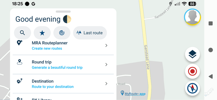

    When in landscape mode with the new update you can't see the full map using free ride all you see is the menu and no way to hide it.

      Correct, a dedicated free drive mode will be added later.
      For now you could long press the navigate button on a route to enable a sort of free drive 🙂
      This is default for walking / cycling.
      Note (hint): a route could just contain a random single waypoint
