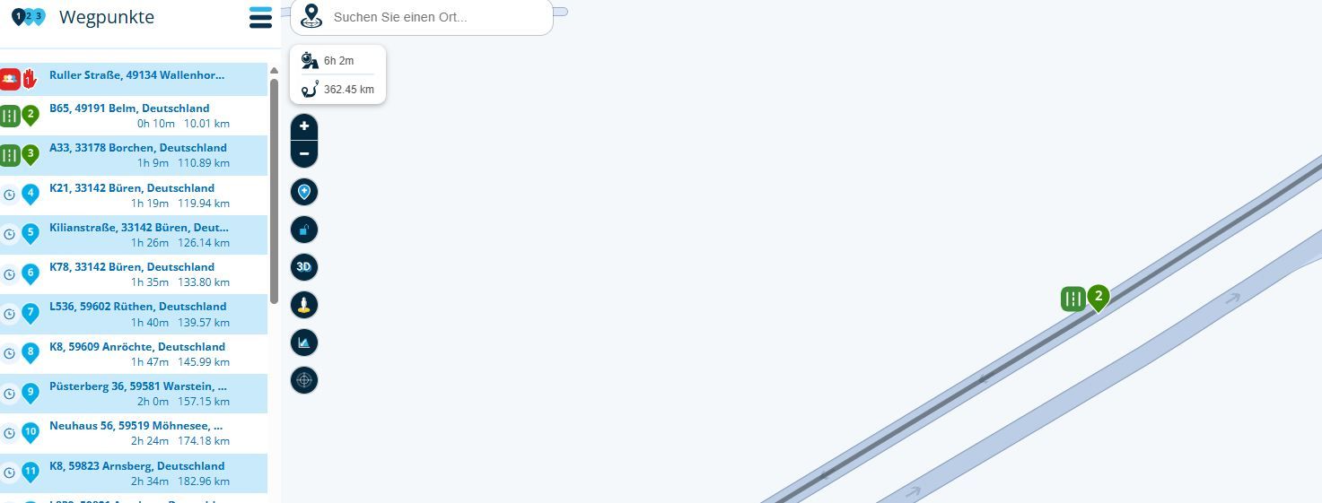

            Here is the route.
            https://www.myrouteapp.com/de/social/route/12338004?mode=share
            Thank you very much for your efforts.

              @Mopetenpit I've looked at your route
              I can't find anything wrong with it.
              If you really hit point 2, my guess is you did because the next point was then route point 3, there should not be any reason why you were guided of the motorway. Did you activate avoiding motorways in your settings

                  Hi @Mopetenpit thanks for sharing the route, like @Marinus-van-Deudekom I can see nothing wrong with it
                  I tried simulating driving the route, I had to split your route as I can only simulate a small section up to your point 8, & it works fine in offline mode
                  As soon as I join the motorway at point 2 it says point 3 is 63 miles away & the instruction for my next turn is also 63 miles, so seems to work perfectly
                  I don't know why you got a different routing, sorry could not help more
                  If you manage to repeat the error then I think the only way to find the answer will be via a support ticket & submitting a logfile of the problem
