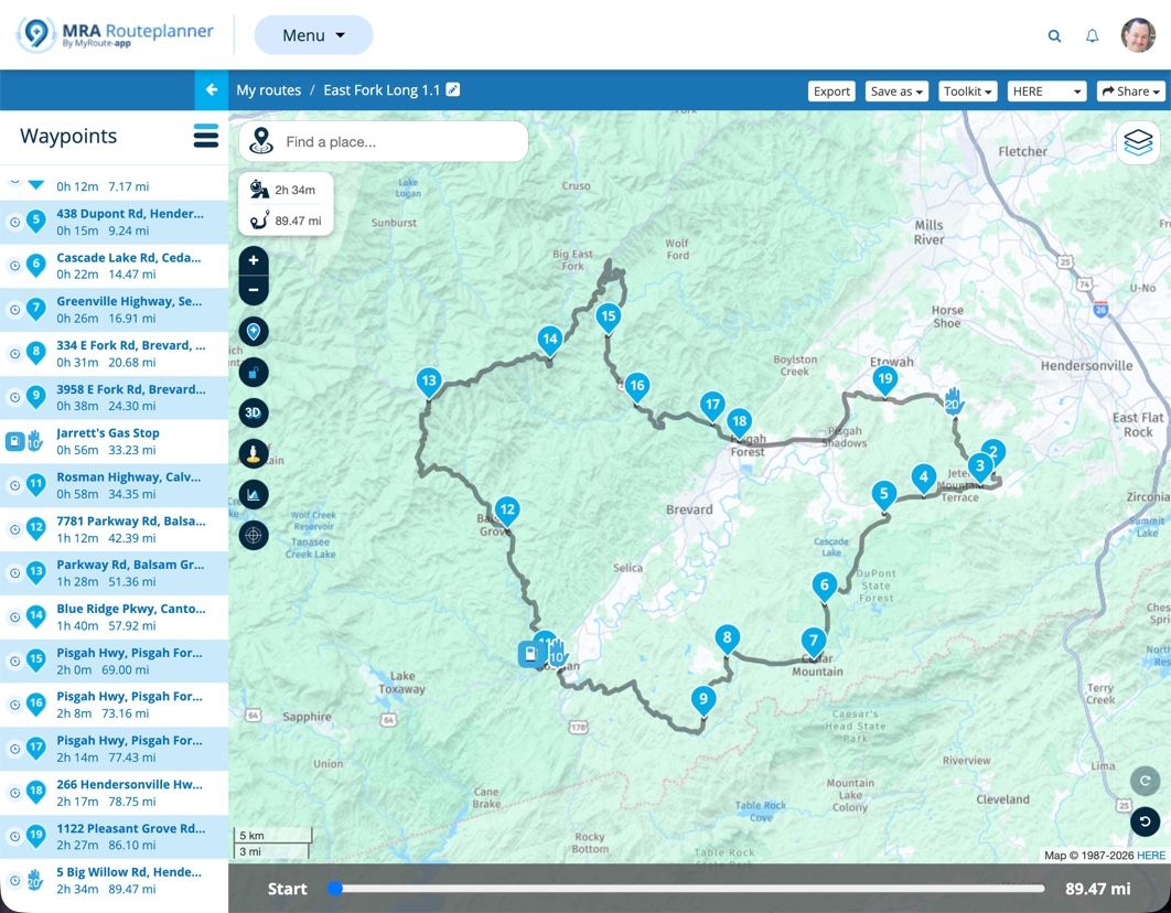

    In MRA, or pretty much any route creation program, you create two basic elements that will form the route and track. You have waypoint (aka via points, but we'll just ) and shaping points. Waypoint you must go to (either a stop or pass through it) unless you purposely choose to skip it, and shaping points are just that, their purpose is to solely shape the route. Here's an example of a simple route in MRA showing 3 waypoints (Start, Finish and a gas stop) and 17 shaping points that (try to) force the route to go where I wanted it to.
    When you export the route (save as and upload) to your GPS, whether it's in 1.1 or 1.2 format, the GPS takes the .gpx file, reads it and creates a route based on the information in the route section apply its own logic (shortest route, fastest route, etc) and that's the route that you see on your GPS. The track is also imported from the .gpx file, and it should always look exactly the same on your GPS as the route looked in MRA.

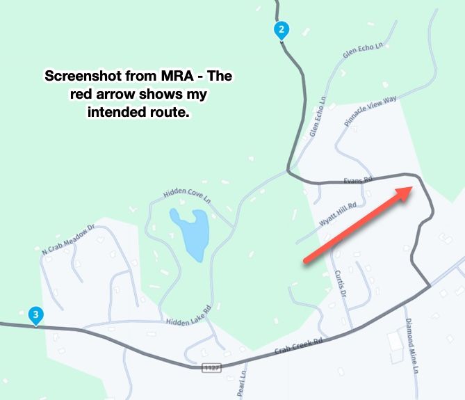

    Ok, here's a section of the route above shown in a screenshot from MRA. As you can see the route I planned goes down Evans Road until it meets Crab Creek Road.

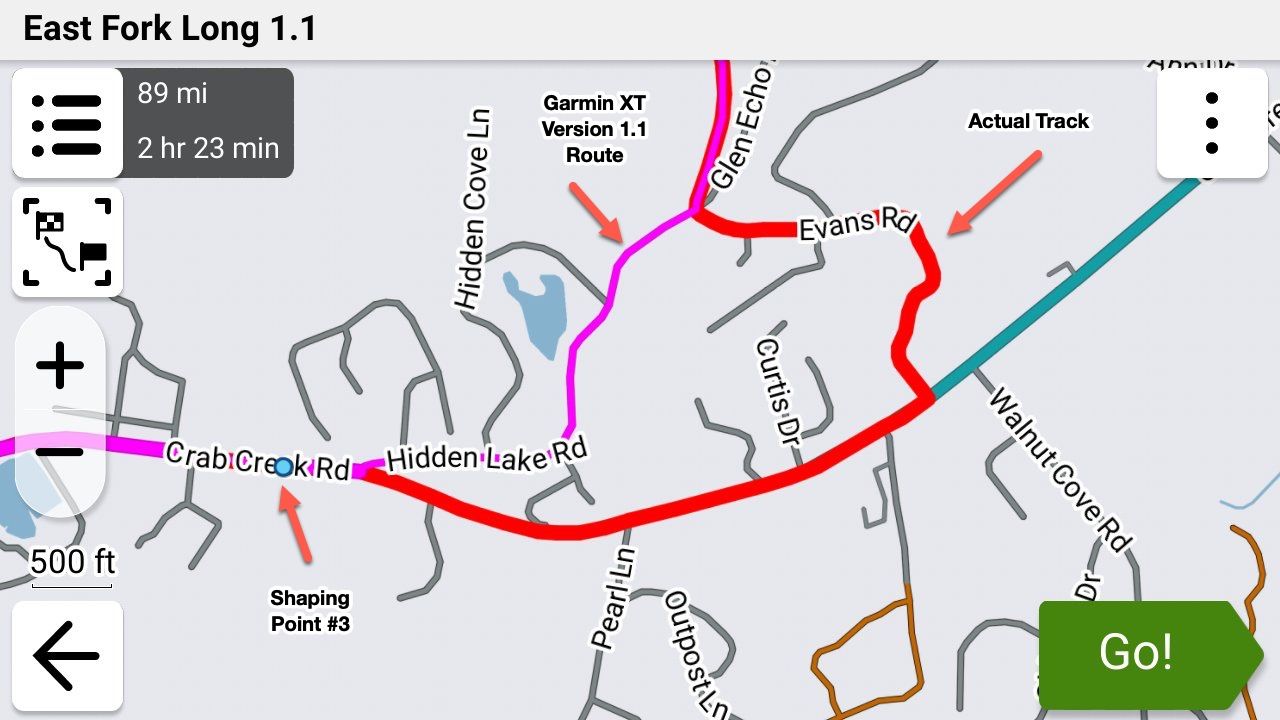

    So I exported this route in 1.1 format and imported into my Garmin XT3 and my navigation setting was set to "Fastest". The XT decided that "Fastest" (and it did the same when I set it to "Shortest") way between to take Hidden Lake Road instead (purple line) even though the track clearly showed that I intended to go down Evans Road (you can show the track and route simultaneously with the XT3 which I did here for clarity).

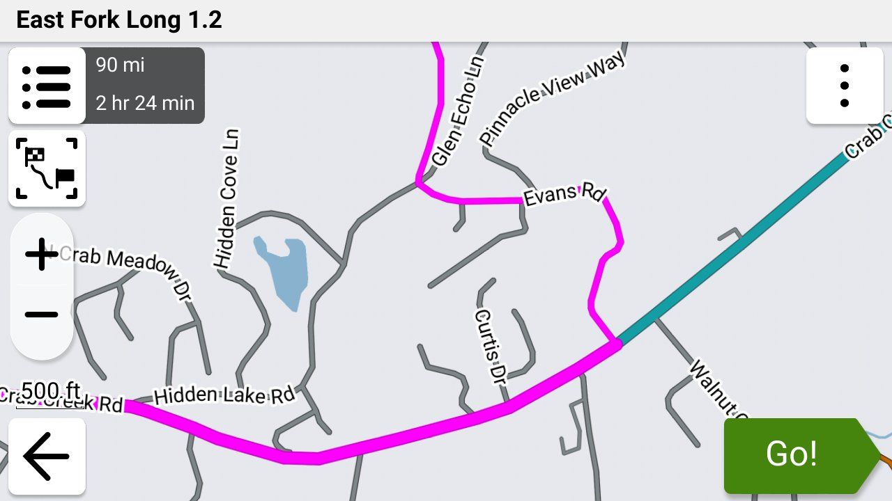

    Next, I exported this EXACT same route from MRA in gpx 1.2 format and imported it into my Garmin XT3. Notice two important things - the route followed what I was seeing in MRA, and there are NO shaping points.
    While this is a very small example of what happens during the Garmin's route creation with a gpx 1.1 file, on a large, complex route the Garmin can make a LOT of unintended changes. I have wound up on nasty gravel roads on a Goldwing, down back alleys, missed curvy sections that I wanted to ride, etc. etc. because of this issue.
