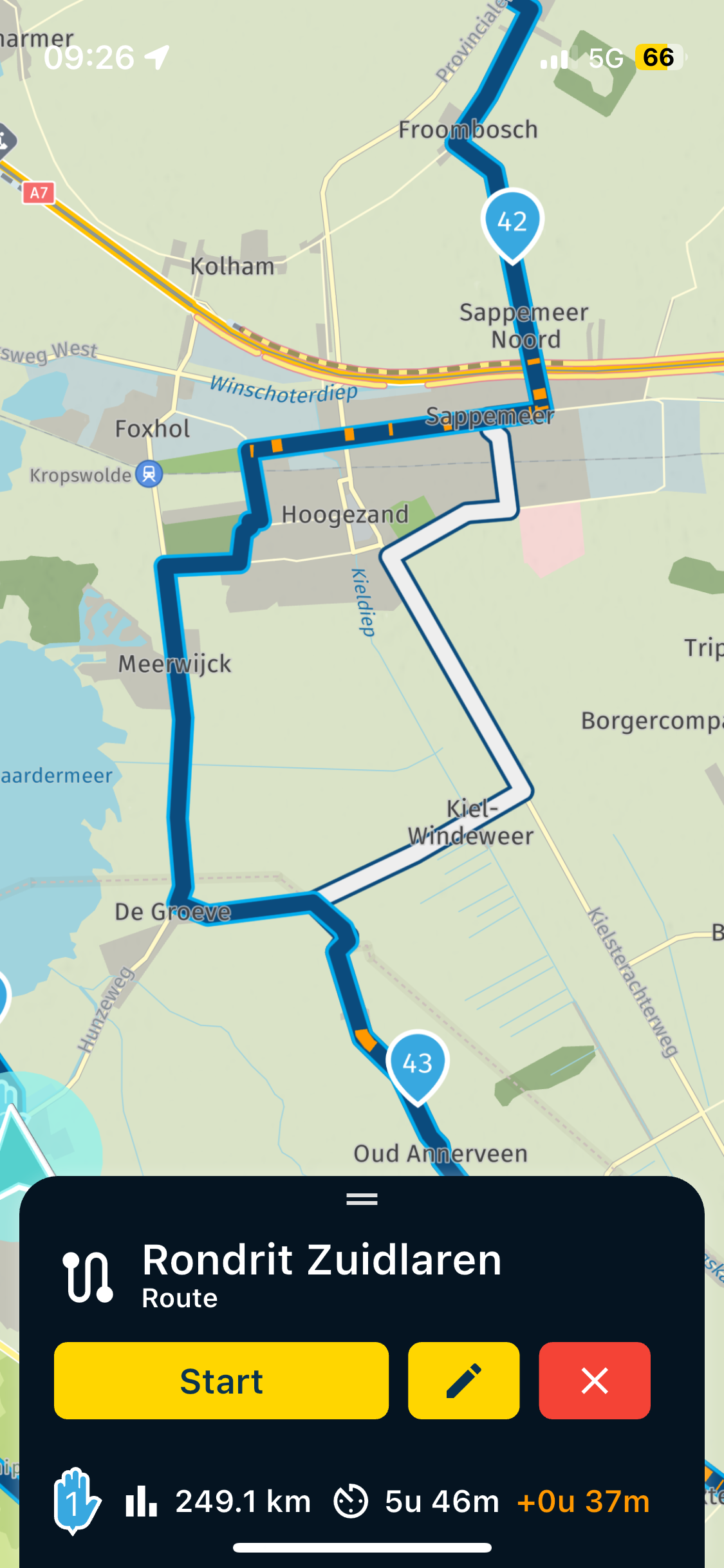

    Last weekend I drove a route from Zuidlaren to Stroe. And already when starting the route it shows a deviation. Why is that? When driving there the original route could be driven without issues.IMG_6082.PNG

          @infoevertkuiken.nl there could be several reasons
          one is that you are navigating online with automatic recalculation enabled,
          when the route has been loaded for navigation it has recalculated the alternative path as being more efficient
          this is possible I think because the route is poorly planned,
          after point 42 it is clear there are multiple paths to get to point 43,
          if a recalculation is done then it is possible any of the other routes could end up being the preferred route
          a simple factor that could change the preferred route could be something like traffic, if you have that enabled
          if you specifically want to follow the white path then at least one other point should have been added between points 42 & 43 to eliminate the possibility of the other paths being calculated

              Could the option 'fastest' or 'shortest' route in your navigation settings perhaps have an effect? When I try this with one of my own routes, the 'shortest' option under 'Route Optimization' does indeed influence it.
              Heeft de optie "snelste" of "kortste" route in je navigatie instelling wellicht invloed? Als ik dit nl. doe met één van mijn eigen routes, dan heeft de optie "kortste" bij de instelling "Routeoptimalisatie" daar wel invloed op.
