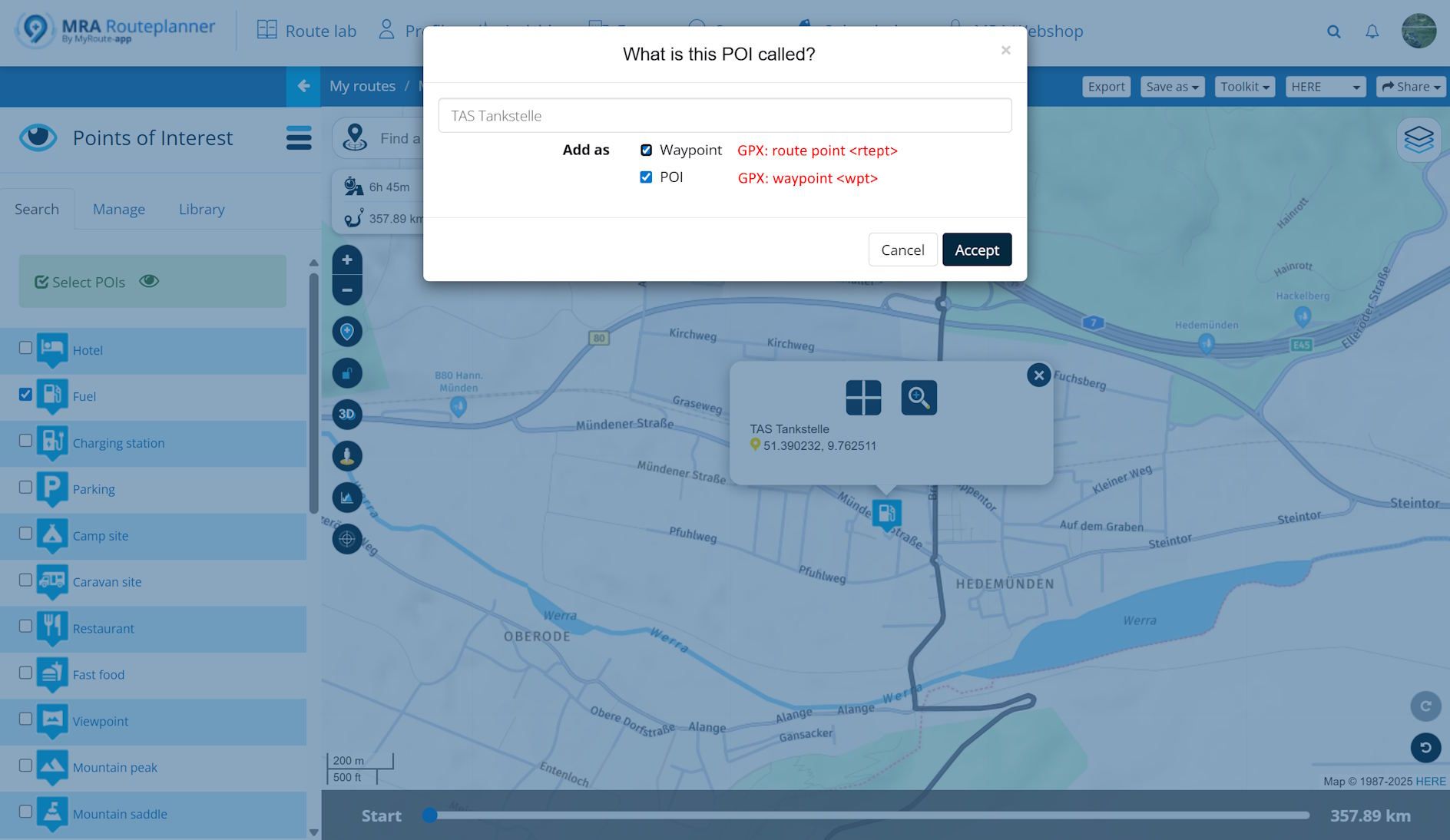

                #27
                For illustration, here is an example from my last planning session:
                In this route, I'm about to add a fuel stop. By opening the "POI > search" tab and selecting "Fuel", a gas station symbol pops up.
                I can now add this
                1. As a Waypoint, this will be part of my route
                2. As a POI, this will not be part of my route but a separate spot/point
                When saving as GPX, 1. becomes a route point <rtept> while 2. becomes a waypoint <wpt>

                  #28
                  @Martin-Wilcke that's incorrect. Option 2 will just add a visible point on the map and had no effect what so ever on the route. The RouteXperts add those POI's in every viapoint in the route. That viapoint is something important in the route like a castle, museum gasstation etc

                    #29
                    @Marinus-van-Deudekom said in Placement of waypoints:
                    That's what I said: 2. is not part of the route. What exactly is incorrect?

                      #30
                      @Martin-Wilcke indeed Martin, misread your post🤣

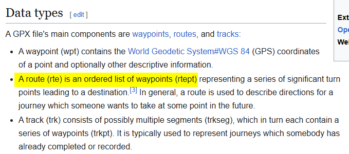

                        #31
                        @Martin-Wilcke said in Placement of waypoints:
                        No.
                        According to the GPX specification, both have the same data type (<wptType>), but one is a <wpt> and the other is a <rtept>. Same data type, different objects.
                        Yes.
                        Both have the same datatype because they are both waypoints...
                        And of course they have different node names, because the need to be treated differently.

                          #32
                          @Con-Hennekens
                          I'm aware of this description, and it's likely the root cause of all this confusion because it mixes up elements and types.
                          This becomes clear when you take a look at the schemas:gpx.jpg
                          <wpt> is an element, <rtept> is a different element. Both have the same type (<wptType>).

                              #34
                              @Martin-Wilcke, I am sorry Martin, but how things get a designation in XML code has little to do with how things are called in human language. I am discontinuing this meaningless discussion now.
