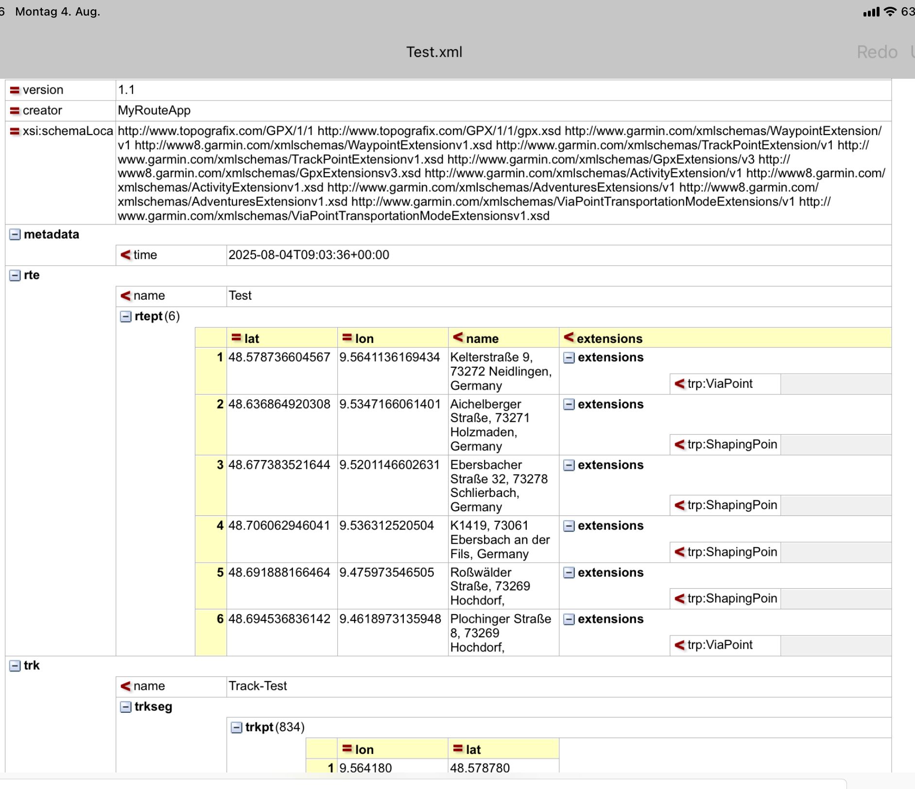

                        The export as GPX works perfectly for me. Using an XML editor (rename the file from .gpx to .xml beforehand), you can view the contents of the file. Everything is available.
                        If the GPX file only has one line of text, then the export from MRA temporarily did not work properly.
                        Here is the link to the test route.
                        https://www.myrouteapp.com/en/social/route/11051821?mode=share
                        And here a Screenshot from the xml editor.

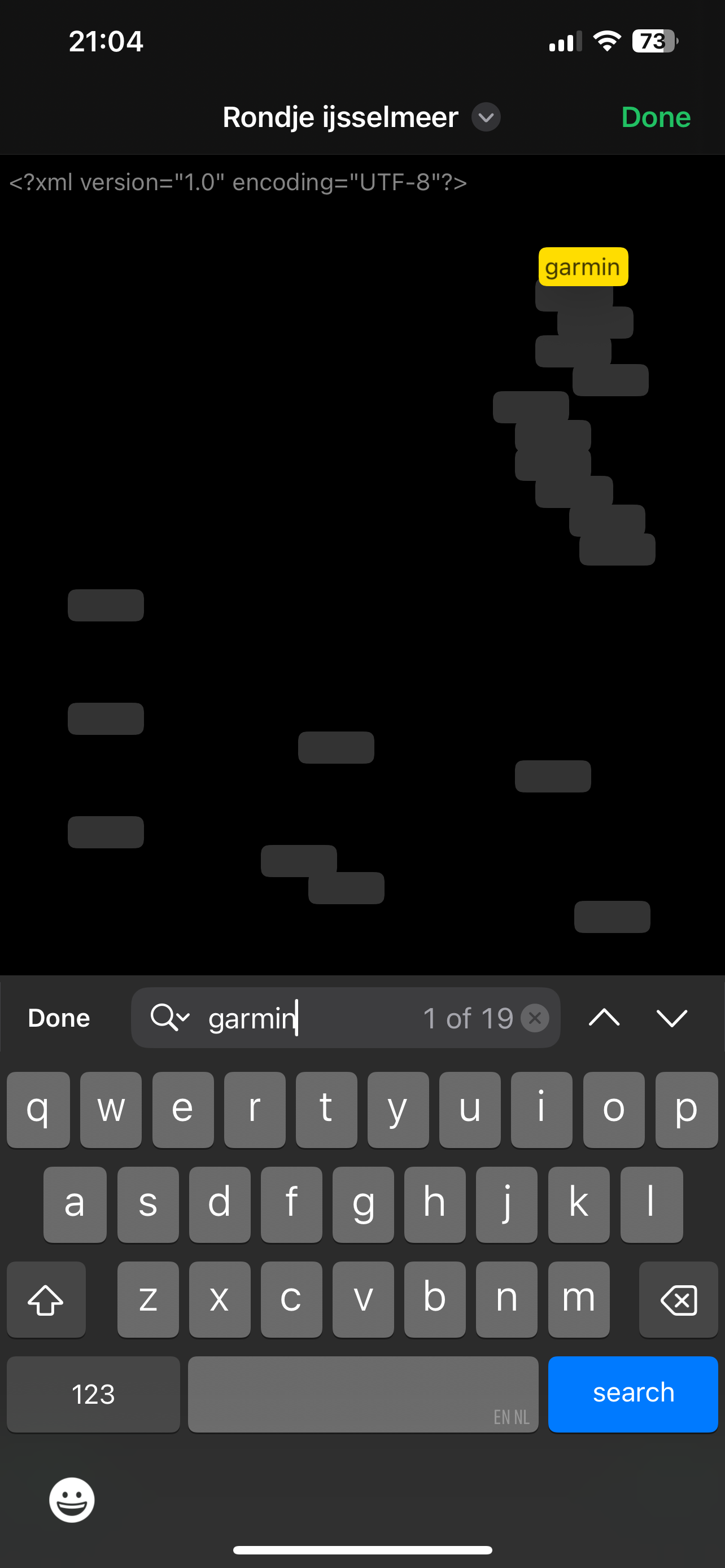

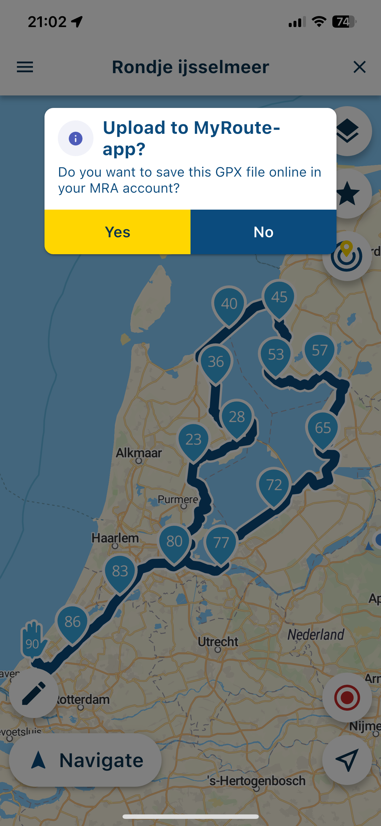

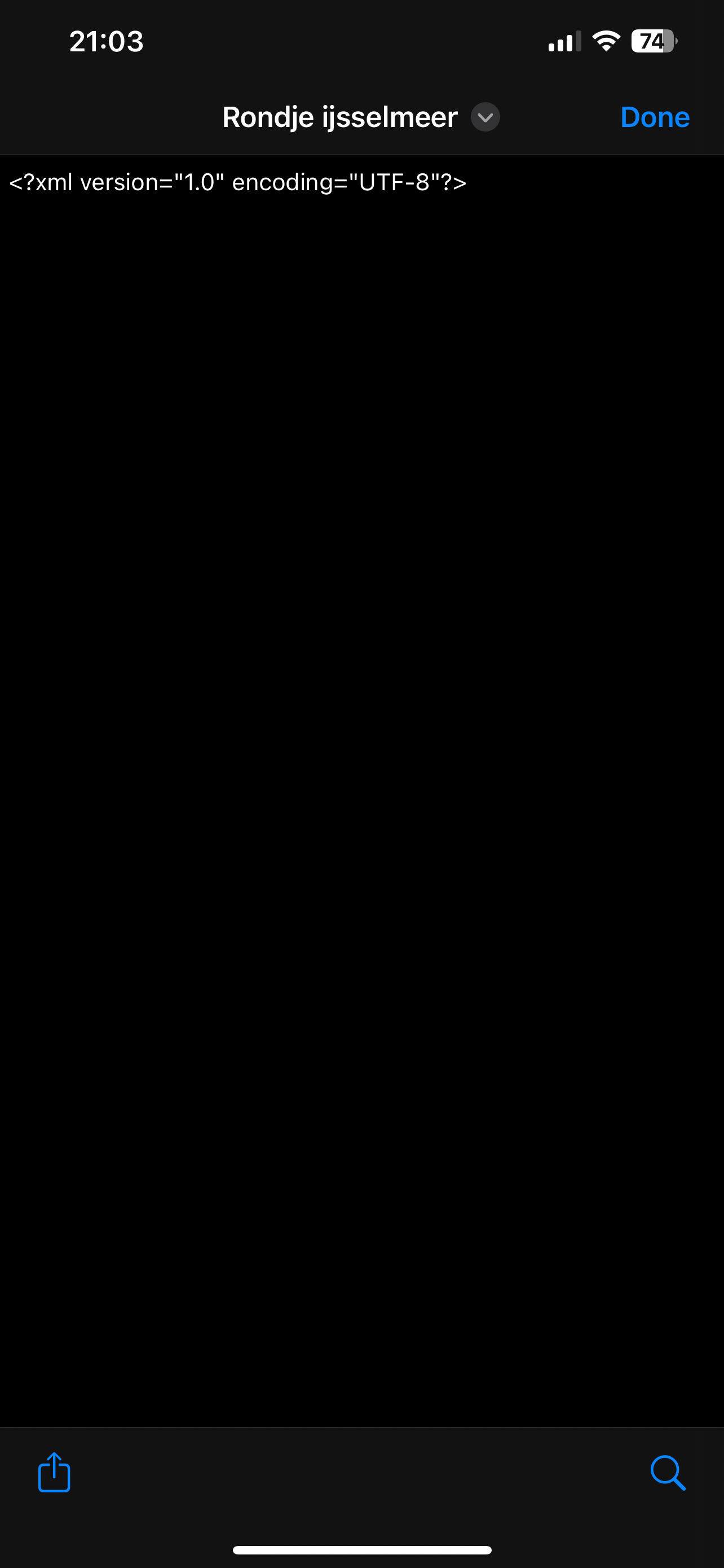

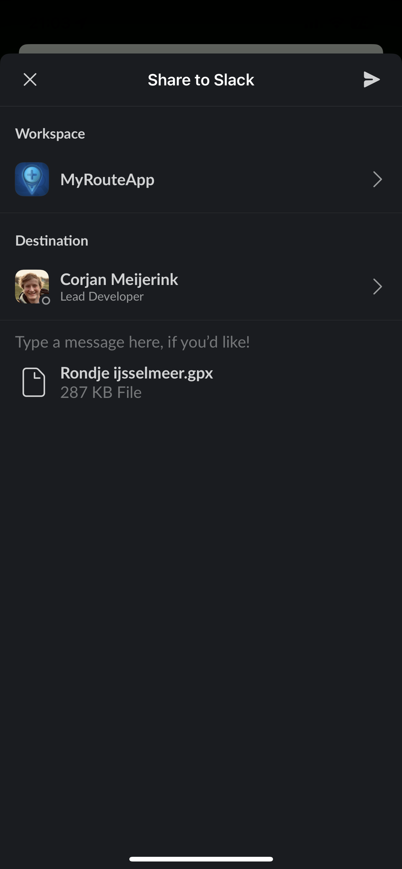

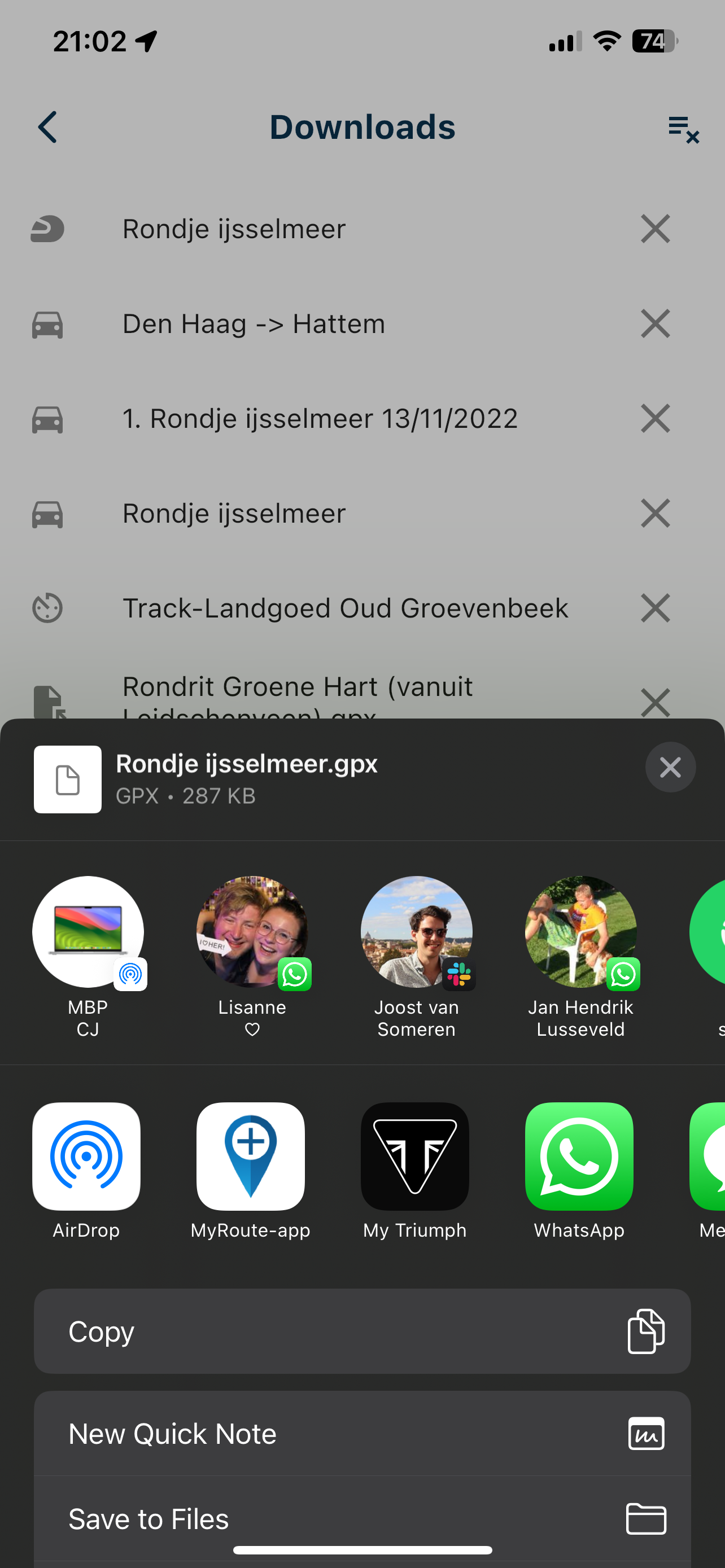

                                The file isn't empty, it appears empty! I have absolutely no clue why on earth this is happening but it seems to be a visual glitch on the phone.
                                Sharing file
                                See the file size, that isn't "empty" 🙂
                                Share to whatsapp
                                Is it empty?
                                Open file in whatsapp
                                Definitely not empty! Just not visible.
                                Another platform? Tried Slack
                                Has a correct file size!
                                Appears empty!
                                It isn't!
                                Open in MRA?
                                Definitely correct!
                                Conclusion
                                No idea what is going on but the file is definitely not empty.
                                It seems a file preview issue on the OS. The issue appears to happen at a certain file length?
                                Now I can sleep well!
