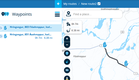

          1. create a new route in the web planner with 2 points, name the route “New Route2” because it has 2 points

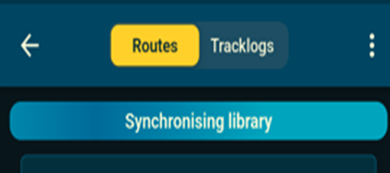

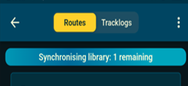

          2. close the web planner & go to the mobile app on the device, the device is online

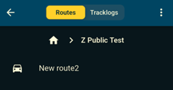

          3. select the Routes & Tracklogs button & the blue sync bar appears “Synchronising Library : 1 remaining”
            212a791a-2387-4c80-a4e8-0f9d04fcd76f-image.png 5971a58b-8e19-47ca-be15-36c4b7ad71df-image.png

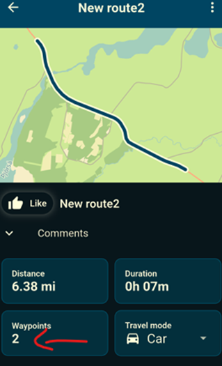

          4. all is good, New route2 is synced & when I select the route it has the correct number of points

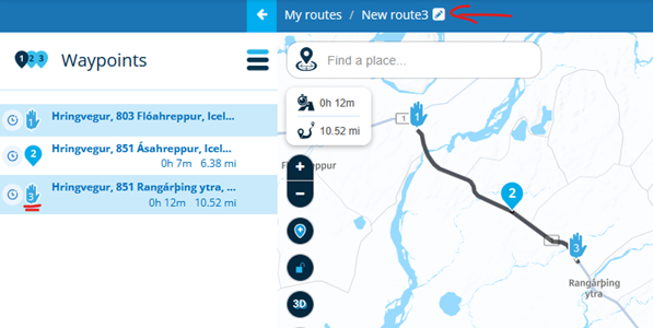

          6. On the web planner open the route “New route2” & add an extra point to the route, the route now has 3 points
          7. At the same time edit the name of the route, change it too “New route3” to show that it now has 3 points (this is not necessary but it helps illustrate the problem)
          8. close the web planner & go to the mobile app on the device, the device is online
          9. select the Routes & Tracklogs button & the blue sync bar appears “Synchronising Library”. Note it does not say “1 remaining”
            cca5931e-a7df-44bc-886f-79df7be402a7-image.png 357f2ef5-0015-4085-aa99-b8aab4cebf9b-image.png
          10. DO NOT open or edit or try to navigate the route, if you touch the route it will synchronise because the device is online. It appears as if the route has synchronized because the new name “New route3” has appeared, DO NOT open or edit or try to navigate the route

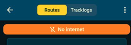

          12. take the device offline i.e. disconnect it from the internet / turn wifi off / put it in airplane mode
          13. go to the mobile app on the device, the device is offline, select the Routes & Tracklogs button
          14. a synchronisation is not possible because the device is offline as shown by the orange bar “No internet”

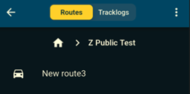

          15. Select the route “New route3”
          16. & surprise what do you see!
          This is supposed to be a route called “New route3” but when it is selected it shows the name of the route is “New Route2” & it only has 2 points
          It is the old original route, the route & it’s data has not been synchronised,
          all that was synchronised is the name of the file "New route3" in the routes list
          BlackView BV7100, Android 12
