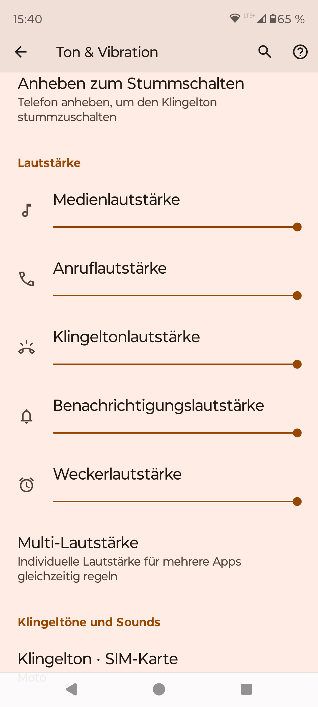

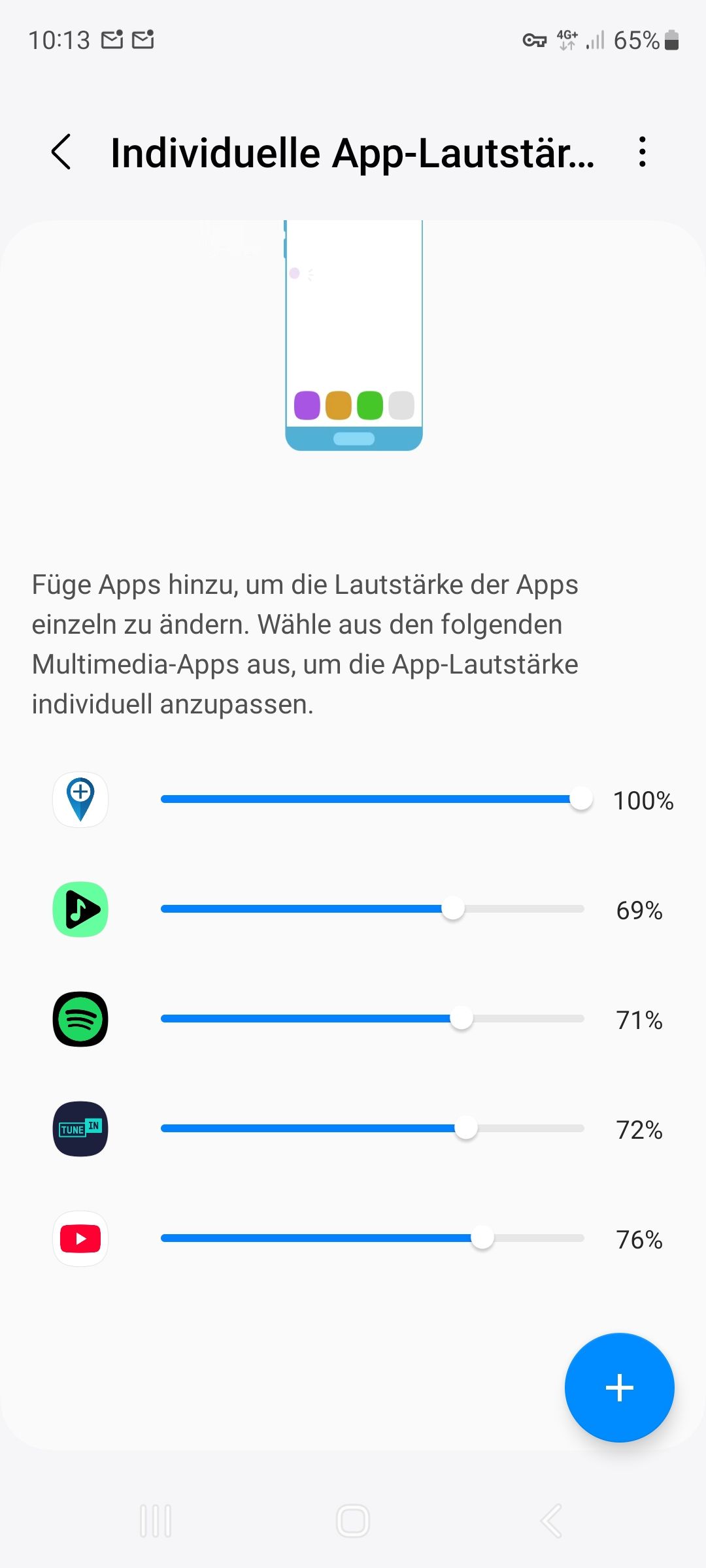

            @Con-Hennekens Hello Con,
            Even with the volume control in the MRA app set to maximum, I couldn't hear any navigation announcements.
            Only when I set the media volume to maximum in the Android phone's "Sound and Vibration Settings" could I hear the navigation announcements again.
            In other apps, the volume can be adjusted independently of the Android system in the "App Settings."
            I would welcome this option in the MRA app as well.Screenshot_20250630-154018.png Screenshot_20250630-154404.png

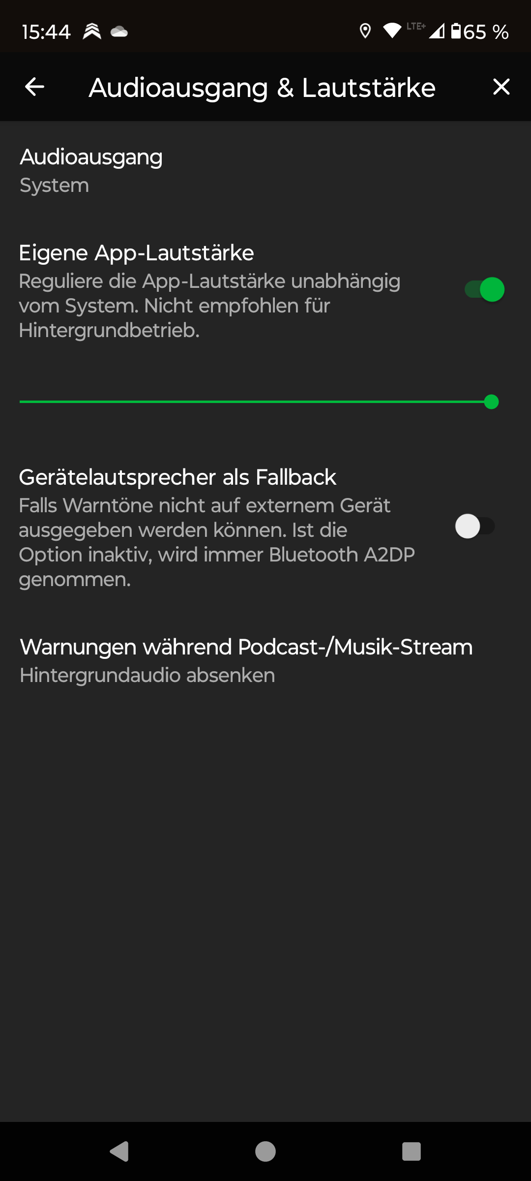

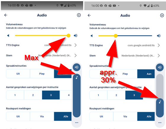

              @Peter-Zehentreiter, When I change the slider of the in-app volume setting, the OS system Media Volume changes accordingly. It is one and the same sound channel. When I change that slider while a BT headset is connected. The smame slider does affect the BT volume, just like what happens with the volume up and down buttons. Even the volume change graphic from Android itself is displayed over the app...
              And when you use the volume buttons to change the volume, the slider in the app changes accordingly, and in menu you show above the media channel is the one changed. So to me, really, the in-app slider has no function at all, since everyone uses volume buttons, much easier.

                            @Con-Hennekens said in Voice Navigation anncouncement too quiet:
                            It would have been ok to have a boost function and really boost the audio over the maximum threshold.
