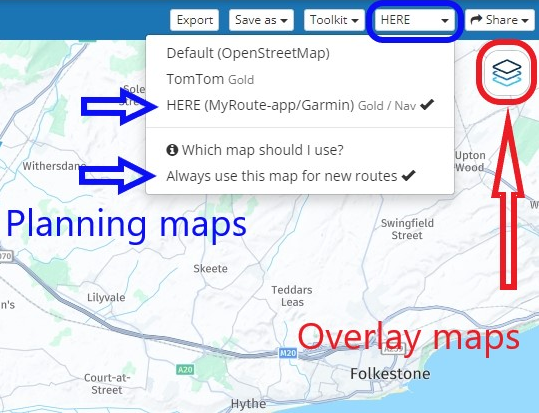

        @Michael-Doherty-0 As other have said, the issue you see is possibly because you are planning your route using the planning map from OpenStreetMap.
        It is important to use the correct planning map for your device.
        Each planning map comes with its own set of algorithms embedded within the map data to calculate which roads to use.
        The algorithms are unique to each planning map.
        So as you say you are using and Android phone I assume that you will be using MRA Navigation Next to navigate, therefore you should use the HERE planning map.
        After choosing the HERE planning map you can also click Always use this map for new routes to set the HERE map as your default planning map.
        All new routes will be now be created using the HERE map.
        The overlay maps are separate to the planning maps and have no effect on route calculations.
        Think of them as clear sheets with extra information on them that you place over the top of the planning map.
        The planning map underneath does all of the route calculations.
        So choose your planning map and then you can use any of the overlay maps.
        If you do not see the same blue menu bar with the planning maps that is shown in my screenshot, click Page menu and all of the same options will be available to you.

          @Rob-Verhoeff no Google maps

            I'll try Here maps in the future. My go to maps is usually google due to the better info about attractions and roadside services. I appreciate the feedback I'll give that a try. Hopefully MRA does some tweeking in the future so Google maps works better in planning routs here in the USA.

              I use the Here map for general planning and then use the Google Map overlay (and sometimes the Michelin Map overlay) for POI's, fuel stations and scenic routes.

                google maps is only as overlay. maps options are osm, tt and here. best is to use here.

                  Read the explanation of @Nick-Carthew Google Maps is just an overlay and not a planningmap!
