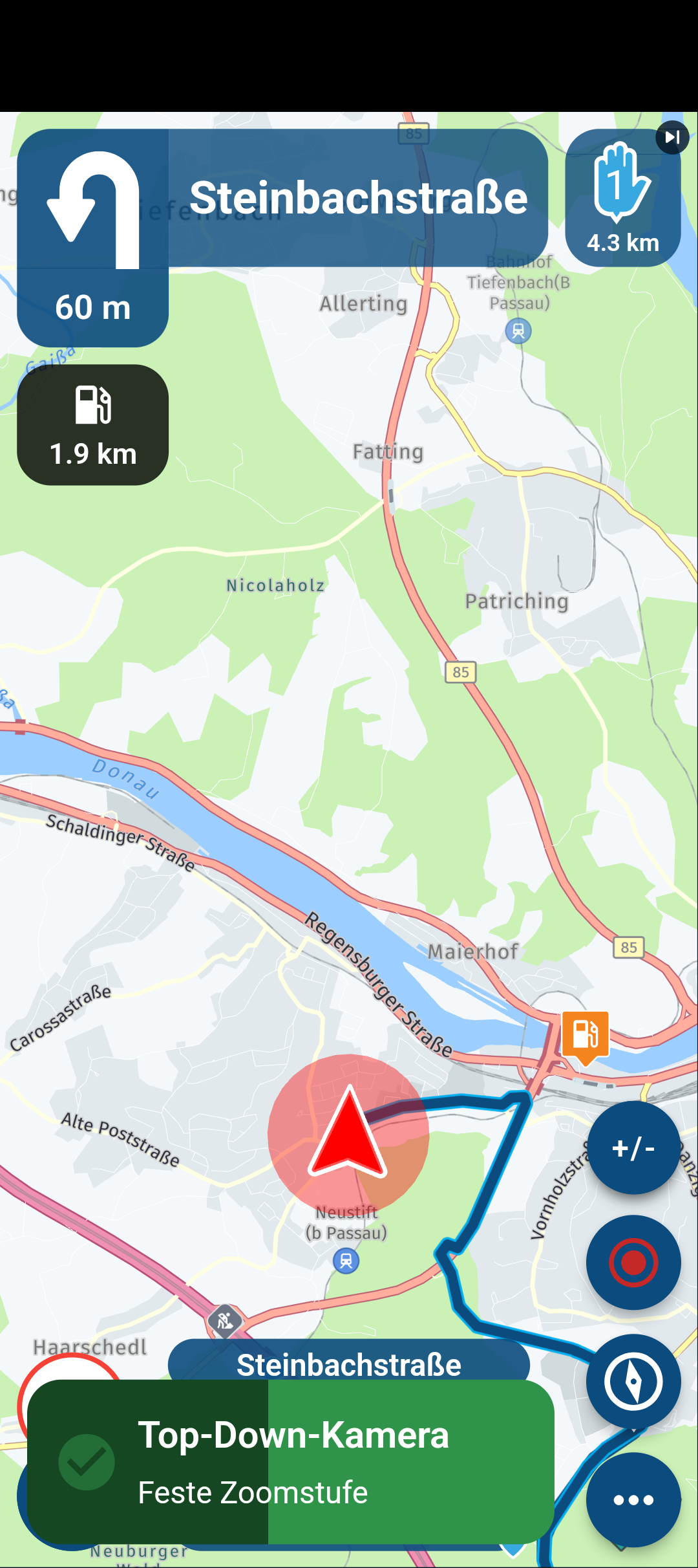

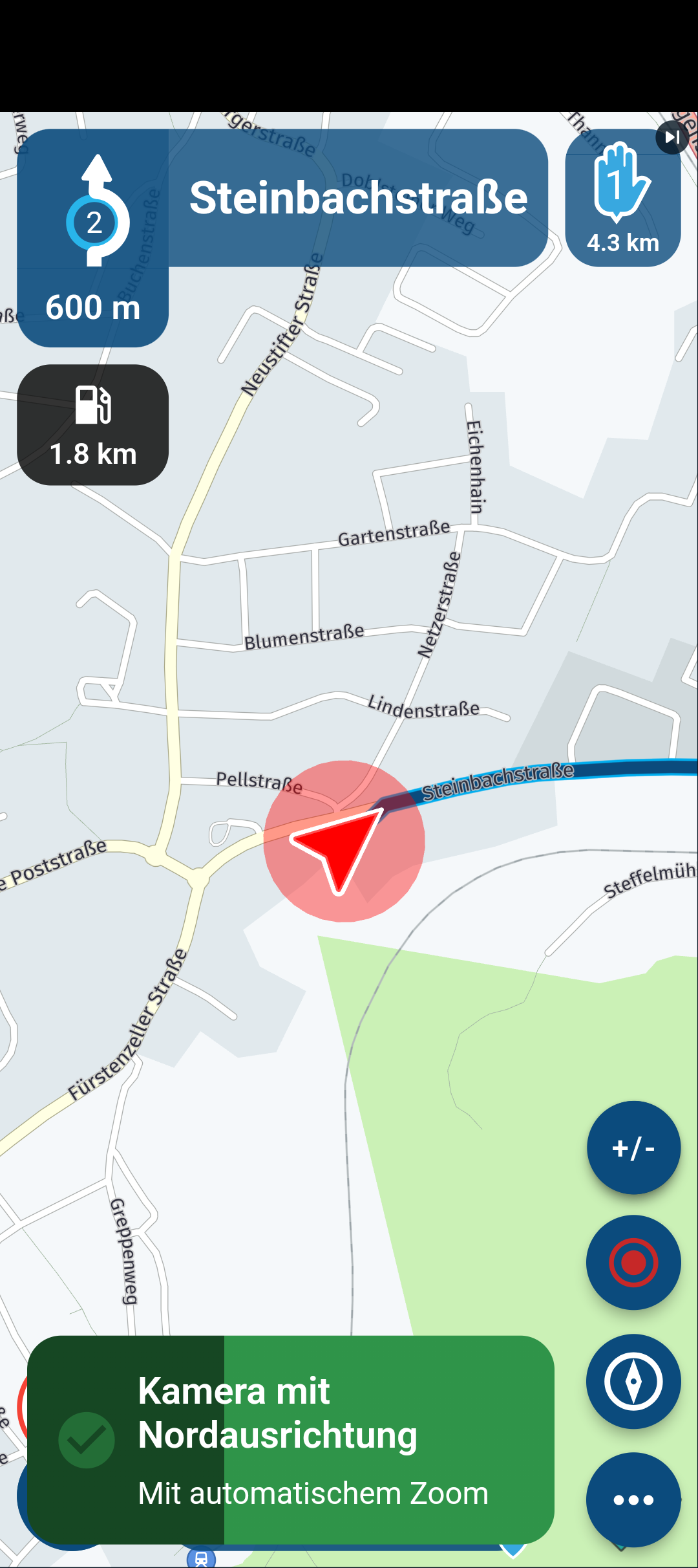

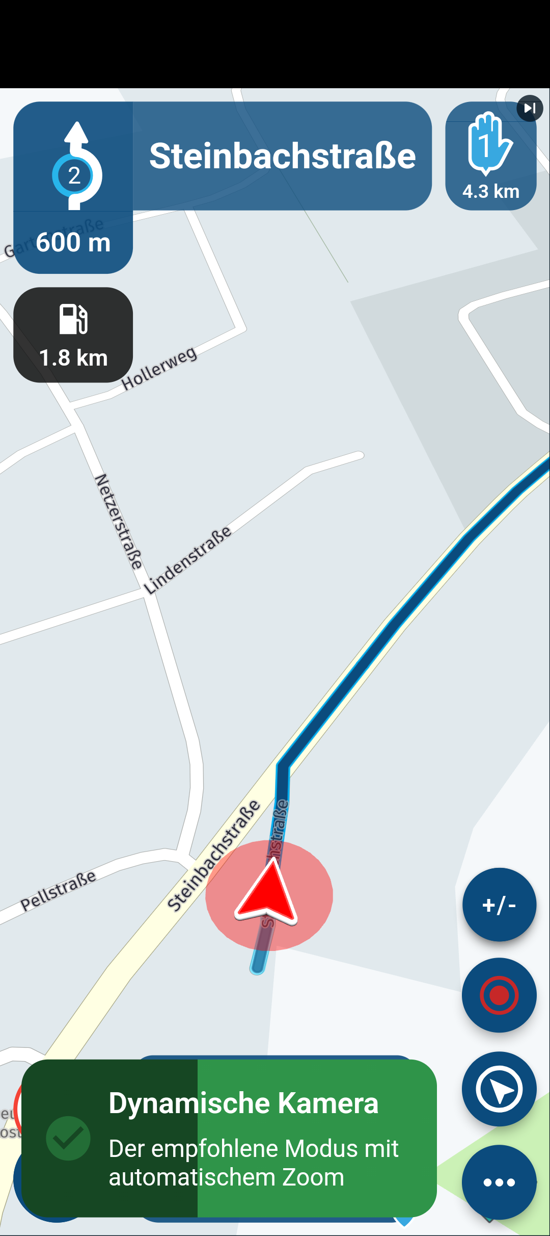

                              @Inge-Bakermans Press the compass sign
                              "during navigation mode" and watch the pop up showing the current mode.Screenshot_20250530-131816.png Screenshot_20250530-131829.png Screenshot_20250530-131843.png

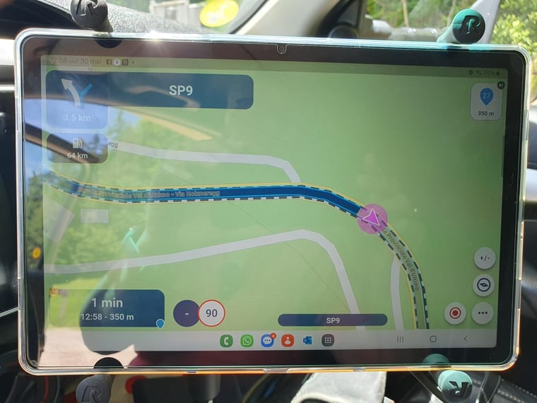

                                  #16
                                  Corjan, dit is wat ik zie.

                                    • Inge Bakermans Inge Bakermans
                                      #18
                                      @Inge-Bakermans that for sure is not dynamic. Indeed tap the compass to switch to it 🙂

                                          #20
                                          Am on the road so my apologies for the late reply. have indeed been tapping the compass and have it now way more zommed out - just like I like it. Thanks guys for the help.
