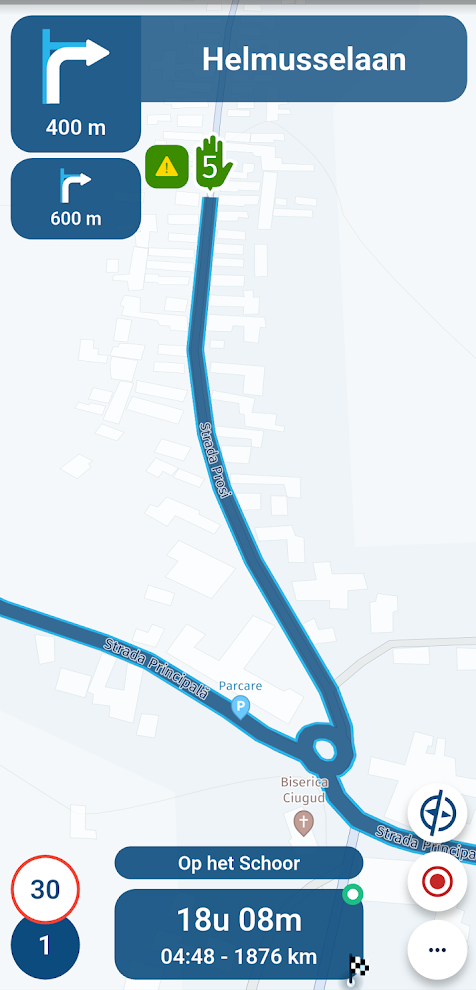

    This lines have not appeared until now, so how do I make them dissapear ?

      @Adrian-Avram it is the original plotted route

        @Adrian-Avram you have to go to settings and turn off (show original route).

          No, it's not, because the road goes over the houses ...
          I am guessing its a Here map issue.

            Thanks ! Turned it off and is ok now.

              @Adrian-Avram, Not showing the original route will disable it showing of course, but the root-cause of the problem is using tracks (or navigate routes as tracks) in offline mode. By disabling offline mode you will get a more accurate conversion of the route to track.

                @Con-Hennekens I navigated a 6 waypoint route created on MRA using the Here map (not a track). I used the online mode (not offline) and "Navigate Route as a Track" function was disabled (never used it).
                So my best guess it's a Here map issue.
                https://www.myrouteapp.com/en/social/route/11151375?mode=share
                you can see the street at Waypoint 5.

                  @Adrian-Avram, this is what I get with "route-as-track" disabled:
                  The white "original route" line is enabled here, but not showing because the blue route line follows the original perfectly. So we can rule out a map defect I think.

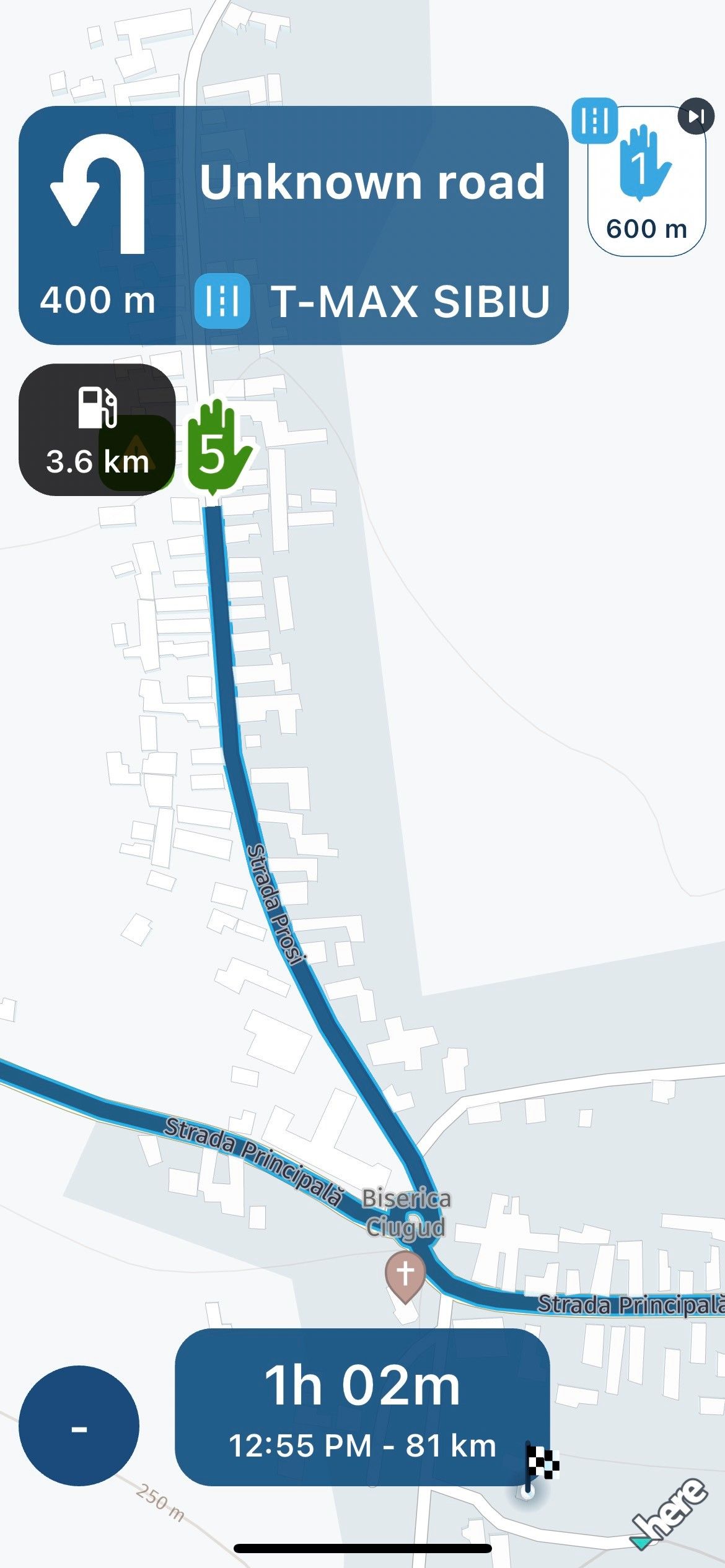

                    @Con-Hennekens and "show original route" is enabled ?
                    Just tried the same route from my iphone 13 with "show original route" enabled, and works without the grey line. So the problem is on my S24 Ultra with Android ....
                    Also "route-as-track" is disabled on both phones ...

                      @Adrian-Avram said in Grey lines on the route:
                      That's good to know, I have an Android too and have the original route mismatch with the blue line when I (navigate offline) and (route as track) off.
                      Hopefully @Corjan-Meijerink can fix this glitch. It's very useful having the (original route) visible.
